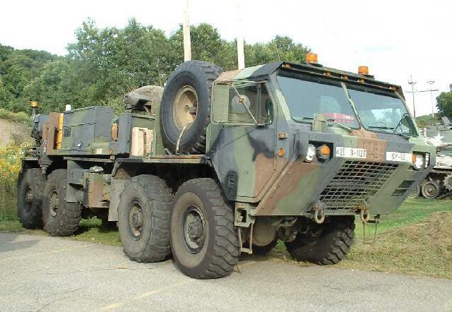

    I'm going to leave this here and wait for the oooooooooooooh.
    Also the 4runner and Offroad Taco share brake booster styles, so the brakes feel much firmer thanks to the electronic booster. You want the best feel, get the Offroad. Otherwise I personally don't find any issues with the tacoma, especially now that we have the ECT button and proper shifter for down shifts.
