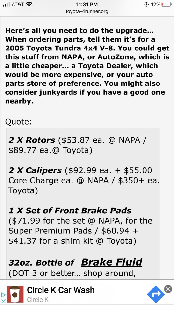

    A5AE3FE9-2016-4466-8F70-CA5AB1B83B31.jpg Is this all I need for the tundra brake upgrade ?

    In the Tundra to Tacoma brake threads I have stumbled across. There is a brake line conversion. YMMV :notsure:

    If you're just looking for parts, here's what I'd recommend:
    • Toyota Tundra OEM rotors (L/R: 43512-0C011)
    • 2 Remanufactured Tundra 13WL calipers from Napa (L: CAL SE3263) (R: CAL SE3264)
      Note: ONLY use these specific Total Eclipse brand caliper part numbers from Napa if you are planning to use banjo bolts to connect brake lines to the calipers. As of August 2019, not all Napa stores stock these calipers anymore, and the calipers that Napa stocks no longer work with banjo bolts.
      NOTE 2: If you are using the Tacoma-to-Tundra Hard Line Upgrade Kit, you can go with any 13WL caliper, not just the part numbers above.
    • 1 set of Toyota Tundra OEM brake pads (L/R: 04465-35290)
    • 1 set of Toyota Tundra OEM brake pad shims (L/R: 04945-35120, or 04945-0c030)
    • 1 Tacoma-to-Tundra Hard Brake Line Upgrade Kit
    • Some DOT4 brake fluid, and 3M brake cleaner
    There are a couple ways to go with this upgrade - you can do aftermarket parts, but IMO you get better (braking) results by going with OEM (or OEM reman) components (above). You can read about my experience in the links below...
