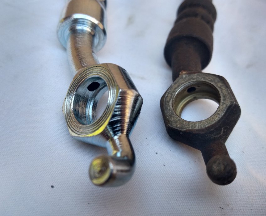

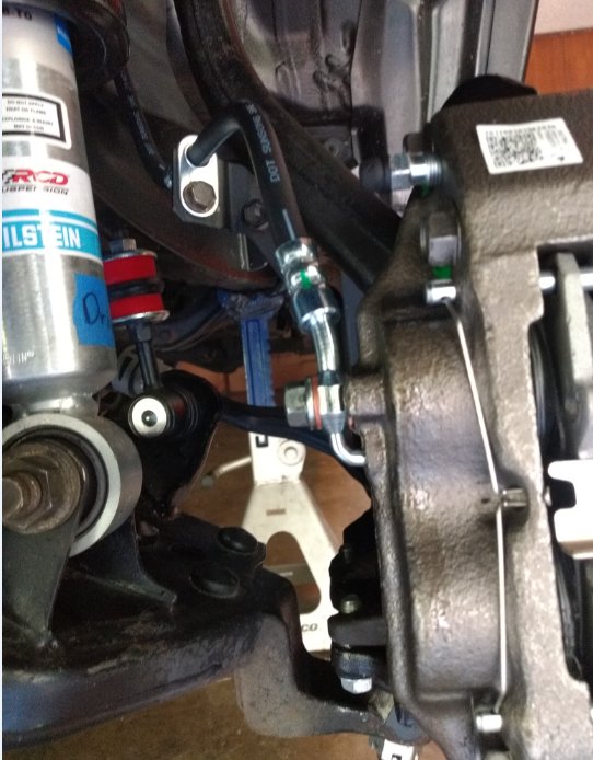

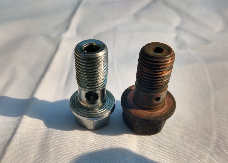

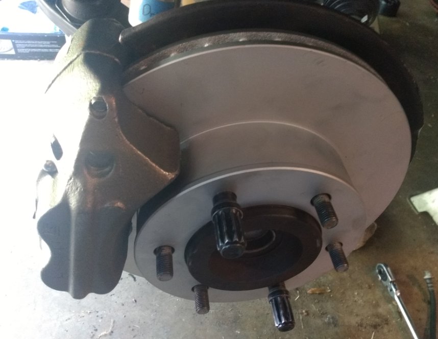

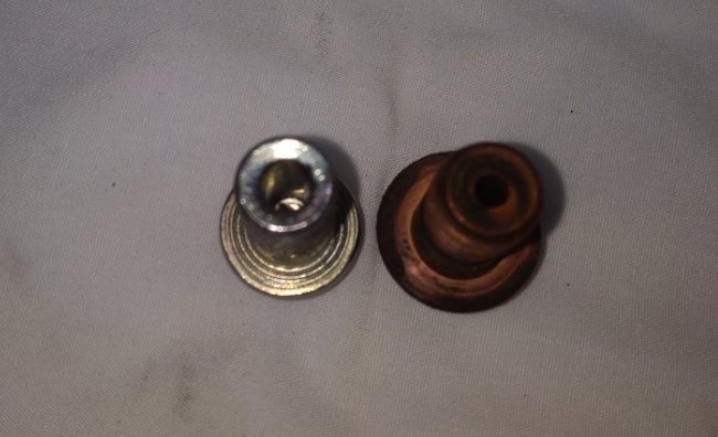

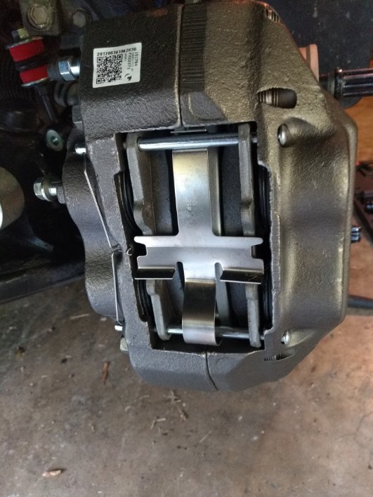

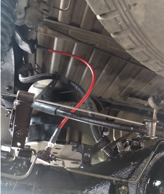

    Here's some pictures of some ordinary parts from O'Reilly Auto with a rear stainless line from Wheelers. I suspect the most improvement came from O'Reilly Auto Supply's rebuilt calipers using a larger size banjo bolt.
    O'Reilly caliper banjo bolt compared to the original.
    O'Reilly Brake Line Compared to original.
    Wheeler's extended line for the rear.
    O"Reilly rebuilt calipers with Wagner Thermo Quiet Pads. Right now I have six cars, I'm running Wagners on five out of six. If I cannot get Wagners for a given car, then I run Akebono Pro Act.
    Bosch Quiet Cast rotors have a special coating to prevent rust.
