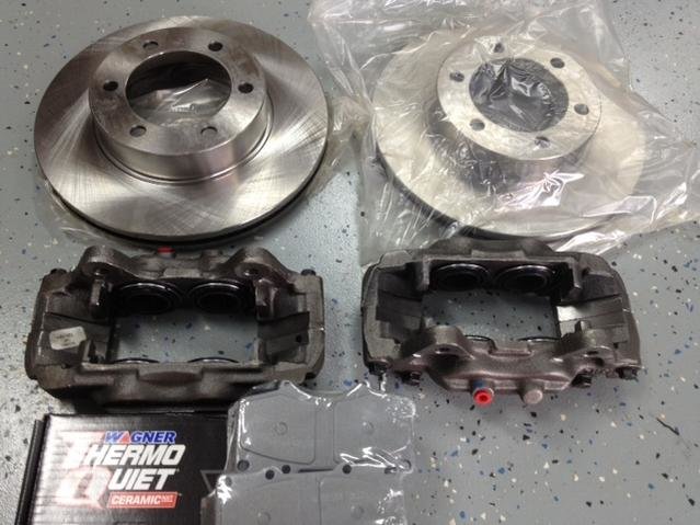

    Today I received the calipers via UPS. I think I will take one wheel off tomorrow and install the rotor and caliper sans the pads to check clearance of everything before I apply paint to the caliper. I have the stock 5-spoke direction 16" wheels (the ugliest wheel ever put on a Tacoma :facepalm:) and they should clear.

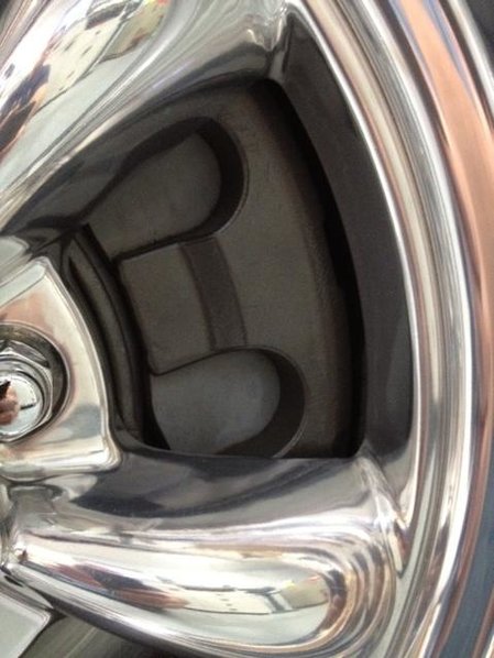

    Here is a photo of the caliper and rotor on the old Camaro. The Camaro caliper is powder coated but I don't feel like disassembling the Tacoma caliper to powder coat it. For my everyday driver truck paint will have to suffice.

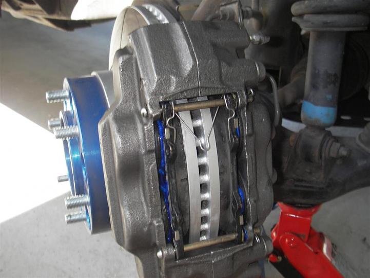

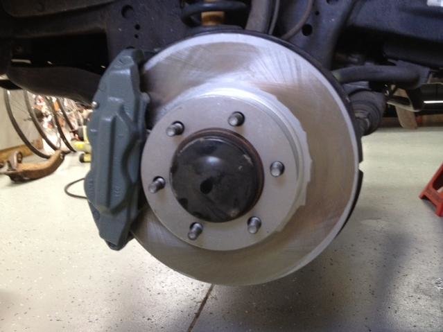

    Two, no three, no four questions:
    1- How do I install this "W" shaped spring thing? Edit: I found a photo on line
    2- Does the pad with the "Cricket" tab go on the inside or outside of the rotor?
    3- Do I need any backing plate or anything between the pistons and back of pads?
    4- Do I need any brake grease on the pins or where the pistons contact the back of the pads?
    Thanks guys!
    I must say that I am impressed with this upgrade. The rotor is ~ 7/8" larger diameter and ~ .220" thicker than stock. Add to that the larger pad area and the results have to be better braking. I will finish up this afternoon and can't wait for the test drive.

    1. You found it already, but in case anyone else needs it. I think this is what you were referring too.
    83450d1280435330-tundra-brake-upgrade-ra_ea98dd285602fc00da934dee144ba88207fee34e.jpg
    2. I'm not sure what this refers too, but usually if it fits fine, you'll be ok.
    3. If the pads you bought didn't come with any plates then you're good to go. This varies from manufacturers.
    4. Lubrication on the piston to pad contact can help to minimize potential brake squealing issues. I've never add them to the pins from my experience.
