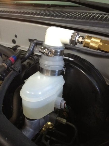

    Okay, I got er' done. This afternoon I clamped the M/C gizmo on top of the master cylinder, connected the air line set at 15 PSI, and commenced to bleeding. I bled the front passenger side, then the driver's side, then moved to the rear axle for the 5th bleed site.
    The rear drums were bled using the same procedure yesterday and with pressure applied I don't think any air could have sucked into the slave cylinders.
    I went out to set the brakes with the routine of repetitive accelerations and quick slow downs and now the brakes feel really good. Thanks to you all for your assistance!
    Below is a photo of the M/C gizmo that allowed me to apply 15 PSI to the M/C.

    You make that gizmo ? If so are those plumbing supplies ? Looks handy.

    The gizmo thing is made from plumbing supplies from Lowes. About $6 considering I already had the air line fitting.

    Personally I never really liked the applied pressure gizmos on the MC. I'm old school and do the famed 2 person bleed tactic. One person pumps and holds (generally someone of very little skill....I've got my 8 year old doing it for me now) while the other opens the bleed screws (me).

    I don't care for the applied pressure either , in fairness I will admit to never using one as the wife now pumps since the daughter has left home . I may at some point in time make one to try .

    Also wondering if the applied pressure has some how worked air into MC and if it now needs to be bench bled ?

    Bench bleeding isn't necessary, it's just faster if there's air in the MC because you don't have to bleed it all the way through the lines.
