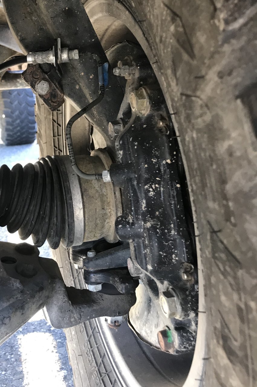

    Just throwing this out there original post and a few others show concern for drilling out the banjo and I get it.
    The best solution if you don’t want to go the banjo route is to use hardlines and extended brake lines with steering knuckle brake line mount bracket.
    NOTE: Gusseted steering knuckle/spindles will require modification to the mount bracket to get it to fit.
    Looks like most of the parts (not extended brake lines) can be sourced from 3rd gen 4runners, do your research to confirm.
    extended brake lines:
    https://www.lceperformance.com/Stainless-Brake-Lines-Tacoma-To-Tundra-Upgrade-3-p/1055142.htm
    Or you can check out @turbodb write up and Brake line package, I went this route.
    https://adventuretaco.com/store/tacoma-to-tundra-hard-brake-line-kit/

    Got this information from @Dusty T. a while back and it checks out. All of these Toyota parts are currently on my truck. Literally a bolt-on mod.
    "Part numbers as follows:
    Brake hoses:
    (1) 47314-35330
    (1) 47316-35250
    Brackets:
    (1) 47351-35270
    (1) 47352-35310
    Clips:
    (4) 90468-A0007
    These parts were less than $50 from my local dealer. If you have problems with those part numbers, these are brake hardlines and brackets for a 2002 4Runner.
    Conversely, you can order the same kit, plus brake hoses from LCE Performance. I mimicked their kit minus the hoses......
    http://www.lceperformance.com/Stainless-Brake-Line-Kit-Tacom-To-Tundra-Upgrade-p/1055114.htm
    Cheers!"
