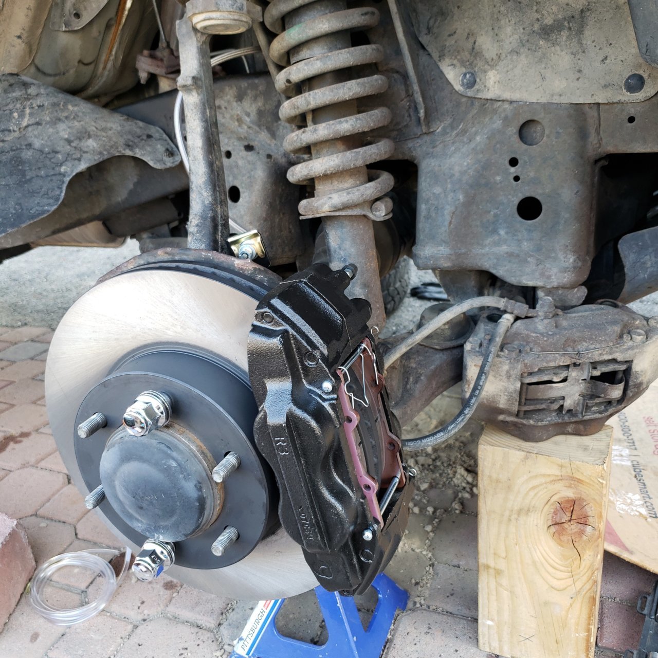

    Well I finished my 13WL upgrade today. Took me a couple hours. The hardest parts were taking the clips off the soft line on the frame, and putting the bronze clip on the caliper hardline on the spindle. Damn that bronze clip was a huuuuge pain. Everything else went smoothly.
    Thanks to AdventureTaco for the write up on his website that made the process super easy, also for the caliper hardware.
    Edit: I'm using stock "snowflake" wheels and they fit perfectly fine.

    The "Bronze" clips from Adventure Taco are way to "thick" due to their concavity on the "fingers". I used Toyota OEM ones that are "flat" and they slide in with plenty "grip". I tried to get the other ones in for about 20 seconds and I remembered I had purchased OEM ones. Got them started by hand then finished them off with gentle taps form a hammer. Now to get rid of the "Spongy" pedal.....

    After bleeding it a second time and driving a couple hundred miles, the brakes feel waaaaaay better than ever, definitely a sick upgrade. Pedal is not as spongy as the first bleeding, and nowhere near as spongy anymore as in the beginning of the second bleeding. A 3rd bleeding will probably be the last I'll need.

    Okay so I bled it the 3rd time, and the pedal is hard with no play. Literally no play, no more squish. Felt like I was braking in my Audi. Lol. 3rd time is the charm.
    I bled with someone in the truck pressing the pedal 5 times and holding it in the 5th time, I bled the rear valve first 3 times, then the pass rear 3 times, then driver rear 3 times, then pass front 3 times, then driver front 3 times. Did it 3 times each side all 3 times I've bled. Brakes are solid now
