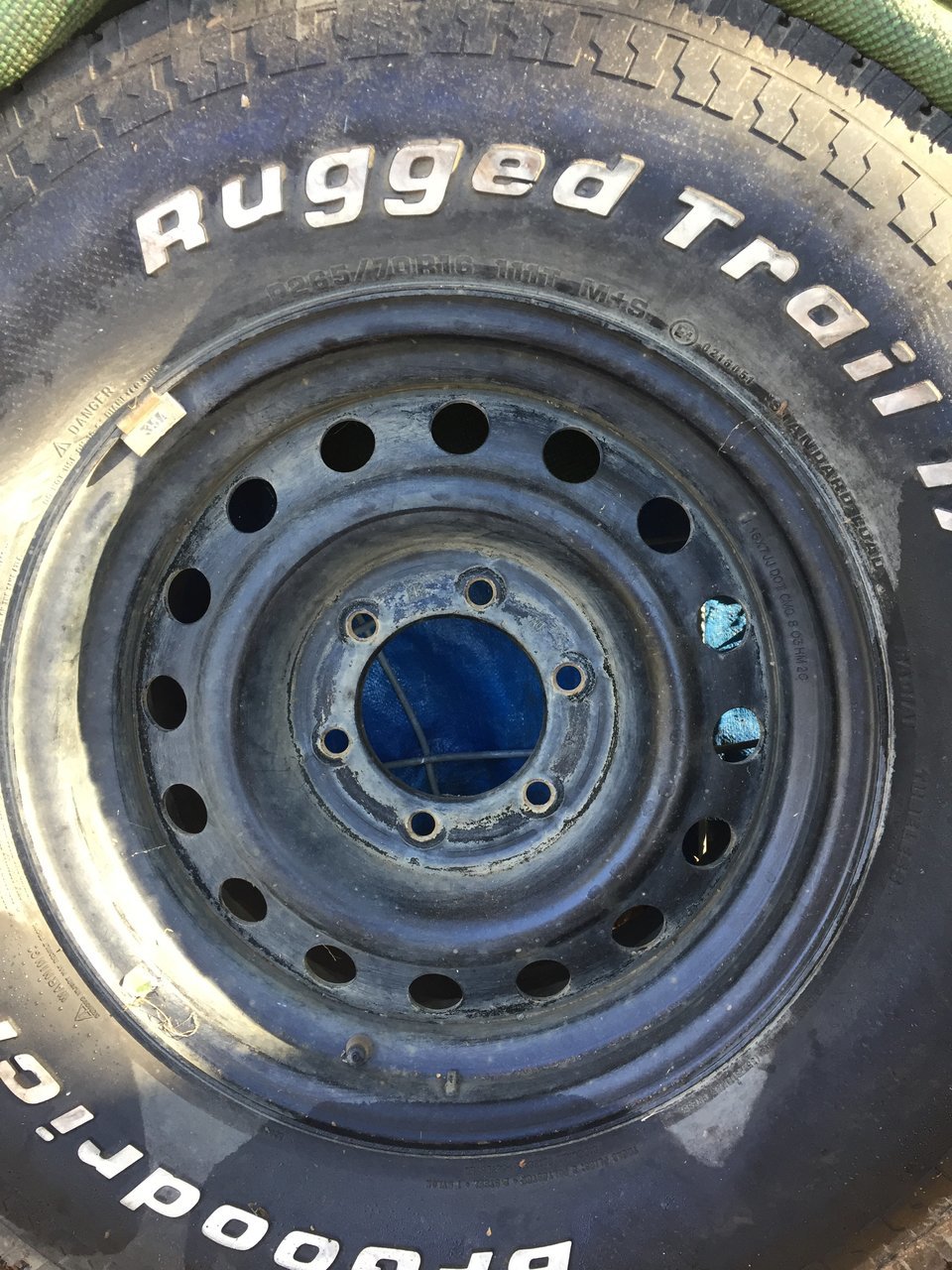

    Just a final follow-up here as I was taking care of re-forming (rather than cutting) and re-installing the fender liners today as part of the pinch weld mod and so had the wheels off.
    I have two different types of 16" steel spares - one type fits over the Tundra 13WL calipers, the other doesn't:
    Fits (first gen 01-04 16" spare):
    • label stamped in wheel: J 16X7 JJ DOT CMC 10 01 HM 31
    • backspacing: 4 3/4" strong (so 4 3/4+)
    • identifiable (for me) via all holes being round
    Doesn't fit (second gen 05+ 16" spare) (backspacing pushes the wheel too far in, interfering with the brakes and front suspension):
    • label stamped in wheel: J 16X7 JJ DOT CMC 9 10 WT 14
    • backspacing: 5 3/8"
    • identifiable (for me) via one oval hole near the valve stem

    that 2nd steel wheel is most likely from the 2nd Gen (most of their wheels are 5.25" BS). The first Gen Tundra and Tacoma had the same backspacing and uniform round holes for the spare wheel.

    I took a picture of my spare, since I have the 13WL's. And according to @turbodb I'm good with the fitment. But with an almost 14 year old tire, I'm not too sure.
    But at least I know!

    Did you measure the back spacing? Or just slap it on and dry run it?
  17. Nov 18, 2017 at 9:57 PM
    #17
    Sicyota04
    Sicyota04 Slowly but surely.
    Jan 9, 2015
    #145940
    3,561
    Morgan
    California
    04 DC 4x4
    It's actually sitting on the back 5 acres. I don't plan on ever using it. I just compared Post#10's two types of rims. The rims I have now are 16x8 Method double standards w/ 4.5" of BS. Those fit fine without any clearance issues. I just should've bought a 5th one. My tires are 265/75/16's while we all know the spare at least on my truck is a 265/70/16.
