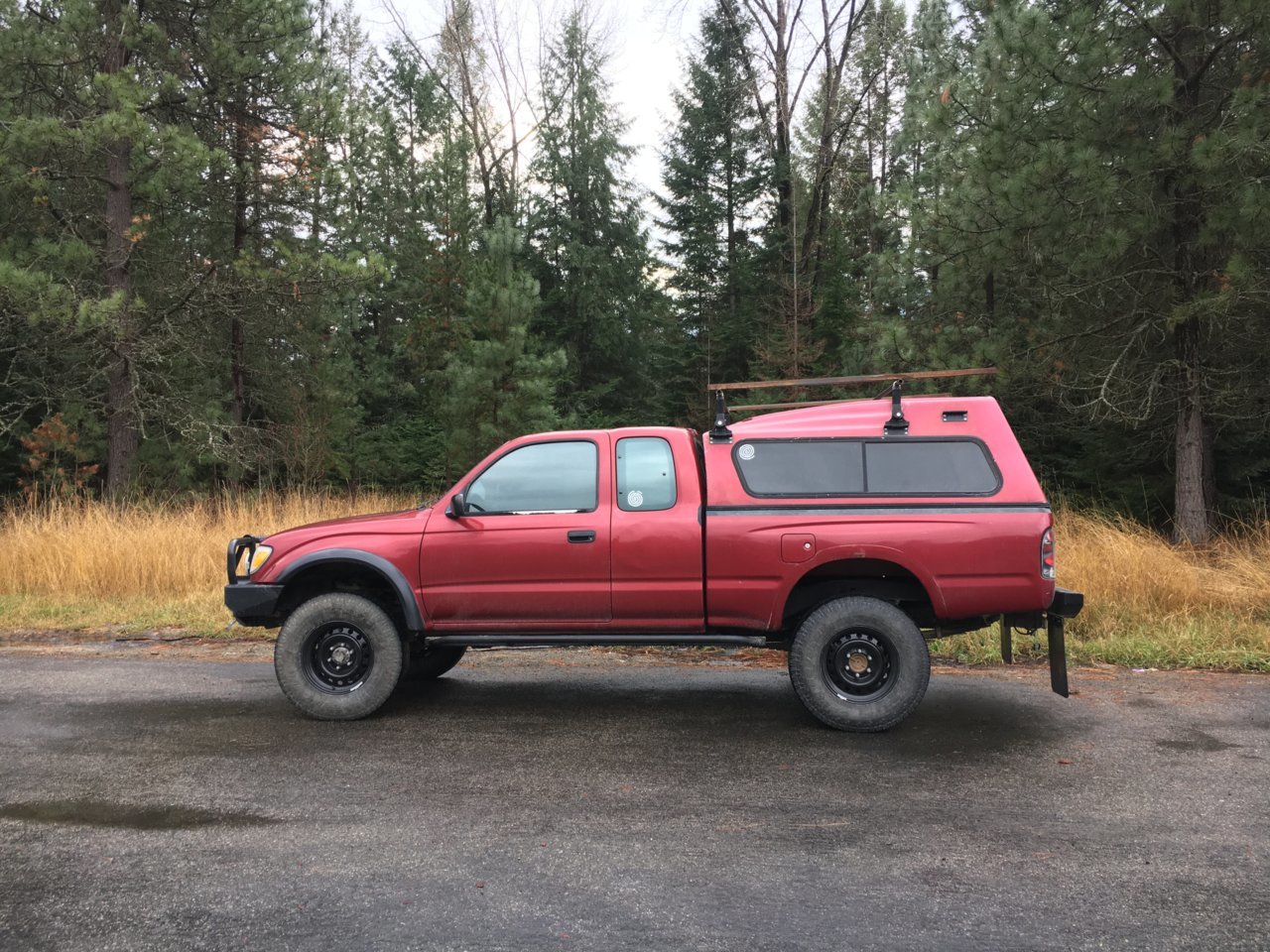

    Picked these up online, Reconditioned and painted, tested fit them. Got em mounted, they ride pretty sweet. I like the look.
    2003CD36-4ADB-4B2D-8F6B-DCD5A5C7520C.jpg Ta da!

    They only fit 16” spare rims that have all circle holes. Some 16” spare rims have circle holes and 1or 2 oval holes. Will not fit those.

    LOL, thanks. I asked that question 2 years ago when I was researching. You'll note that in this same thread - here - I posted the answer for everyone :). Essentially what you said, with photos.
    I've since moved on to 16" SCS Steath6's, and now to 16" 5-spoke 4Runner wheels.

    Correct, and thanks for finding that out. I test fit each of the rims to be certain and am very happy with the look and the ride.
    Although on a side note the number stamped in the rim isn’t a one and done, my wheels have 3 different number groups on them if my memory serves correctly.

    I picked up two of the wheels (16" spare with round holes only) today and can confirm that the number stamped on the wheels looks to be unique.
    The majority of the numbers/letters at the beginning of the sequence (j16x7jjdotcmc) are the same but the last two numbers and the couple numbers before HM seem to be different.
    Now to find two more wheels!
