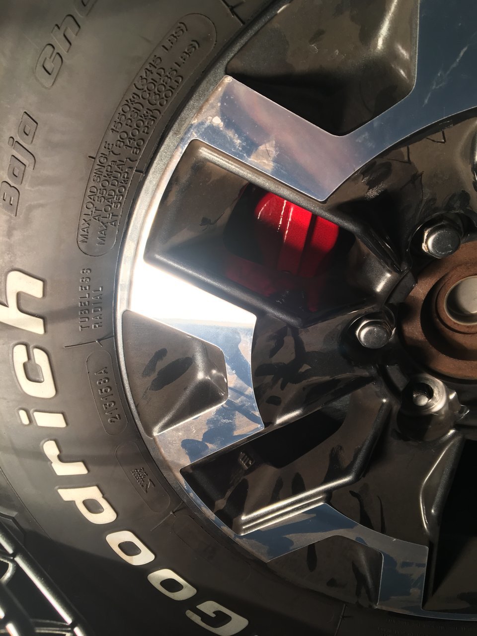

    Here's my Tundra setup under 2017 TRD Off Road 16" wheels. You will have to trim the dust shield a little to fit the larger calipers, otherwise it's all bolt on. I think you might have to drill out the stock banjo bolt if you're keeping the stock brake lines, otherwise I'd buy the aftermarket steel brake lines from LC Engineering or Wheelers off road.
    I have the LC Engineering brake lines because unlike the wheeler's kit, they send you the stock Tundra brake line setup which is a hard brake line with a flared end instead of a banjo fitting like the wheeler's Setup. Both are good kits but LCE's kit matches the stock Tundra lines.
    I have the same calipers and brake pads from the kit you linked, but upgraded Baer Sport Performance Rotors.

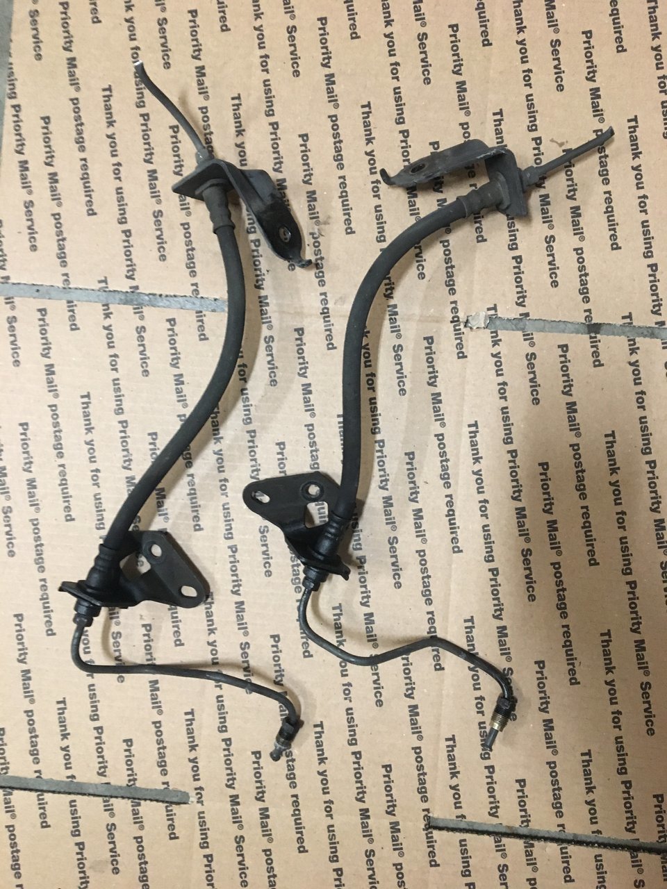

    Here how the stock Tundra brake lines look like: (note the hard brake lines)

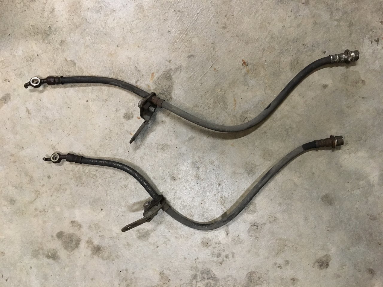

    And the stock Tacoma banjo bolt brake lines:
