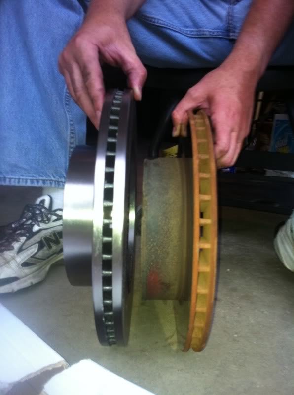

    ADS Racing Shocks 2.5" Extended Travel Coilovers with Reservoirs, 3 inch All Pro rear suspension kit, factory E-locker, Trail Gear sliders and front stinger bumper, CBI Offroad rear tube bumper, XRC8 Winch, 33 inch BFG KM2's, 16 inch Ivan Stewart Wheels, Uniden CB radio, flip up license plate, white tail lights, LED front signals, Tundra front brake upgrade, new radio, rock lights, sub woofer, remote start, satoshi grille with Prius emblem, Rigid DOT/SAE Fog Lights, 12" Light Bar
    ...bigger. That is a picture I took when I upgraded my tacoma stuff to tundra.

    bust out a cutoff wheel and clear enough room for tundra rotors? that an option?

    You don't need to cut anything. Just bend the dust shield back some.

    I had to do a little trimming of the backing plates to clear my 231's. I used a cutoff wheel as tacomataco2 mentioned. I also did this upgrade to my 4runner but on that i used the smaller 199 calipers, no trimming required with those.

    Well look at the photo I posted, I guess I could grind the spindle slightly but not a cut off wheel. I had to grind to fit the stock ones, I guess I just need to try and fit to see.
    Is the inner diameter different? If so maybe I have more room than I thought. I'm not worried about the wheels or dust shield just spindle
