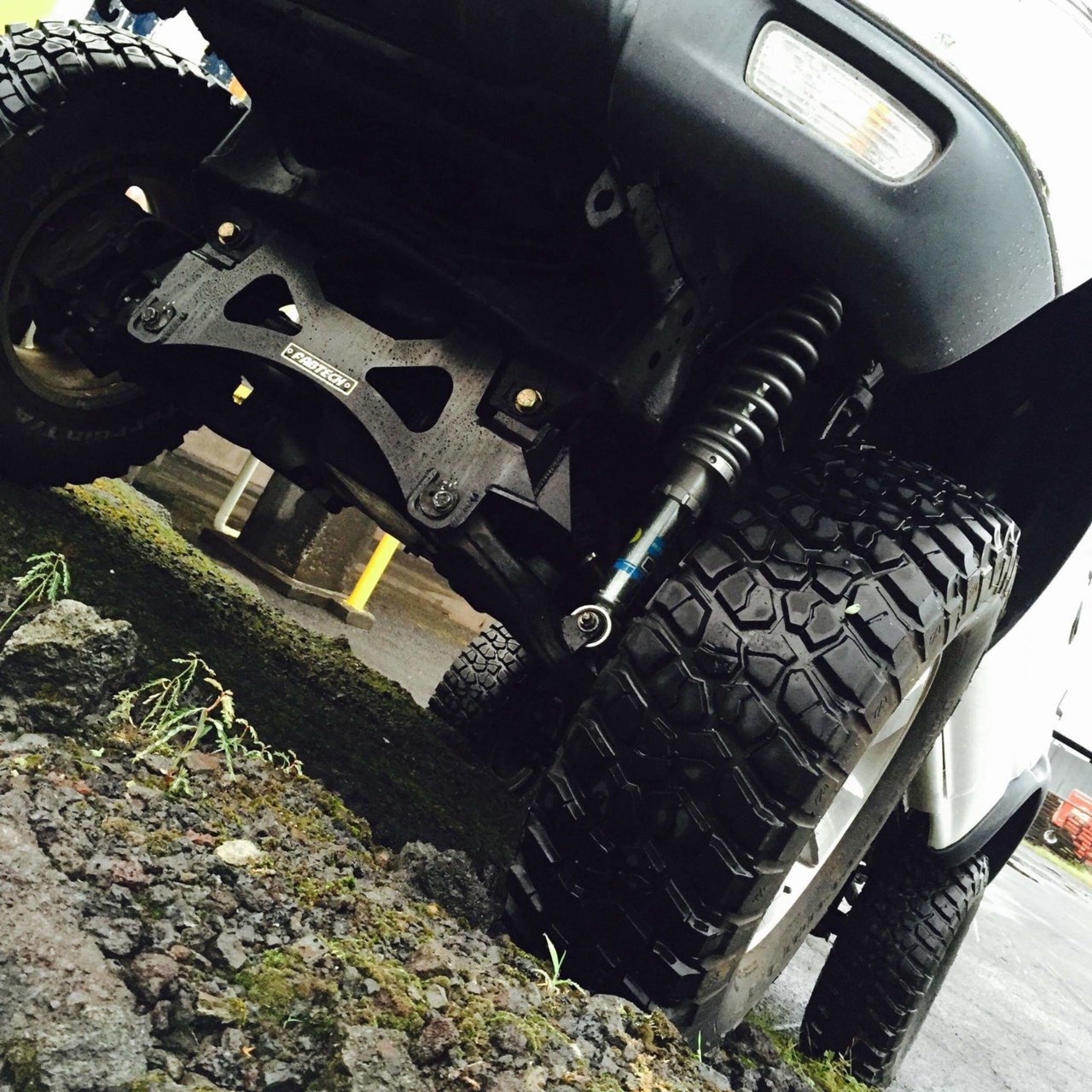

  13. Jul 9, 2020 at 3:39 PM
    #33
    iunek808
    iunek808 Well-Known Member
    Jun 9, 2014
    #131653
    155
    oahu
    04 tacoma dblcab prerunner 4x4
    Tundra 5100's w/Fj springs Deaver leafs 4x4 conversion w/manual hubs Jshift
    Bilsteins make a coilover for the 6in lift
    Taco critter and BeastyDirtSlut like this.
