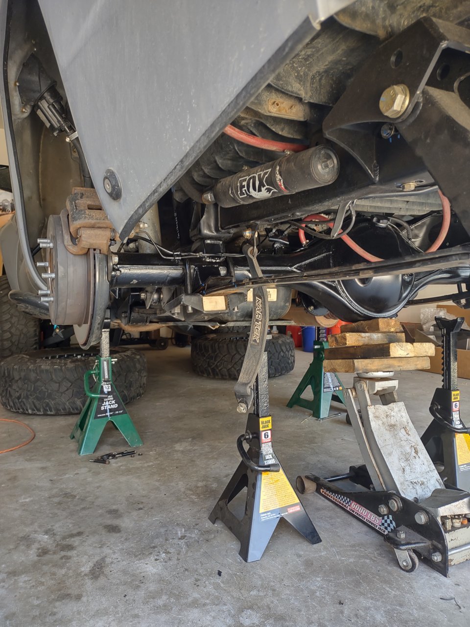

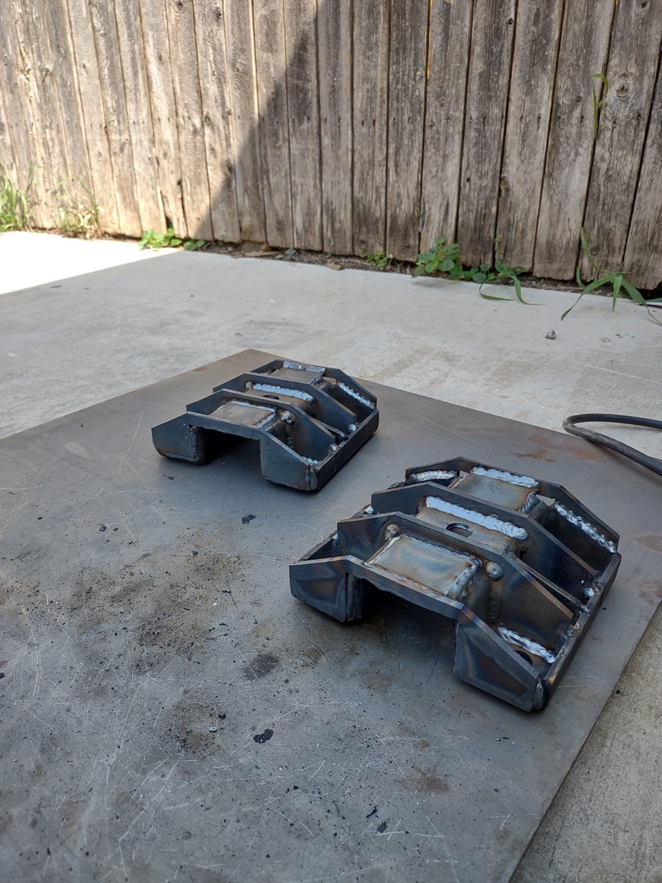

    Forgot to post full bump. Tundra axle is close to the bed but should be fine. I had to remove the ABS wiring extension from the top of the axle to clear. I also had to beef up the lower spring retainer plates.

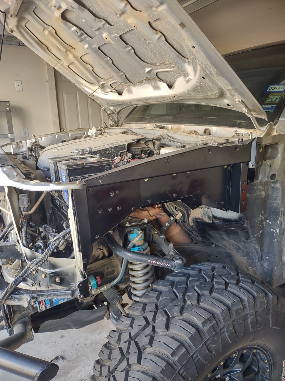

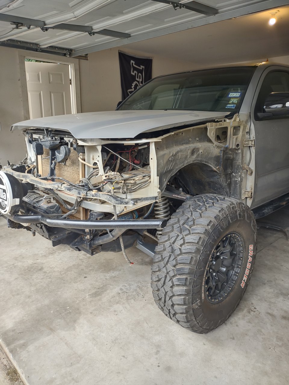

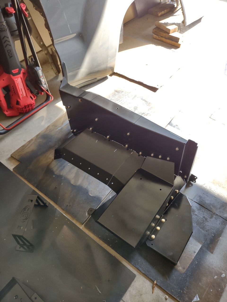

    Work started on the inner fenders today; started tearing everything down. No cutting yet but assembled one side. We'll see how it goes tomorrow. I haven't seen anyone do this with a manual truck yet so I'll see how everything ends up being situated on the driver side...which I believe the only difference is the clutch slave cylinder reservoir.

    Going to be much easier to install in sections. I did the same and assembled a lot of it. Only to tear it all apart.

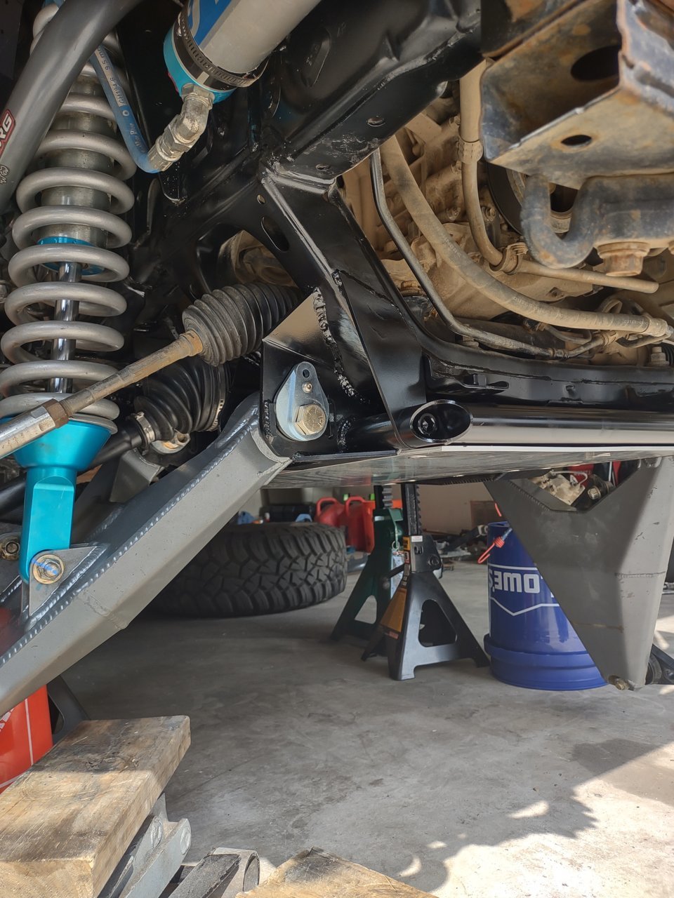

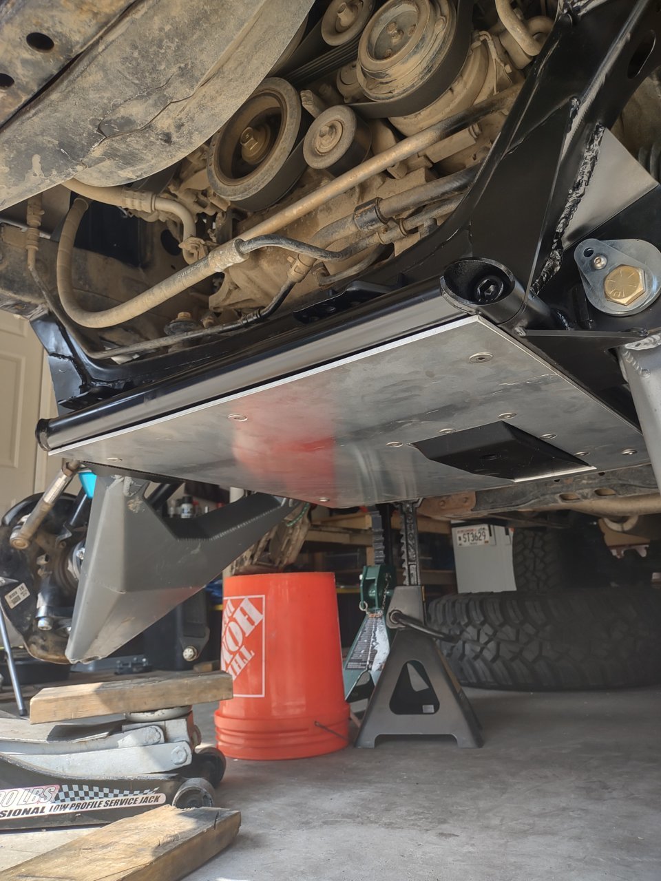

    You'll just have to take my word for it that both sides are complete. Overall, the install wasnt terrible. Obviously the passenger side went smoother with doing the driver side first. Tear down starts tomorrow so I can cut of the factory lower control arm mounts.

    Not sure. Wasn't keeping track haha. The weekend I had spent the most of each day working on it. During the week, maybe an hour or so each day after work.
    I'll let you know. Im honestly not looking forward to it haha...just the cutting and grinding aspect

    San Antonio, TX
