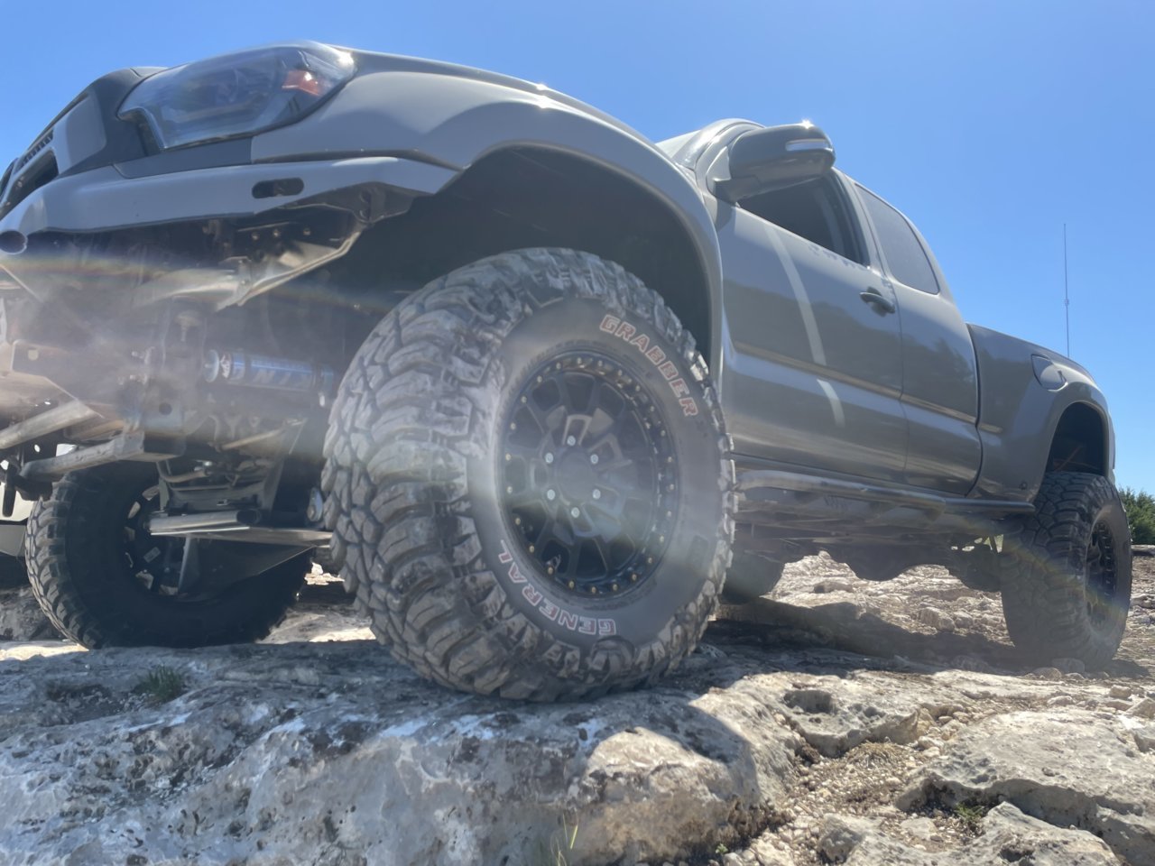

  8. Jun 12, 2022 at 6:15 AM
    #328
    Adventure4x4
    Adventure4x4 [OP] Well-Known Member
    Feb 12, 2016
    #177931
    1,377
    Adam
    San Antonio, TX
    2013 TRD off road MT
  9. Jun 12, 2022 at 12:12 PM
    #329
    T.Barn
    T.Barn Well-Known Member
    Sep 1, 2020
    #339422
    695
    Todd
    Hampton Roads, Virginia
    2010 AC 4x4 6MT
    Truck looks sick. I’ve been putting off doing the front locker because of all the places ATRAC has gotten me. There’s those times though when a locker would be nice. It really is surprising though how well the ATRAC works.
    Adventure4x4[OP] likes this.

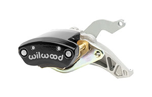

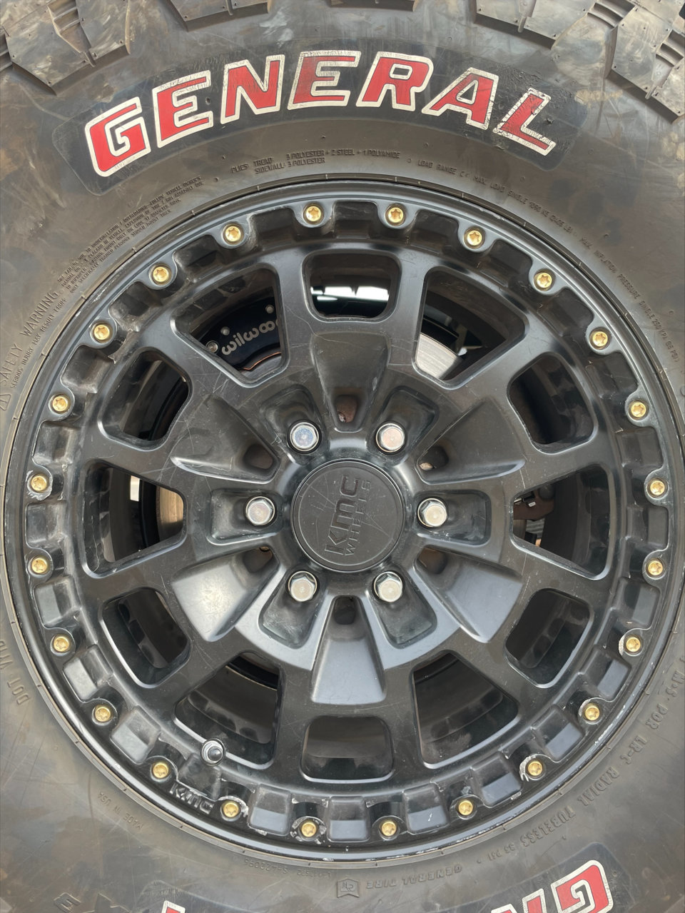

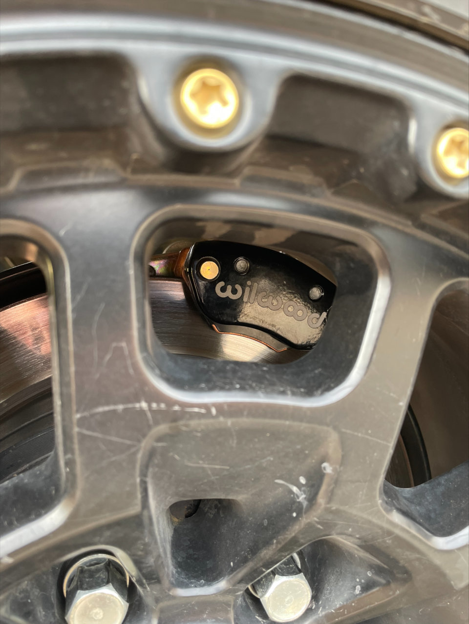

    Short little update to the truck...for the life of me i couldn't get the tundra ebrake to actuate properly at the rotor while retaining the factory Tacoma cable. I
    decided to try an alternative route. Wildwood makes a caliper mounted cable actuated ebrake. I was a little skeptical about the size and know it's not necessarily designed for the size of my vehicle but for the price, i figured i give it a shot. They actually make an electric one as well but definitely unnecessary for my application. There's two open bolt holes on that back of the backing plate that worked perfectly for the mount. I trimmed away part of the dust shield. I ended up buying the wildwood universal cable kit and was able to eliminate the factor cable. I only have a couple of pics of it mounted. I always forget to take pictures haha. We'll see how it works over time.

    park on a hill, put it in neutral and put the ebrake on. If it holds, then you know.

    Yeah it holds fine on a hill but not sure as she gets heavier in the future. I like @Sociopenguin 's idea better though haha.
