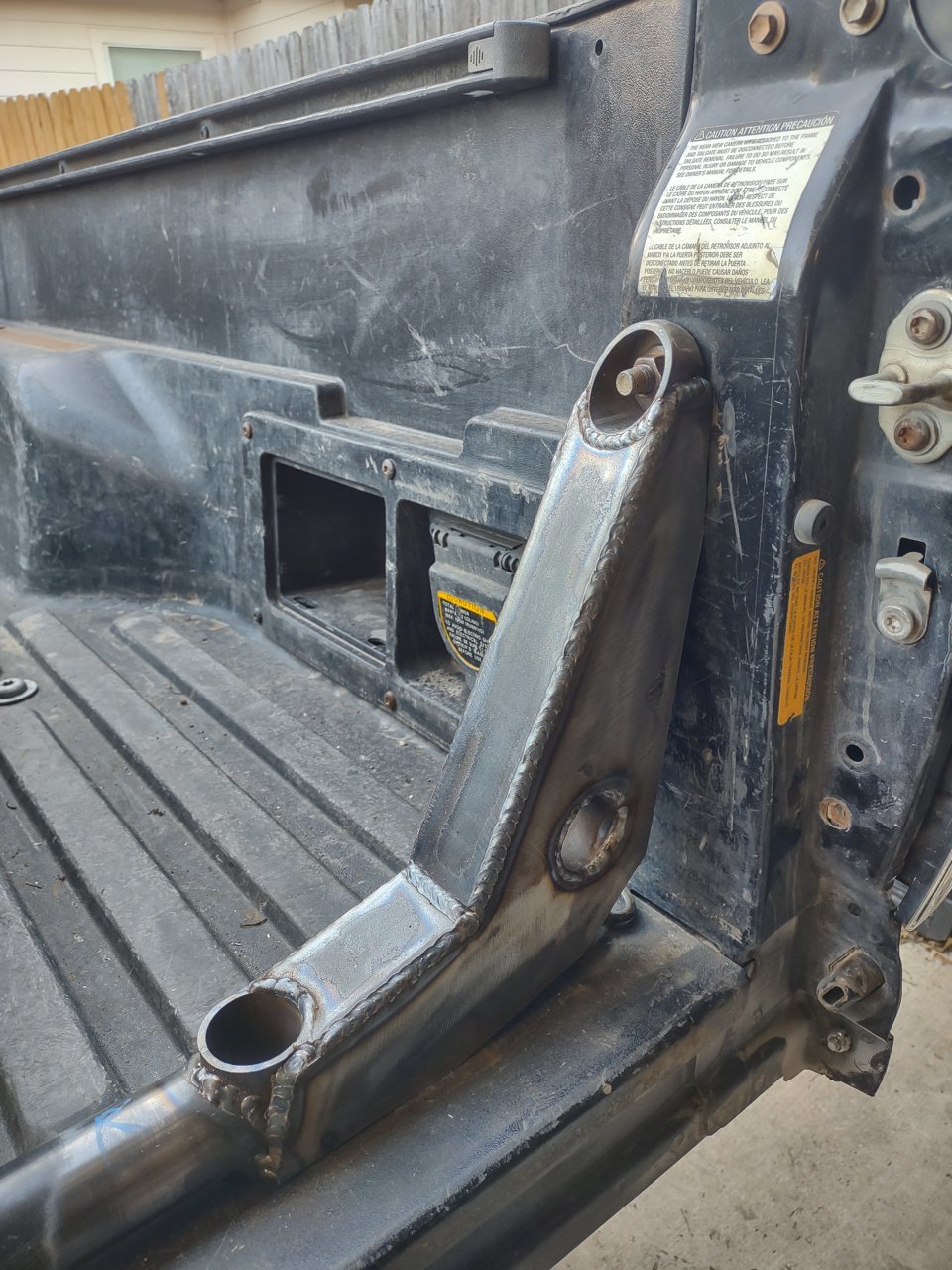

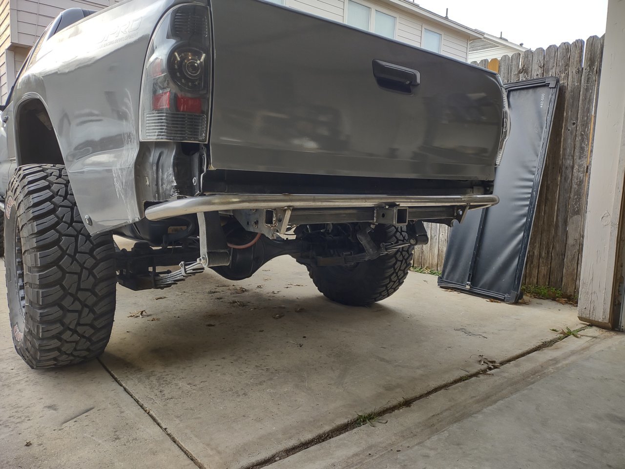

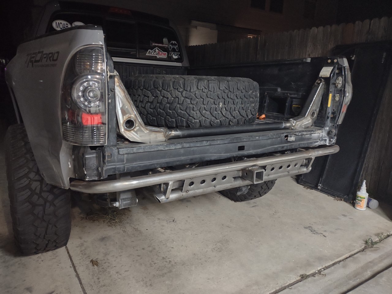

    I know it doesn't serve too much more of a purpose besides mounting lights but it was good practice for when i decide to cage the truck one day. Happy how it turned out and breadth of experience keeps on growin'. And disregard the ugly fence; it's a rental haha.

    Damn I need to buy a welder...

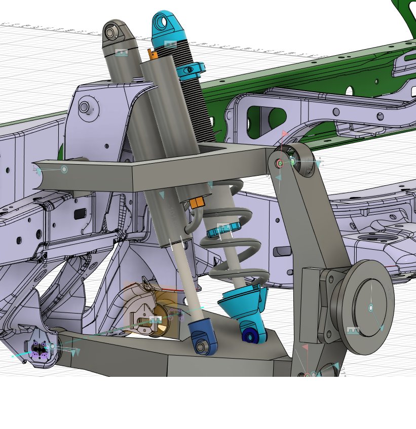

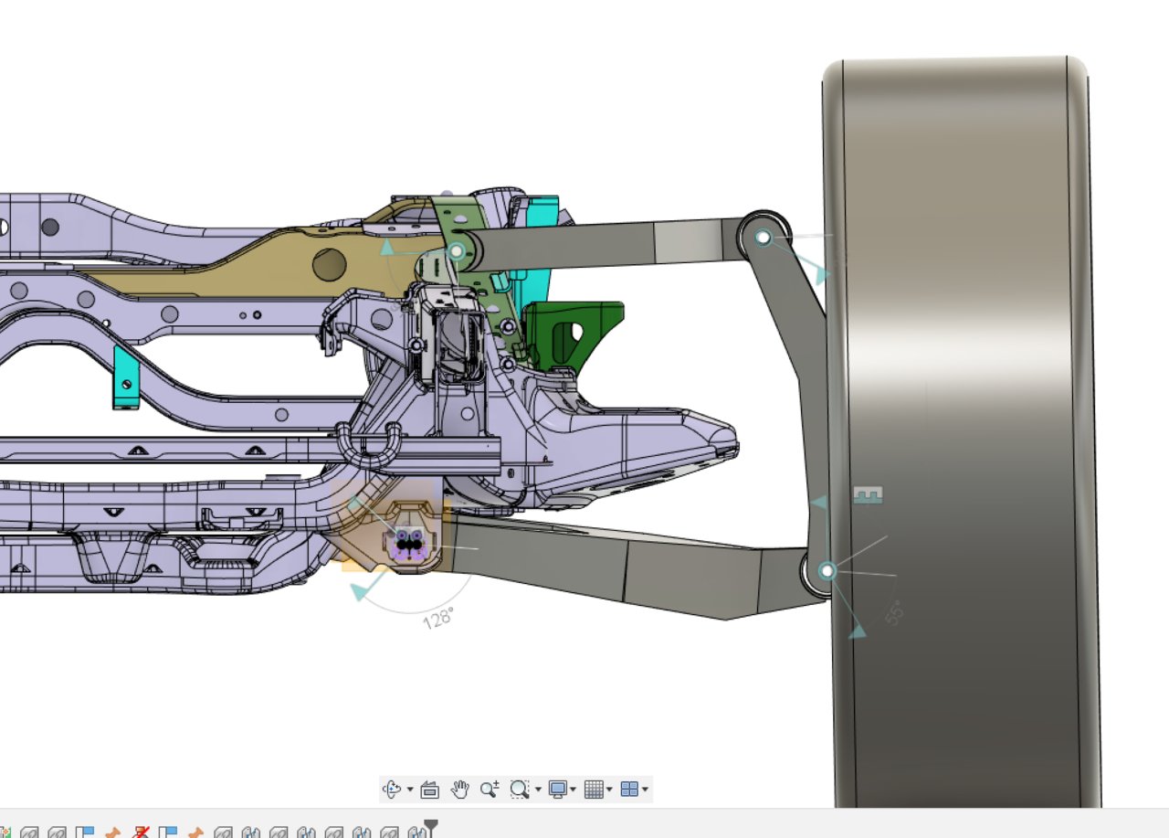

    Toying with the idea of a custom LT setup. Since I have the tundra axle, I could swap back over to the tundra bolt pattern and run tundra wheel bearings up front. I would have to swap out the brake booster, but I could run the tundra brakes as well. CV axles would be have to be custom but should be doable. If I so choose, ABS is possible. Open to any input. Obviously below is just a rough layout based on certain dynamic parameters I wanted.

  10. Jul 10, 2023 at 10:38 PM

    Would that be more or less expensive than just going with a kit?

    The custom axle shafts will likely be the most expensive part. Disregarding the CVs, it will be less but not by much considering the trial and error that will occur. Also, I'll need tundra brake components. There are aspects of kits that I like, but there isn't one kit that satisfies all of those, so I figured why not. Its something I've always wanted to do when I was in school.
    ...and I would be selling my current kit.

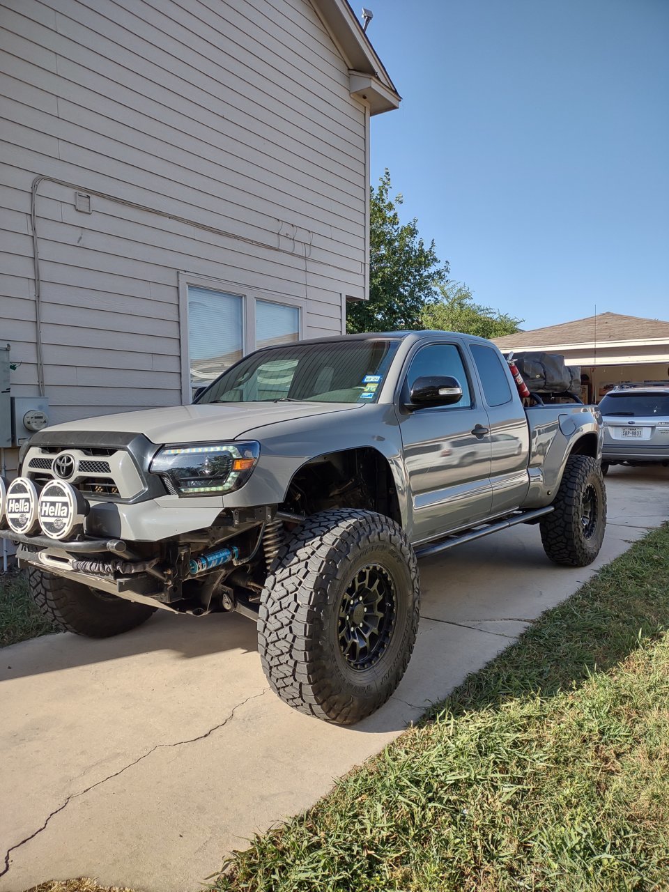

    truck looks sick man but whats up with your front fenders? did you cut them?

    Hey thanks. Yeah I ended up swapping the factory fenders back on and cutting them. I've never been super happy with the fit of the glass, so just decided to switch back. I'm kind of digging the change right now.

    ah i gotcha i was wonderin since it use to have glass and it was super wide. thats a bummer on the glass fitment thou it always looks so cool!
    how much did you cut? it looks like you have a tiny little fender now

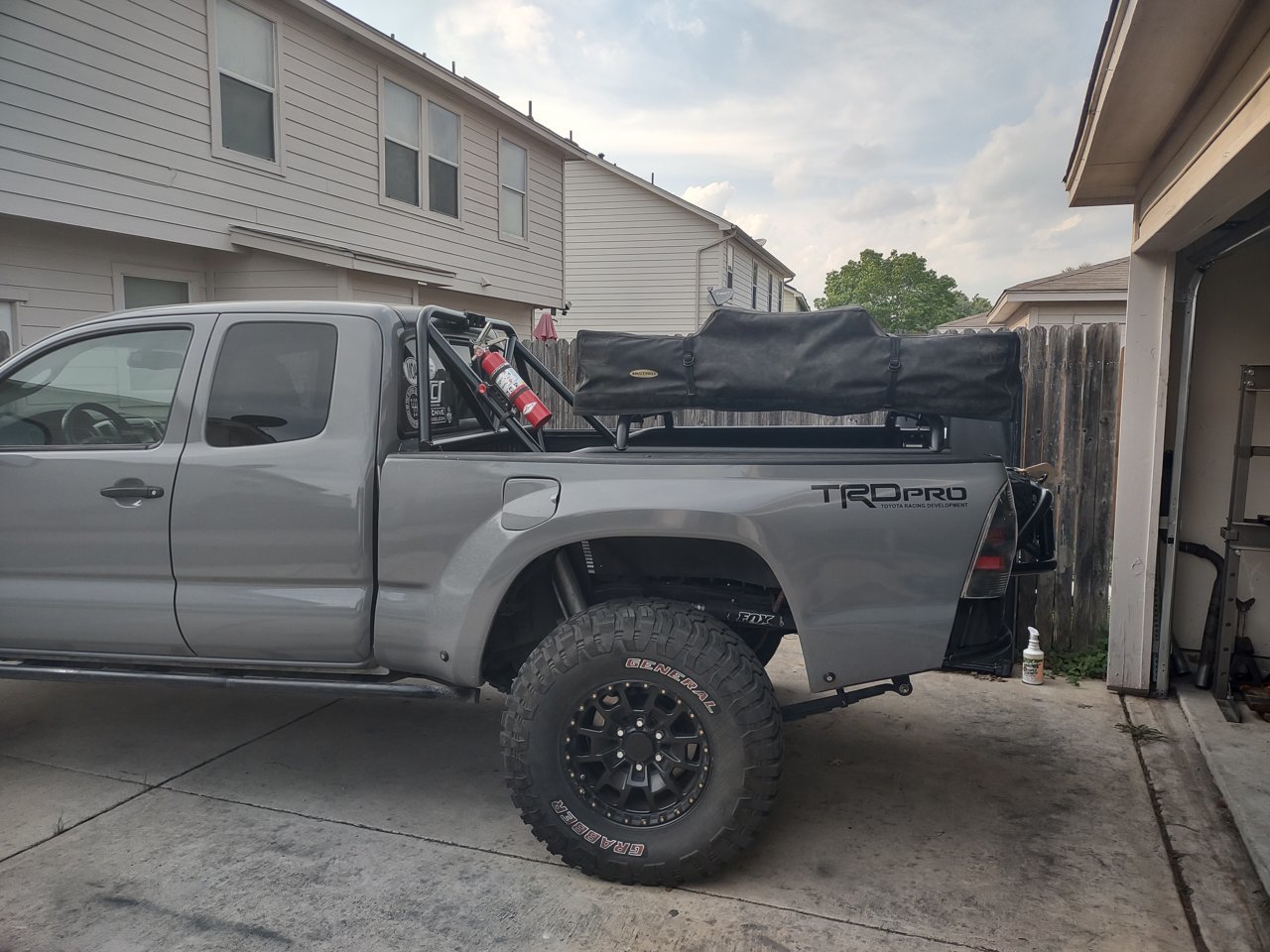

    I cut quite a bit haha. Maybe around 4" around. It still looks wide from straight on, but yeah from the side not so much. I still have the rear glass.

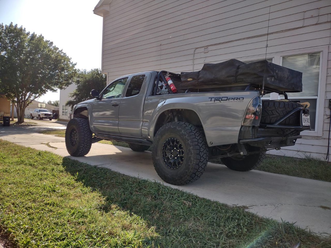

    oh dang haha thats a lot cut! you got any straight on pics? and ya i noticed the rear

    This is the closest I've got. I'll have to grab a pic
