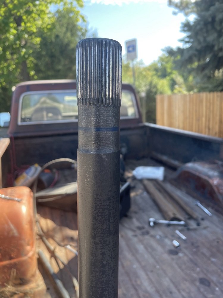

    Found your thread searching on mods for the 10.5" tundra axle. Rad Taco you have built!
    I am curious if you have discussed shortening the factory axles with any of the common players? After the neck down past the factory splines, it seems you could re-spline the factory shafts as the OD of the shaft returns to the proper diameter after the neck down. I'm building the 10.5 for my trail rig, and 72" WMS is just waaaay too wide for what I want. I've got inquirys out to Moser, Branik, and Quick, but have yet to hear back. I do know Branik has the ability to cut the 36 spline pattern onto blanks for custom shafts, just unsure if they are able to do it on the factory shafts. I could go full floater a number of different ways and get custom FF shafts made, but I'd really like to keep this thing CHEAP. Probably should have just bought a 14b....
    Thanks for sharing all the info you have on this build, look forward to hearing any input you have on axle shafts.
    Evan

    Hey man, thanks. I appreciate it.
    Although I have differing widths front and rear, I prefer to leave it the width that it's at for stability and ease of clearing the shocks. I always have adjustability using wheel backspacing.
    Regarding re-splining the axle shafts, you could reach out to diamond axle. They do various custom setups. The land cruiser 9.5 is always a good option as well.

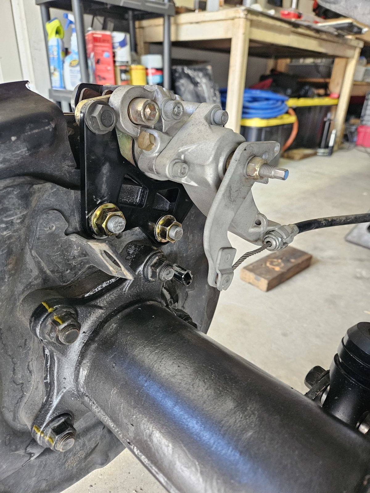

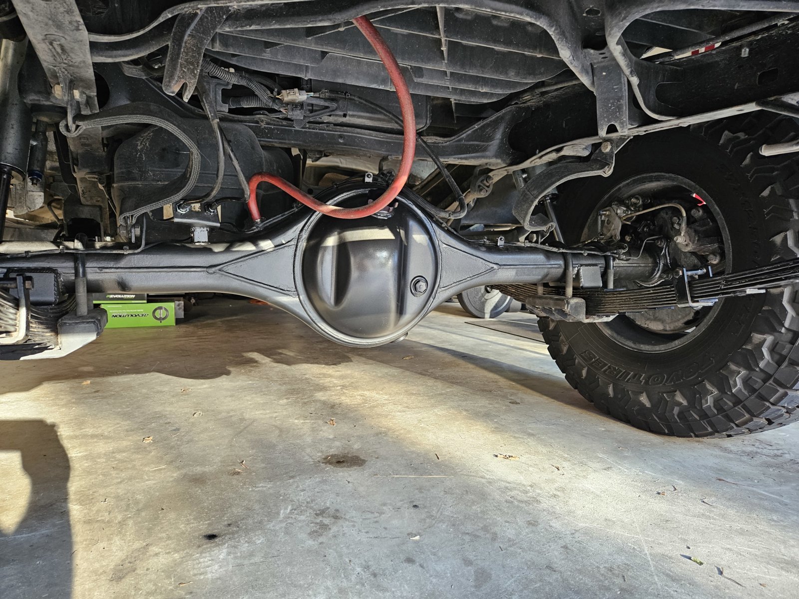

  4. Nov 6, 2023 at 10:22 AM
    #384
    Adventure4x4
    Adventure4x4 [OP] Well-Known Member
    Feb 12, 2016
    #177931
    1,378
    Adam
    San Antonio, TX
    2013 TRD off road MT
    Finally installed the locker after a 4 week lead time for it to ship out...ugh. Cleaned up the axle and decided to switch it up in terms of color but probably will end up black again. Looks good for now. Also, drew up the mount for the wilwood ebrake and had it laser cut and powder coated. Now on to the front regear

    excuse me sir where is your exhaust lol

    It's hidden behind the axle haha. It's there dumped ;)
