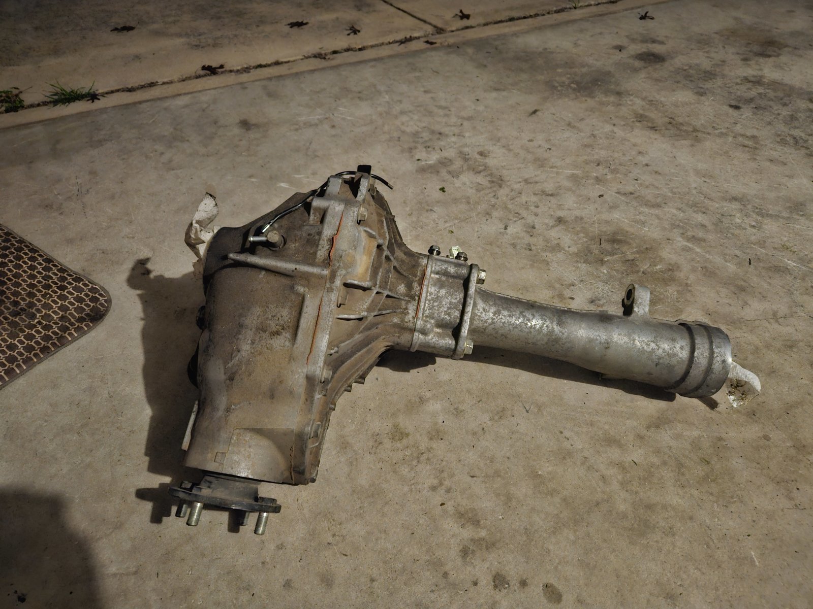

    2024 started off well...found a great deal on a tundra front diff to do some testing

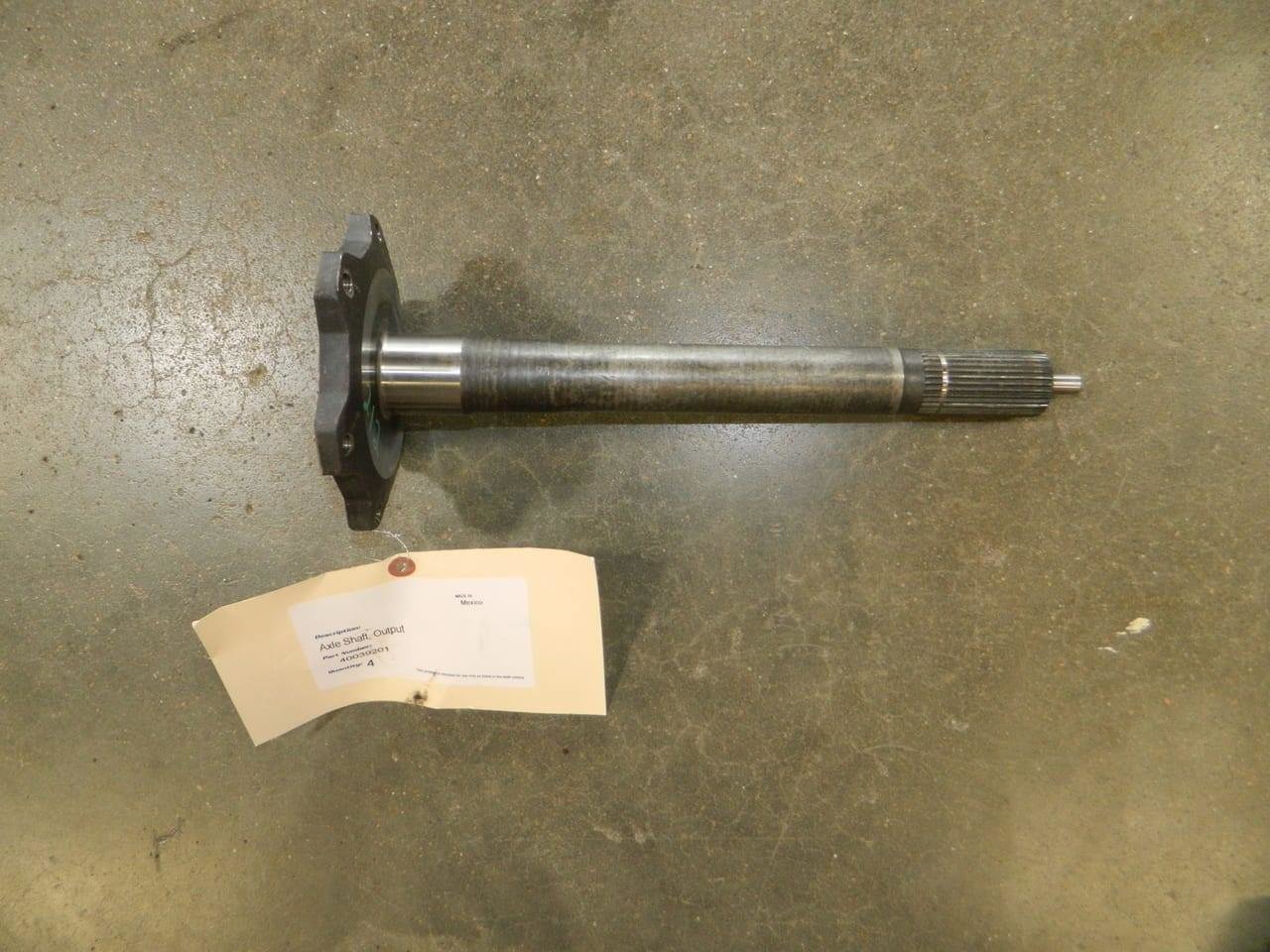

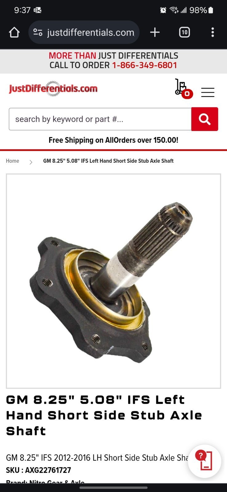

  11. Jan 8, 2024 at 5:53 AM
    #431
    Adventure4x4
    Adventure4x4 [OP] Well-Known Member
    Feb 12, 2016
    #177931
    1,378
    Adam
    San Antonio, TX
    2013 TRD off road MT
    I'm trying to post more as I'm working through this. I know there are options out there I'm not considering...I'm going to have to tackle the front suspension overhaul first, but I've been thinking about how I'm going to make the tundra front diff work. I took it apart this past weekend to see if there were any internal surprises. I've never had the Tacoma ADD apart, but I'm sure its identical to the tundra. The extension to the differential casing should be straightforward to manufacture, but the shaft itself might be difficult in the sense of finding someone that would do it. Based on the research I have done, RCV might be willing to help out. The input into the diff should be a guarantee since they already offer CV axles for the tundra; it’s the receiving end for the CV that I would imagine being a challenge. One thought I had was converting over to a flange style like the GM 8.25. My immediate thought was then "how about the driver side? I would have two different style CV axles." I could convert both sides to a flange style to eliminate this issue. A downside would be that the CVs would be custom, but on the flipside, I believe they warranty up to a 40? Im sure my diff would fail before the CV would.
    Pictures are for reference

  13. Jan 9, 2024 at 9:37 AM
    #433
    Wishbone Runner
    Wishbone Runner Because 4R
    Sep 9, 2012
    #86546
    6,340
    James
    CO
    04 SR5 4Runner
    King/Dirt King
    Hos does it look size wise fitting in the stock location? Does it look like the crossmember will need to be moved/modified to mount it and or fit?

  15. Jan 9, 2024 at 11:03 AM
    #435
    Adventure4x4
    Feb 12, 2016
    #177931
    1,378
    Adam
    San Antonio, TX
    I'll update when I find out more. I haven't held it up yet into place to see. It is looking like tha rear most crossmember will need modified.

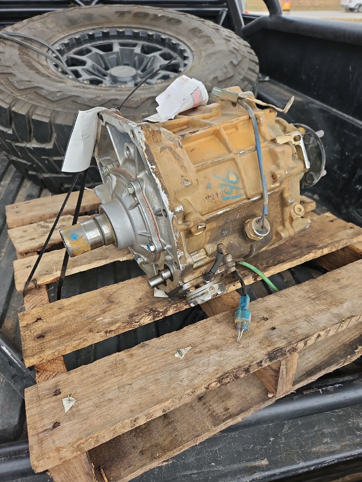

  18. Jan 27, 2024 at 7:42 AM
    #438
    Adventure4x4
    Feb 12, 2016
    #177931
    1,378
    Adam
    San Antonio, TX
    Just collecting parts at this point. Needs a shifter but another good deal.

  19. Jan 27, 2024 at 8:03 AM
    #439
    Camazon
    Camazon Well-Known Member
    Apr 28, 2020
    #326185
    217
    Cam
    Vancouver,BC
    06 Tacoma TRD Off Road DCSB
    FJ case?
    Slashaar likes this.
  20. Jan 27, 2024 at 11:09 AM
    #440
    Adventure4x4
    Feb 12, 2016
    #177931
    1,378
    Adam
    San Antonio, TX
    Ohh, whoops. Yes sir, an FJ case
