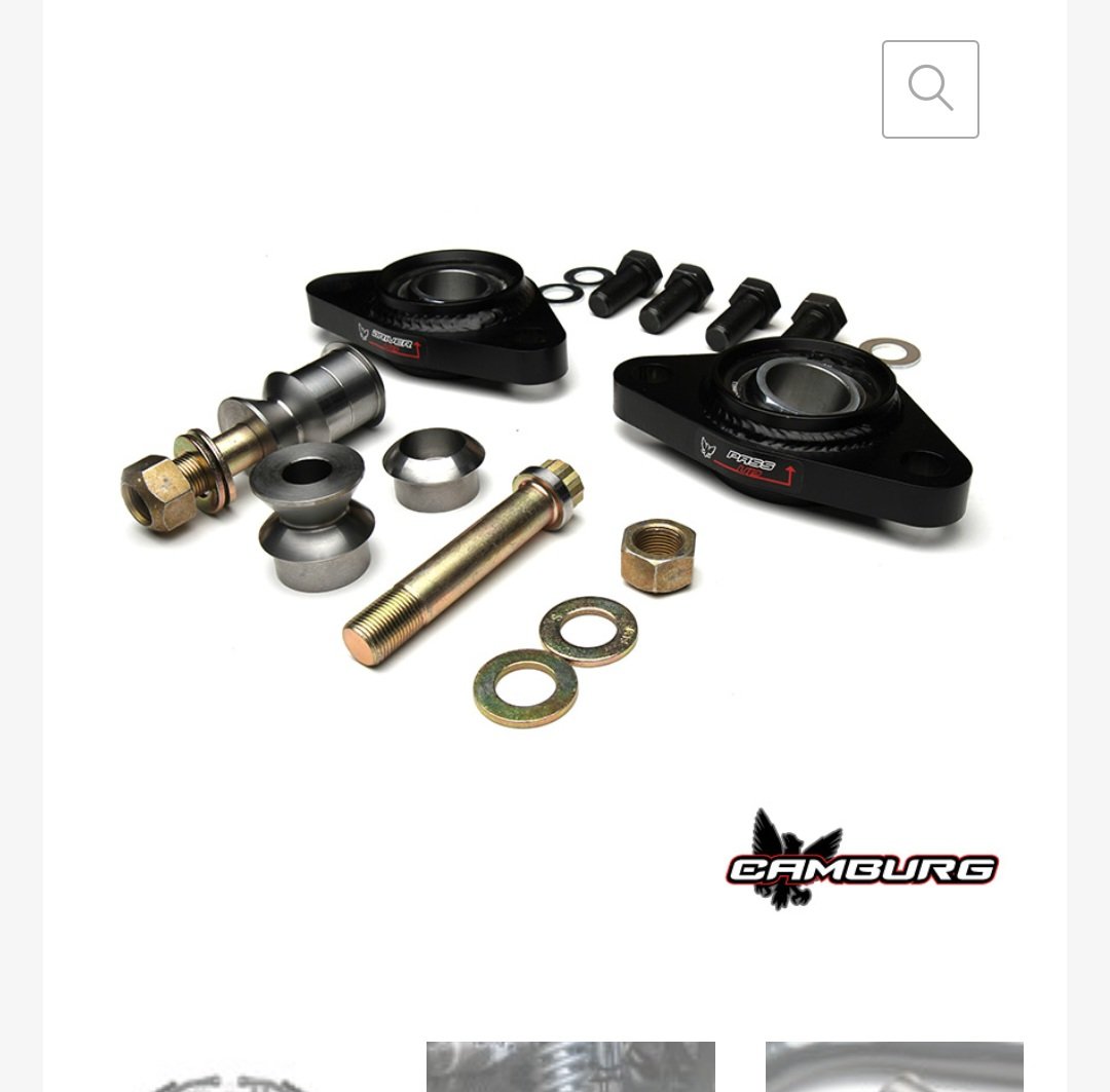

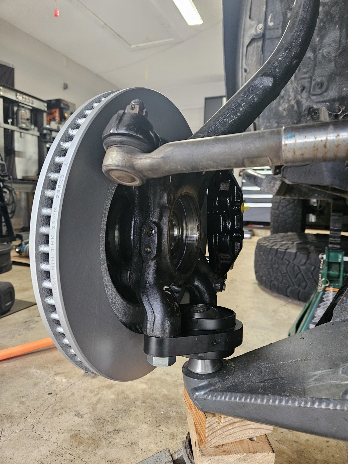

    So the more work I put into this long arm setup, the more I want to try something out first before I go into fully fabricating all my parts. I ended up buying the lower uniball adapter from the Camburg tundra long travel kit to see what work would be needed to use the factory tundra knuckle. I of course foresee that the upper arm will be in the incorrect location and steering arm location will not be optimal. Only one way to find out. I still want to do the jarm and change the shock location. The coil rub due to the steering drives me absolutely nuts.

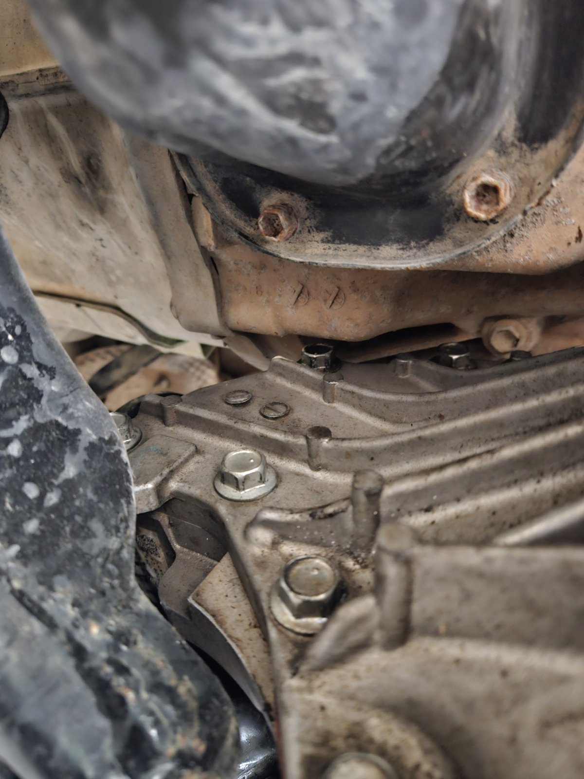

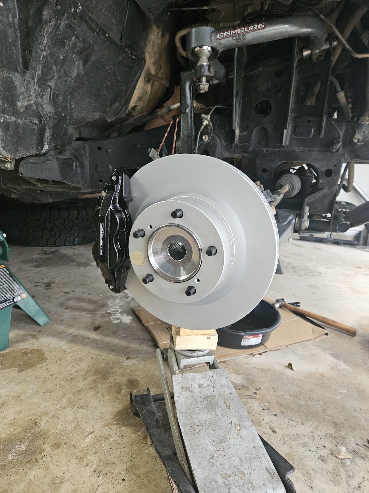

    Definitely going to need some work as expected but had to throw some brake components on. So clean

    man no dimple and slotted rotors! i thought this was a race truck gasp!

    Haha, maybe later on. The larger rotor will already be a significant upgrade.

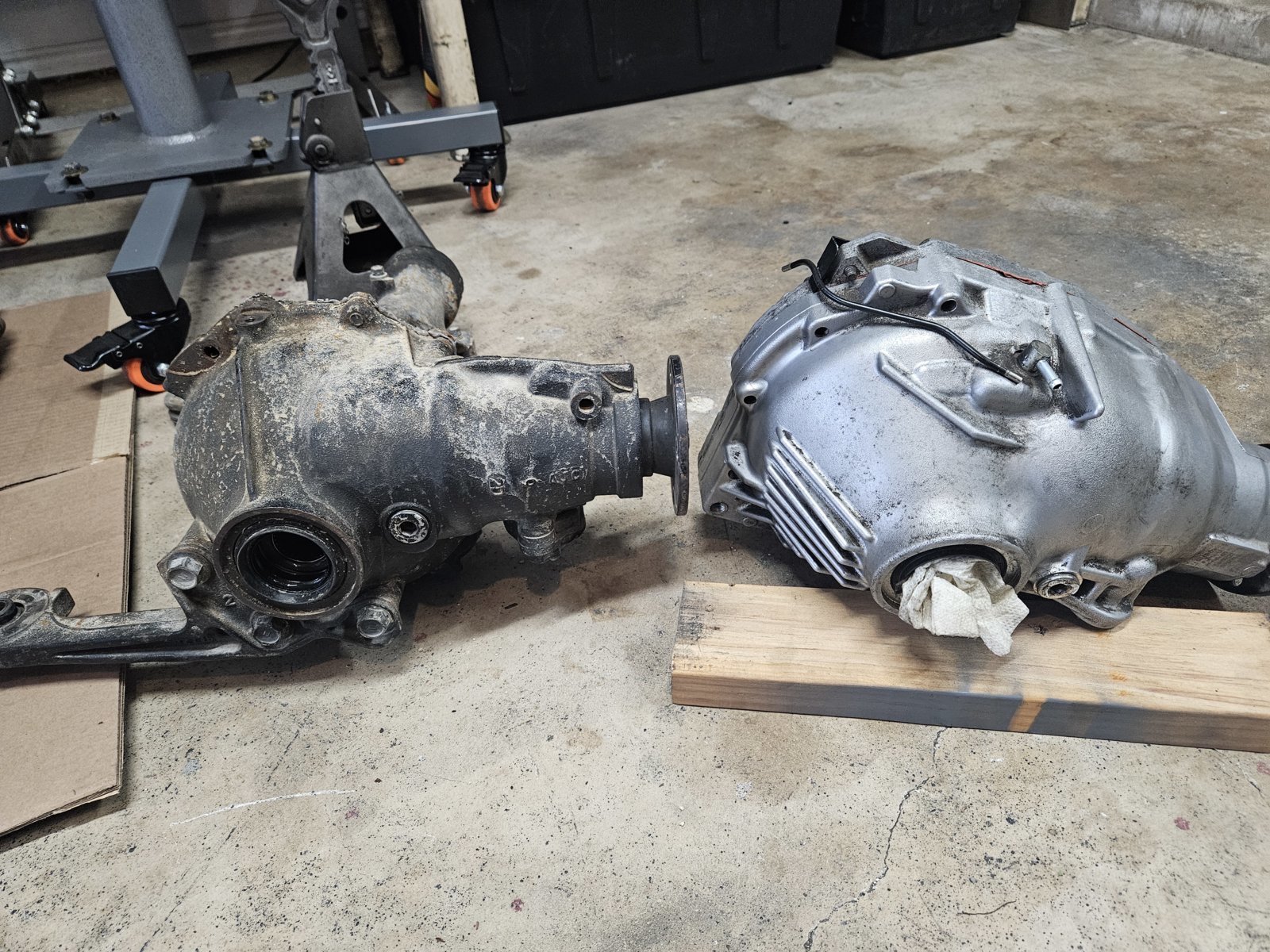

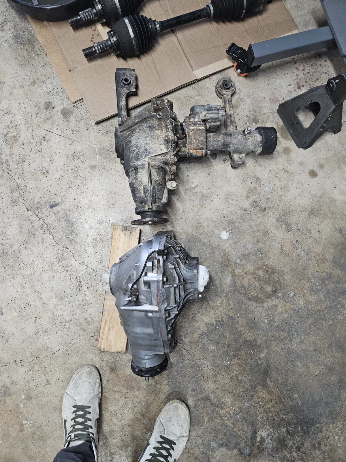

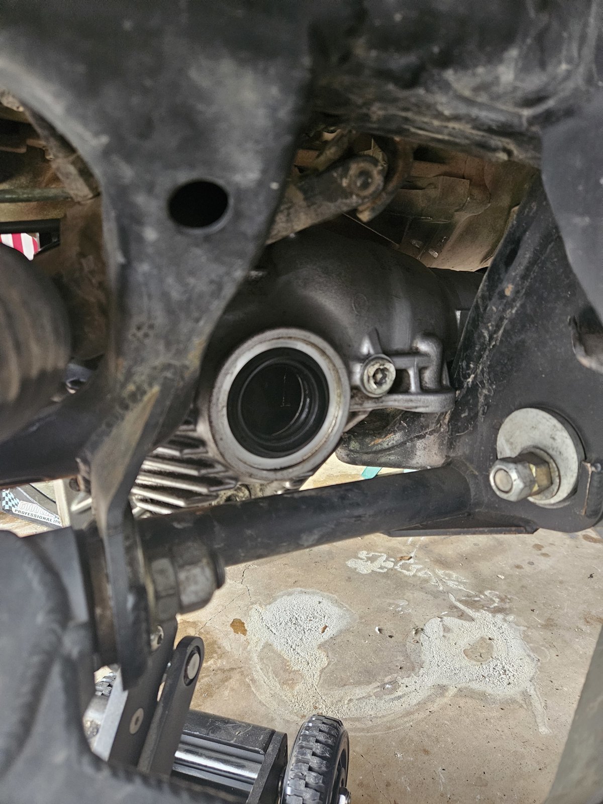

    Front diff is out. With ADD tube the tundra diff is 4.5" longer

    RonRon23
    RonRon23 Well-Known Member
    Aug 25, 2013
    #111135
    1,300
    Ronnie
    Buena Park
    2013 MGM DCLB 4x4
    Front suspension: Work in progress JD Fab +4 LT, LCA pivot kit, steering slide rack, 934CVs Rear suspension: Archive Garage shock relocation and SUA Conversion,King 14x2.5 shocks, King 2x2 hydro bumps, FN wheels 5 stars, sliders
    Whats the weight difference between them?
    Slashaar likes this.

    With the ADD tube, the tundra diff is 70.8lbs. Tacoma was 89lbs as config shown in picture.

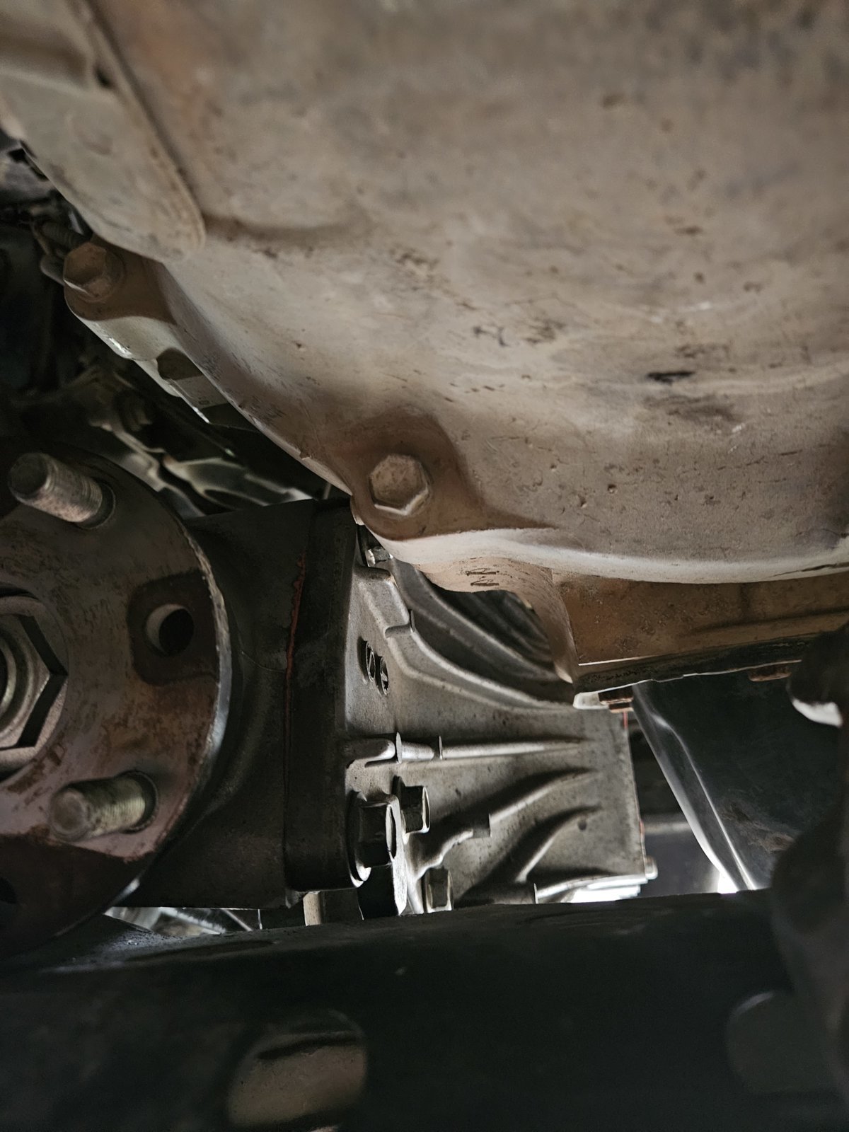

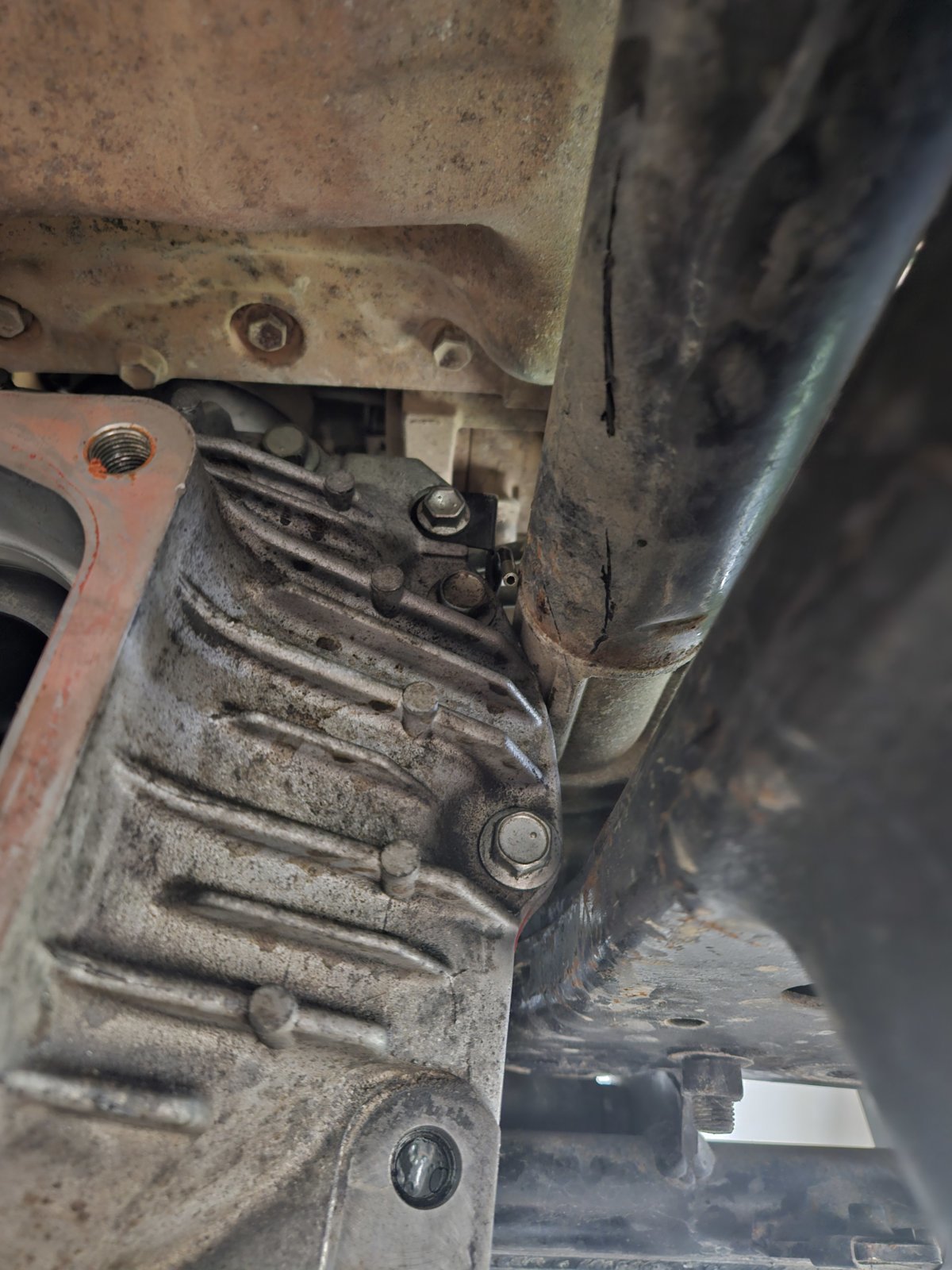

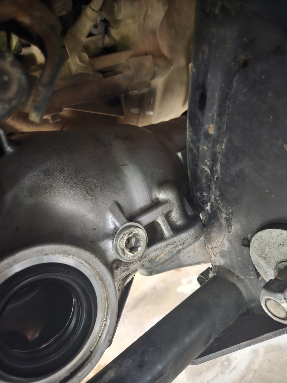

    It's tight. Contact in multiple areas. Some clearancing of the crossmember would allow the diff to come down a bit.

    It's tight, but honestly doesn't look all that bad fitment wise.

    I'm hoping clearancing the xmbr will be enough but we'll see. I don't really know how I'm going to cut and weld a section in there with it being so tight.

    More ideas are coming to me as I work through the susepnsion side. I have the JD Fab lower pivots so I have additional wiggle room as far as LCA mounting width. Depending on where the knuckle pivot lands, I'm curious if a tundra LCA would fit. More specially a camburg LCA from their long travel kit. If it does fit and the uniball is in a similar position or better yet more forward or longer, then maybe they would sell me a bare lca from their kit. I also thought about asking for a bare version of the fabricated knuckle as well. Although, I could make it work, a new UCA will need to be made. I may as well shorten the knuckle at that point. I need to find a tundra to measure the LCA.
