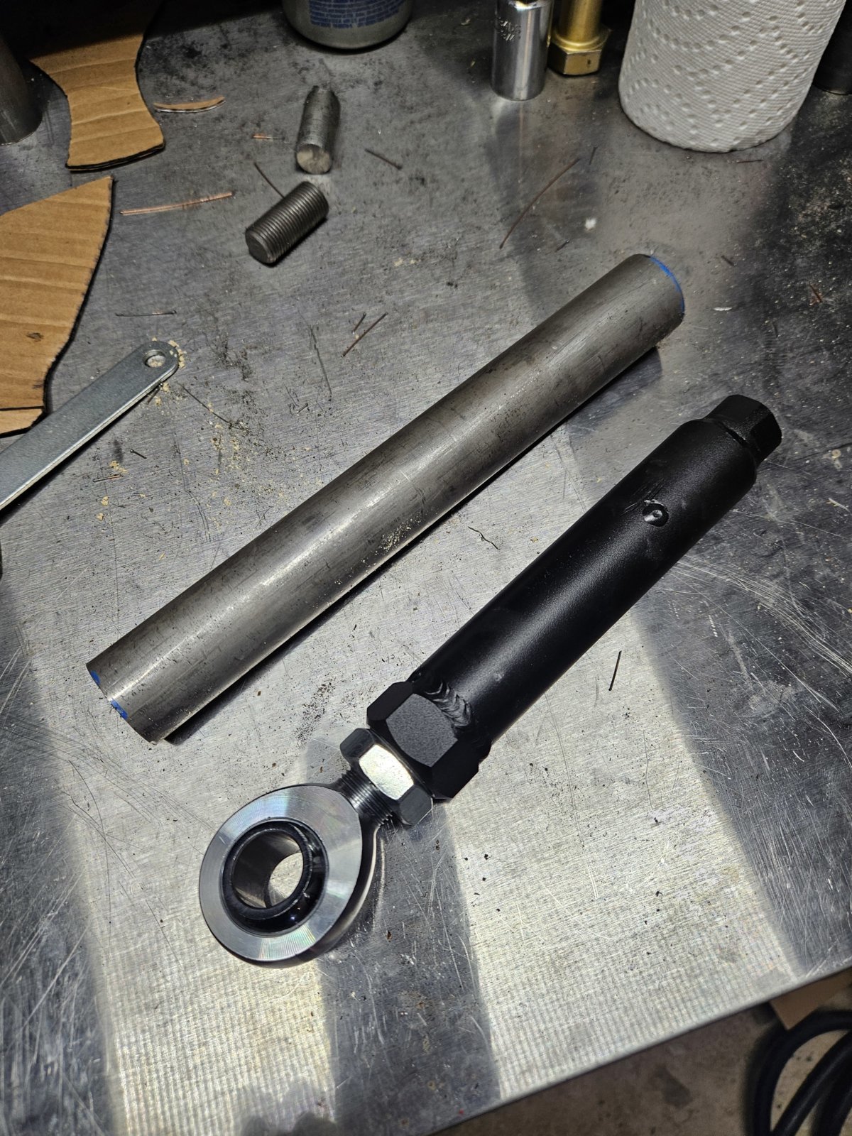

    Forgot to take a pic of each component, but a combination of heim weld bung, camburg steering extension and DOM tubing, I have the steering extensions complete. 3/4 rod ends, 1.25" dom shown. Camburg steering extension was a perfect fit.

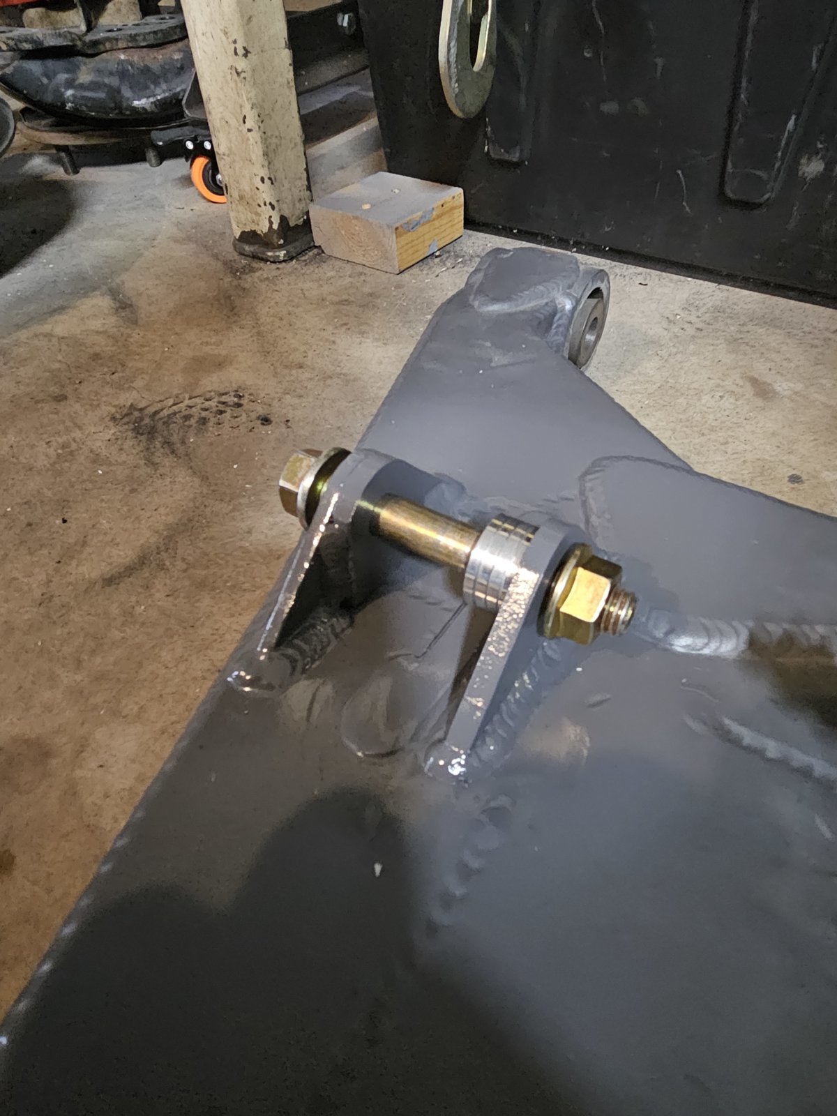

    Also, cut off the rear most shock mount tab and welded a new one back an inch so I have adjustability in shock mount location to provide steering tie rod clearance.
