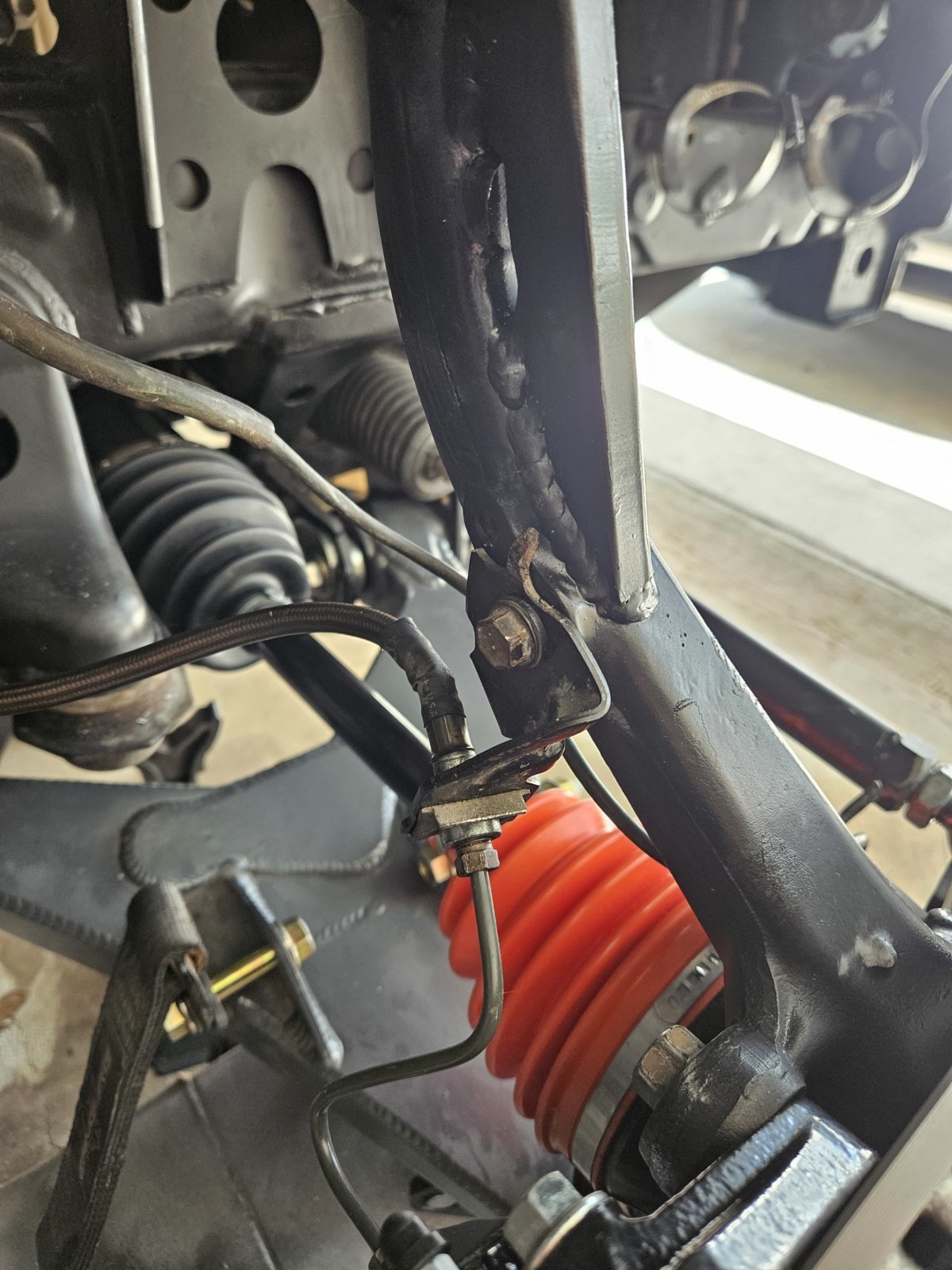

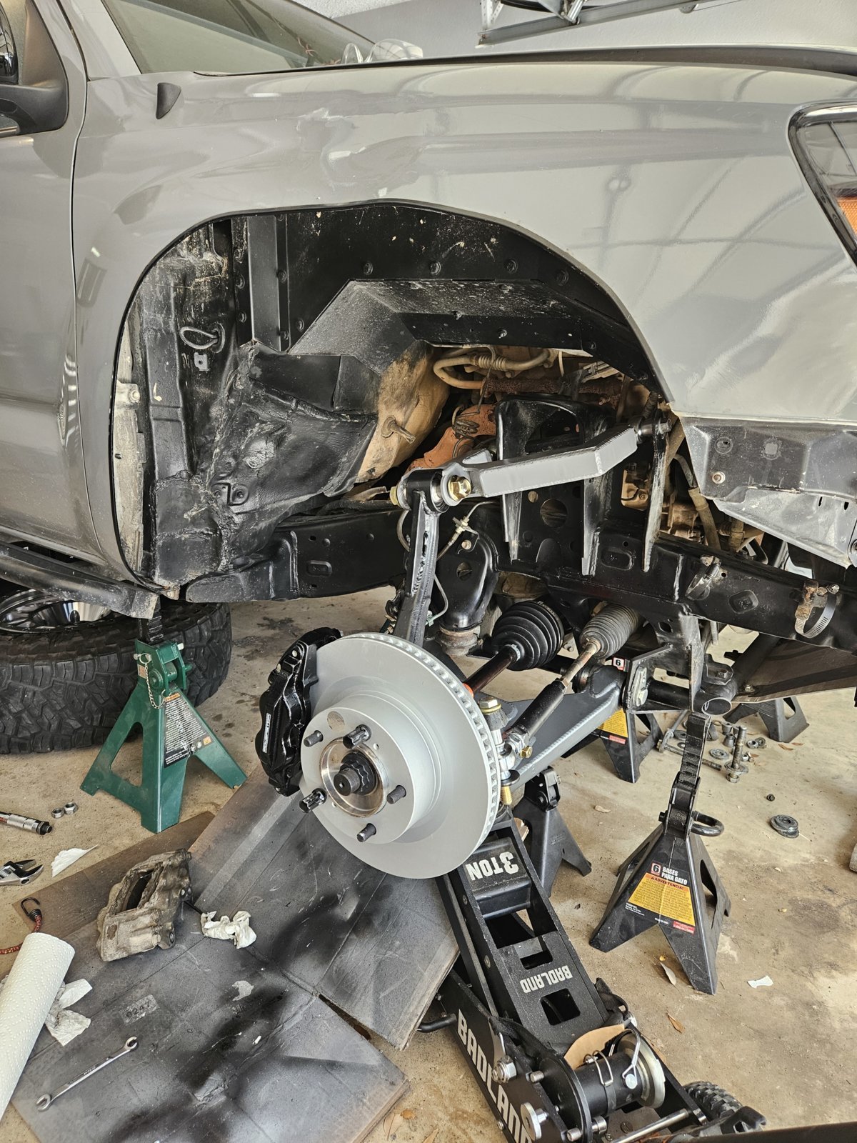

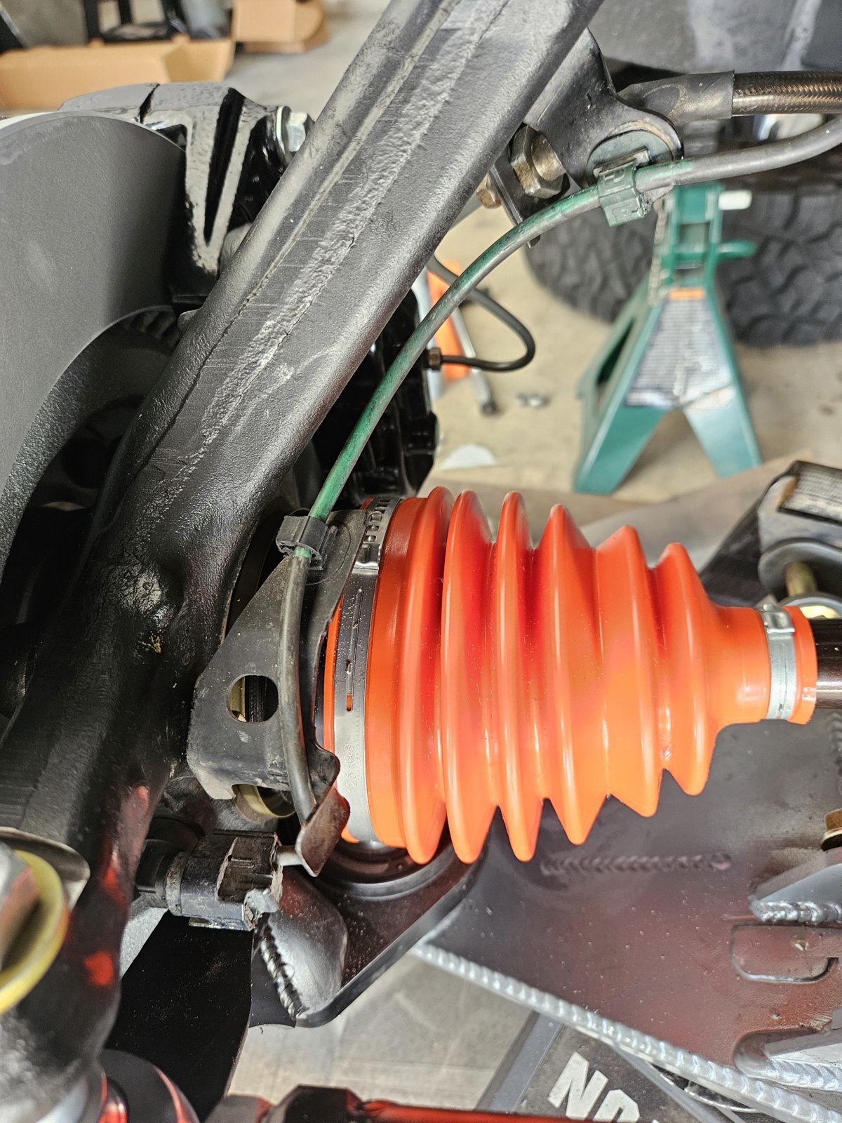

    Getting closer. RCVs came in and mounted. Didn't realize how much larger in diameter they were. I was able to make the factory brake line and abs wire support work. I should have measured the track width before I pulled everything apart but right now the rotor is just outside the rocker.

    Should have plenty of poke then.

    i have a feeling more of that oem fender is gonna need to be cut lol

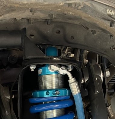

    Yeah tire is pretty far forward now I'm going to have to cut in the front. The dumb part is that I'm going to have to limit my travel some more; I'm going to bottom out the coilover now. I really need to either make a new shock tower to bring the coilover up or move the lower shock mount out towards the knuckle. It's a shame because there is so much to gain in up travel but the coilover is the limit.

    see if you can buy just a JD fab top hat, it sets the coilover through the stock bucket.
    I pocketed my LCA to lower the coilover mount so it wouldn’t bottom out, but I would have done the jd top hat had I known of them.

    I was thinking about that. Any chance you know how much it raises the shock up?

    I don’t have the parts to measure anymore, but this can give you some guesstimates.

    This is perfect, thank you. Looks like more than I expected.

    Give JD a call too. They’re prototyping a different tower cap as well last time I remember seeing in the JD thread.

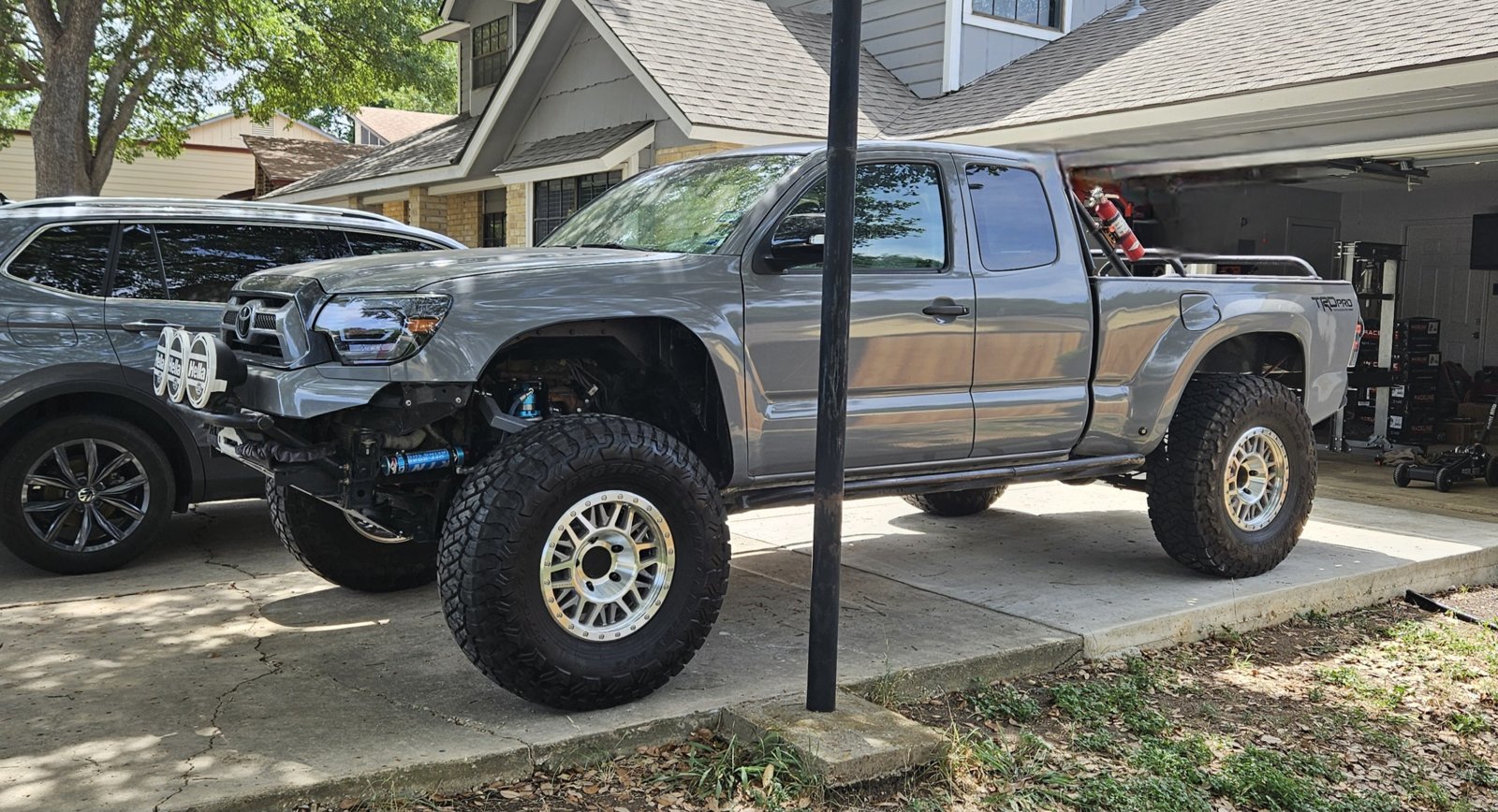

    Officially 5 lug at all 4 corners...tundra rotors, calipers, wheel bearings front and rear, tundra 10.5 rear axle. ABS is functional with tacoma sensors. Only thing missing is the front diff, but that is a project for another time.

    damn that thing looks nuts! odd seeing a taco on a 5 lug haha so when does the 5.7 go in?

    Haha, fitting a 5.7 would be a chore. Plus, I need a manual trans. A 4.6 has been in the back of my head to explore. Or I just go supercharger
