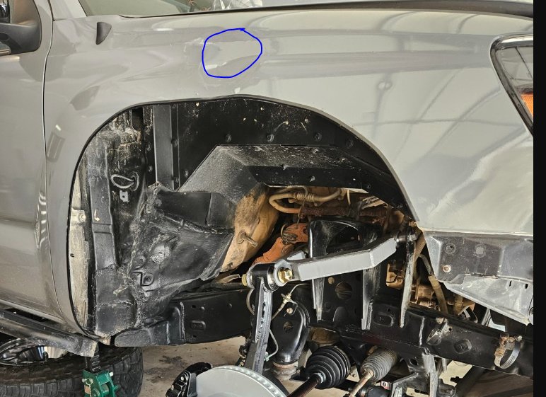

    Calamity_taco
    Calamity_taco your friendly neighborhood weeb :3
    Sep 6, 2016
    #196622
    23,509
    Jacob
    I have no idea. send help!
    2017 f-150, 97 & 98 EK, 23 Klx300R, 2022 tracer 9 gt
    just a couple of things tbh
    random question but is that the hole for your old snorkel? or is the light playing tricks on me lol

    Adventure4x4
    Adventure4x4 [OP] Well-Known Member
    Feb 12, 2016
    #177931
    1,378
    Adam
    San Antonio, TX
    2013 TRD off road MT
    It certainly is haha. The fender is a little mangled up due to my rough body work. I wanted to see how I liked the OEM fenders cut before I bought a new fender.

    Calamity_taco
    Sep 6, 2016
    #196622
    23,509
    Jacob
    oooh i gotcha haha i was wondering since it looked kinda sunken in? you not gonna run a snorkel again?

    Adventure4x4
    Feb 12, 2016
    #177931
    1,378
    Adam
    San Antonio, TX
    Most likely no but it did keep my filter cleaner for sure
