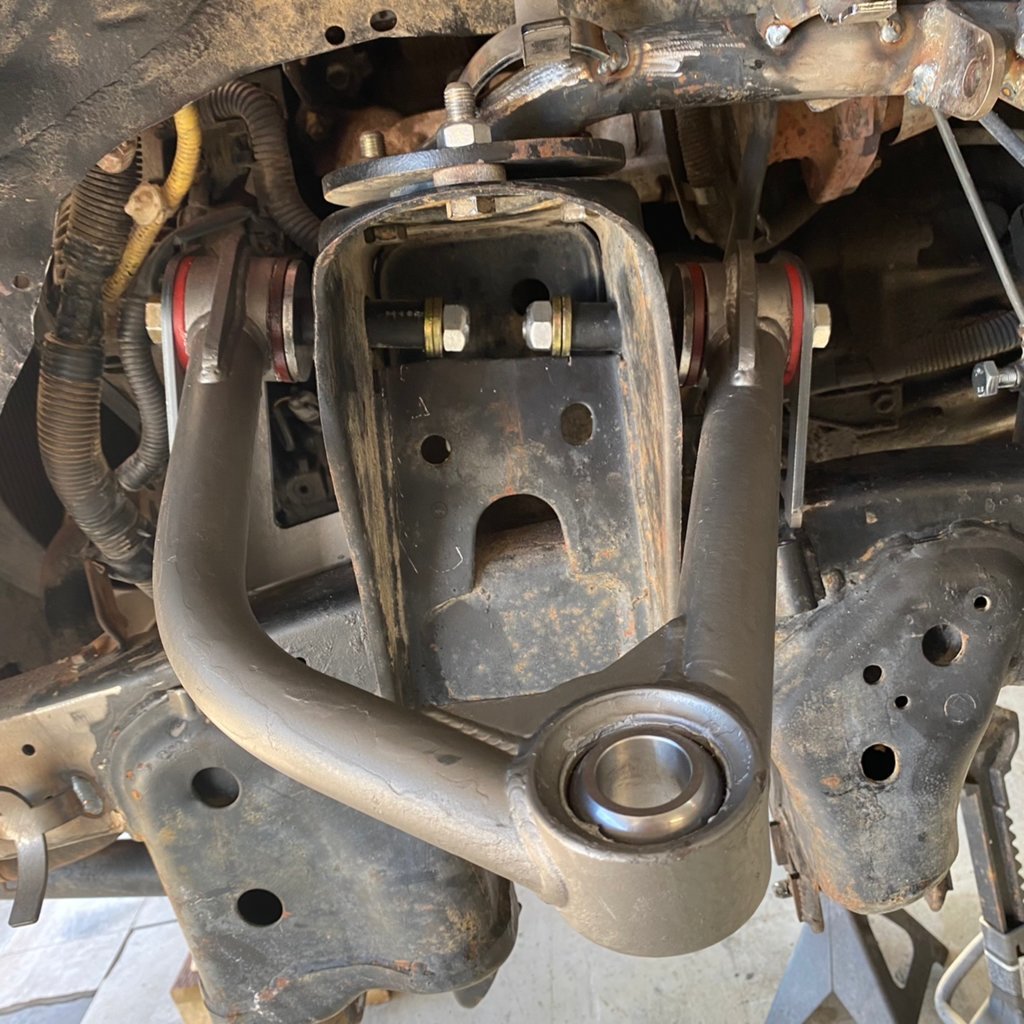

    Must be an optical illusion, it looks like there's a welded bead on the left heim joint lol
    you should've went king blue to match :rofl:

    Haha, yeah it's an illusion.
    I thought about changing the color one day haha

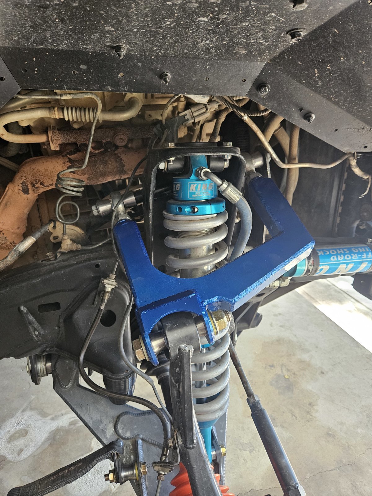

    Agree on ditching the bucket to make a regular shock cap work for the coilover. If you’re looking to run a 10” or 12” it will save a lot of space at the top.
    Ditching the long bolt makes a lot of sense with heimed uppers as well. High Desert Motorsports makes something like this for 4th Gen 4Runners. I ended up making my own for my 98.
    https://www.instagram.com/hi_desert_motorsports?igsh=ZDNlZDc0MzIxNw==
    If you keep the coil bucket you can still get rid of the long bolt.

    I'm curious if I would even be able to make use of a 10" coilover without moving the lower shock mount outward. I know I have room in jounce but unsure how much. But I guess it gives me room to work with?
    The elimination of the long bolt for the UCA is interesting. Didn't think of doing that.
