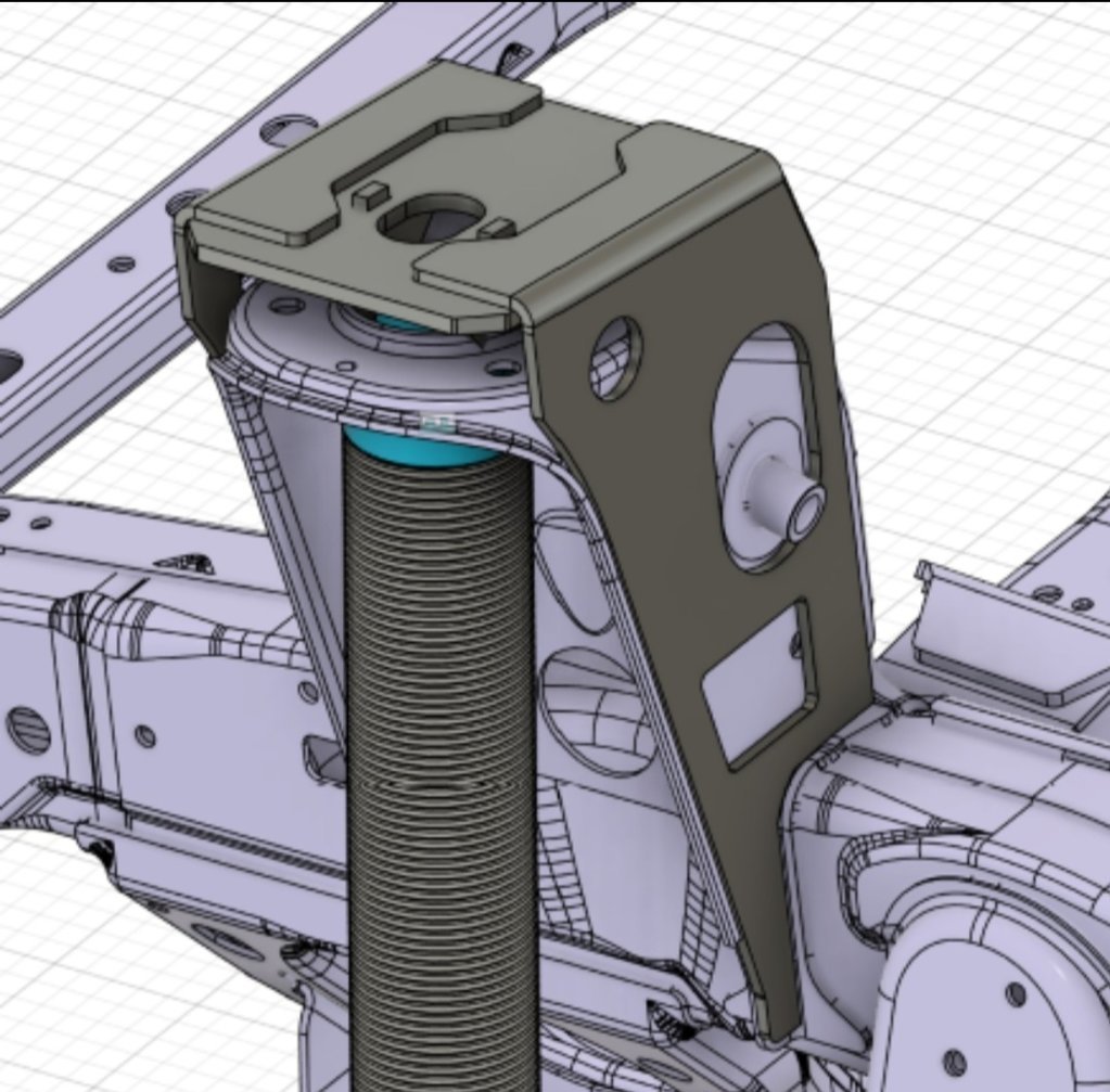

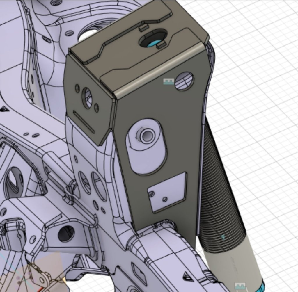

    So is the OEM shock mount top bolt location getting chopped or is this purely a reinforcement?
    Oh I see, eyelet top. So yes, chopped.
  2. Sep 13, 2024 at 11:52 AM
    #622
    Adventure4x4
    Adventure4x4 [OP] Well-Known Member
    Feb 12, 2016
    #177931
    1,378
    Adam
    San Antonio, TX
    2013 TRD off road MT
    The OEM one will still be intact. The only part I'll be cutting off is the top. So a little bit of both

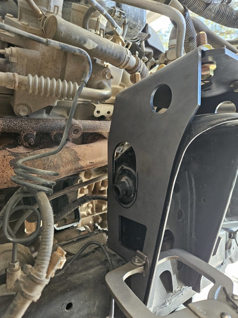

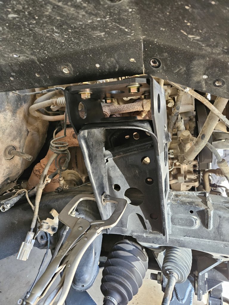

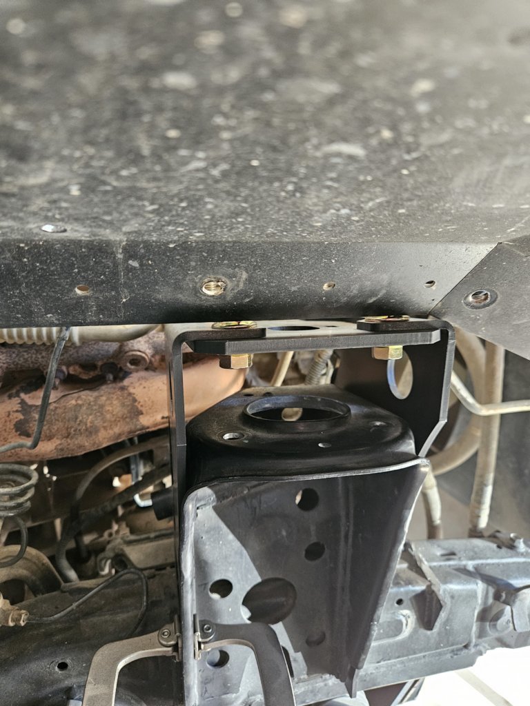

  3. Dec 28, 2024 at 11:38 AM
    #623
    Adventure4x4
    Feb 12, 2016
    #177931
    1,378
    Adam
    San Antonio, TX

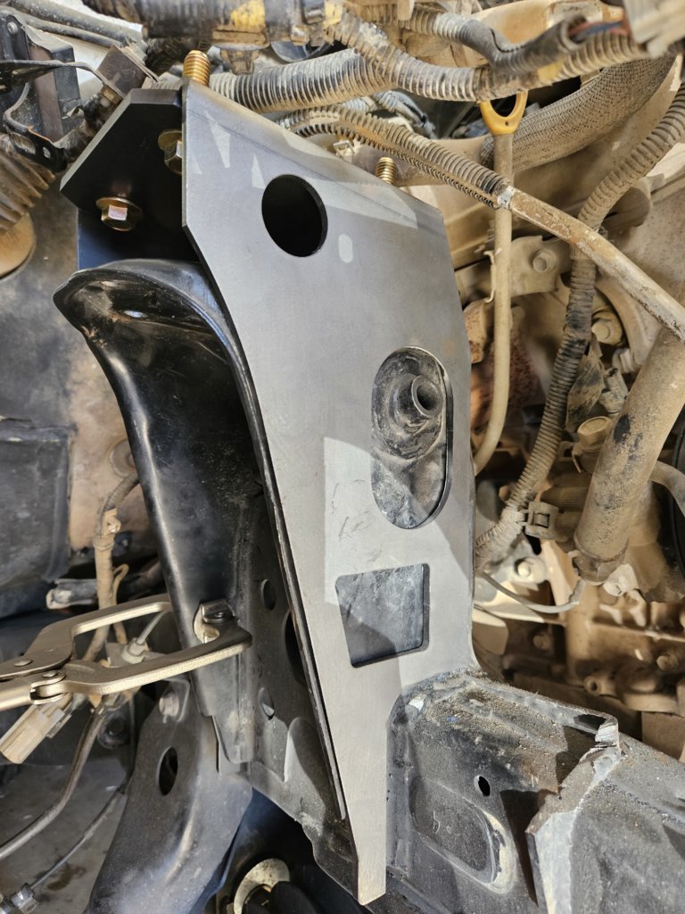

    First mockup of the towers. Some trimming necessary to better match fillet of the welds but overall happy with with the fitup so far. This would be very difficult without the ability to remove the inner fender.

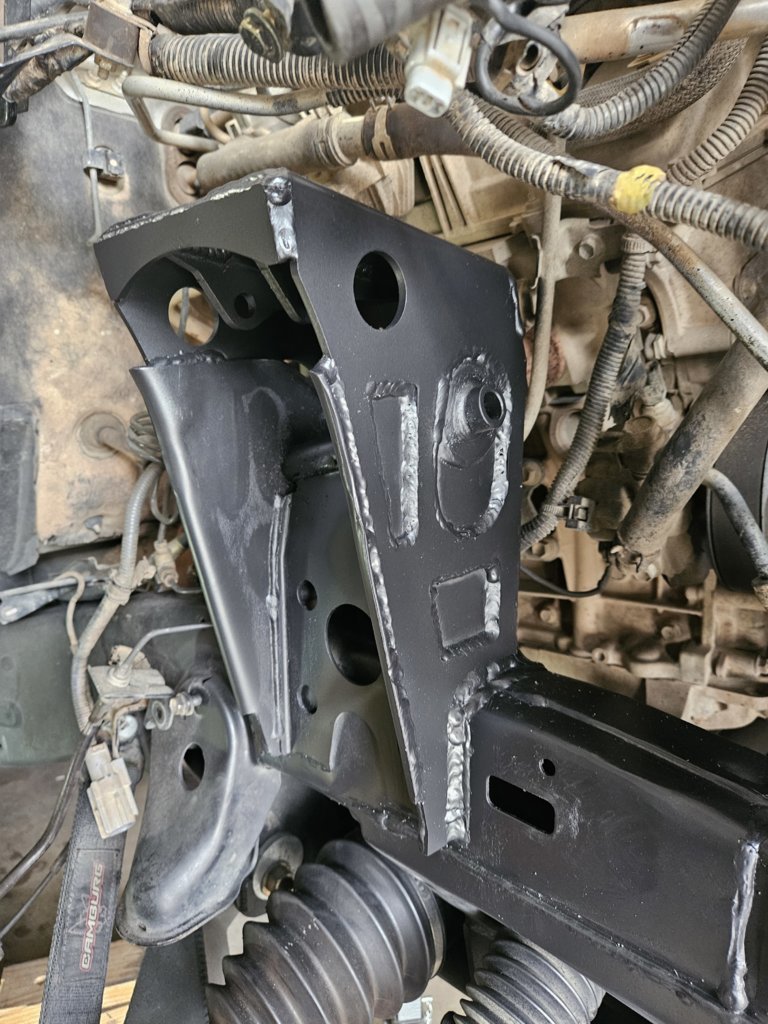

  4. Jan 15, 2025 at 3:29 PM
    #624
    Adventure4x4
    Feb 12, 2016
    #177931
    1,378
    Adam
    San Antonio, TX

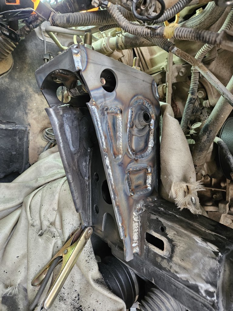

    Maybe a little overkill on the welding but overall it turned out well. The backside was a pain to reach with the welder.

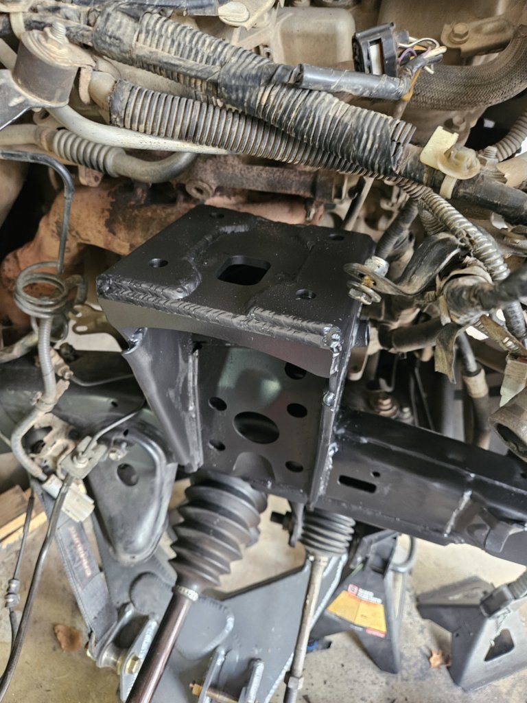

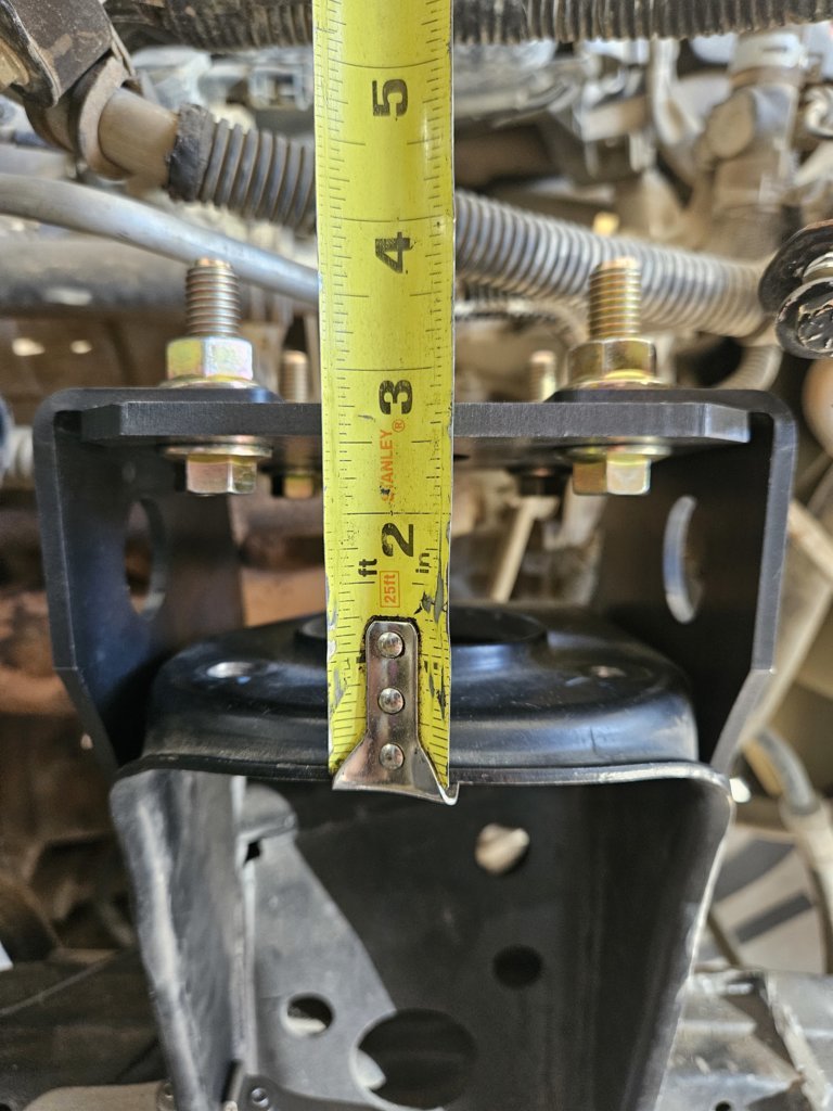

    Looks great. What length shocks do you plan to use with these towers?

    Thanks. I'm still going to utilize the 8" travel coilover. The purpose was to gain more jounce travel. With my current setup a 10" wouldn't gain me anything.

  7. Jan 15, 2025 at 5:09 PM
    #627
    Wishbone Runner
    Wishbone Runner Because 4R
    Sep 9, 2012
    #86546
    6,342
    James
    CO
    04 SR5 4Runner
    King/Dirt King
    Very cool! Is the shock mount/tabs welded in now, or are the bolts still used and it it removable?
    sparkystaco likes this.
  8. Jan 15, 2025 at 6:20 PM
    #628
    Adventure4x4
    Feb 12, 2016
    #177931
    1,378
    Adam
    San Antonio, TX
    Tabs are welded in now so no more adapter plate. So nice being able to remove the coilover with a single bolt.
