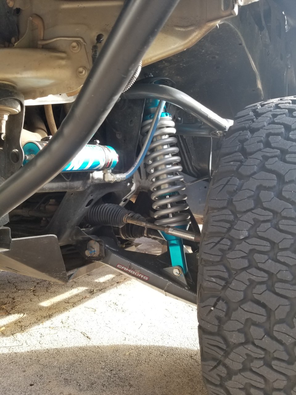

  2. Nov 8, 2020 at 8:20 AM
    #82
    Calamity_taco
    Calamity_taco your friendly neighborhood weeb :3
    Sep 6, 2016
    #196622
    23,289
    Jacob
    I have no idea. send help!
    2017 f-150, 97 & 98 EK, 23 Klx300R, 2014 Bolt R-spec
    just a couple of things tbh
    Didn’t know 500lb springs were a thing
  3. Nov 8, 2020 at 10:16 AM
    #83
    Adventure4x4
    Adventure4x4 [OP] Well-Known Member
    Feb 12, 2016
    #177931
    1,377
    Adam
    San Antonio, TX
    2013 TRD off road MT
    Im pretty sure I'm like the only one that runs them. Everyone runs like 600-700lbs but with 16" springs. The issue with 16s is that there isn't much travel so you have limited room for adjustability. The 18" has a little over 9" so plenty of room for preload adjustment if need be and it rides nice. I let the dampening do most of the work and the spring just basically supports the weight of my truck and sets ride height.
    Calamity_taco[QUOTED] likes this.
  4. Nov 8, 2020 at 3:22 PM
    #84
    Calamity_taco
    Sep 6, 2016
    #196622
    23,289
    Jacob
    That’s good I run 700s and I still sag haha fuck...

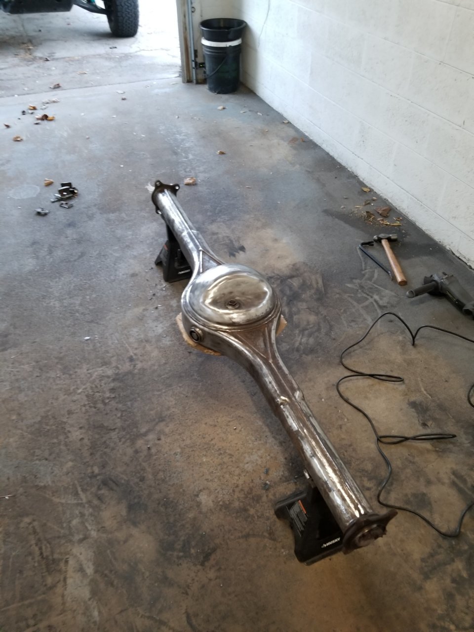

  6. Nov 17, 2020 at 3:01 PM
    #86
    Adventure4x4
    Feb 12, 2016
    #177931
    1,377
    Adam
    San Antonio, TX

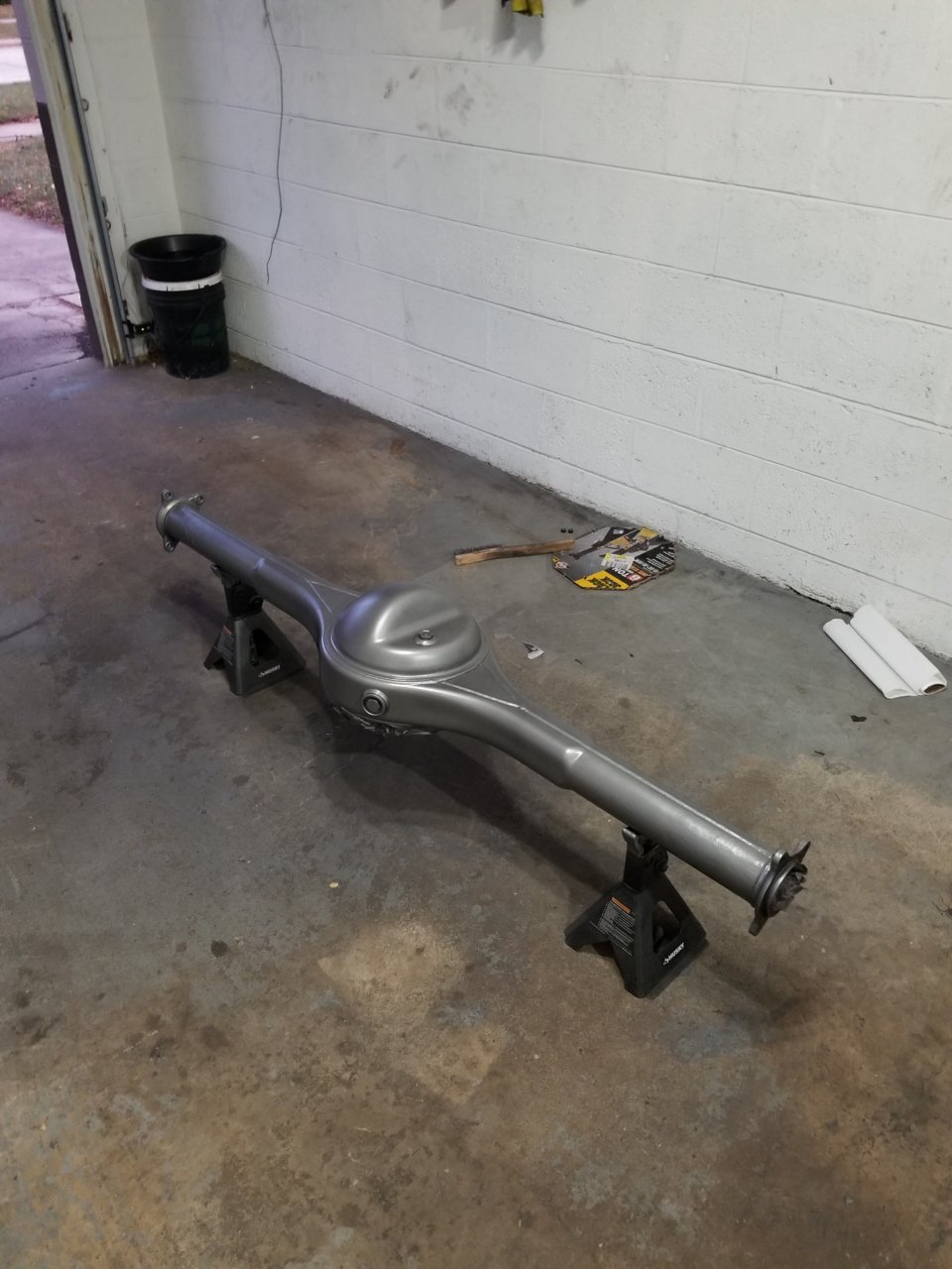

    What a mess but it's getting there. All the mounts have been cut off and still working on cleaning it up for paint. Just got the shafts torn apart to be reworked for the 6x5.5 bolt pattern and 106 center bore.
    Sociopenguin and mcharfauros like this.

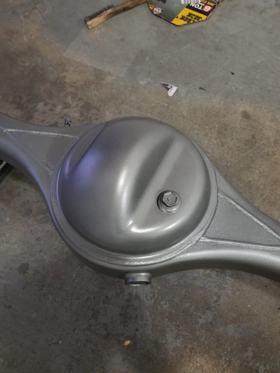

  7. Nov 18, 2020 at 2:53 PM
    #87
    Adventure4x4
    Feb 12, 2016
    #177931
    1,377
    Adam
    San Antonio, TX
    Finished up treating all the rust and gave it a coat of gray steel-it. Not sure if I'll keep it or just go black instead :confused:

    Clean! You pull bearings yet?
  9. Nov 21, 2020 at 4:49 AM
    #89
    Adventure4x4
    Feb 12, 2016
    #177931
    1,377
    Adam
    San Antonio, TX
    Yes and it was absolutley terrible :rofl:Bearings were pretty seized. Ended up having to use heat to break them loose. I bent the studs on the bearing housing and the 1/4" plate on the bearing puller.
