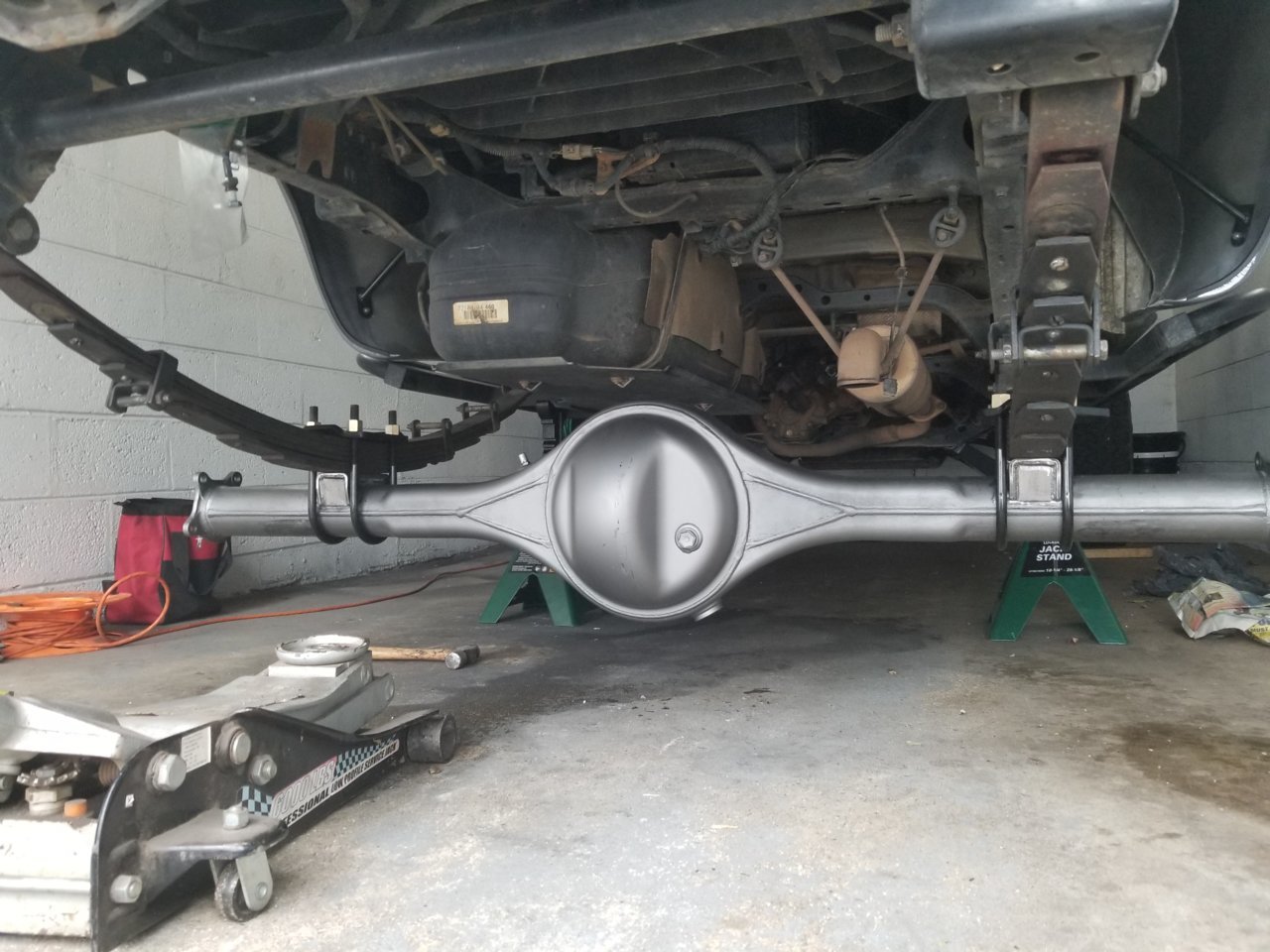

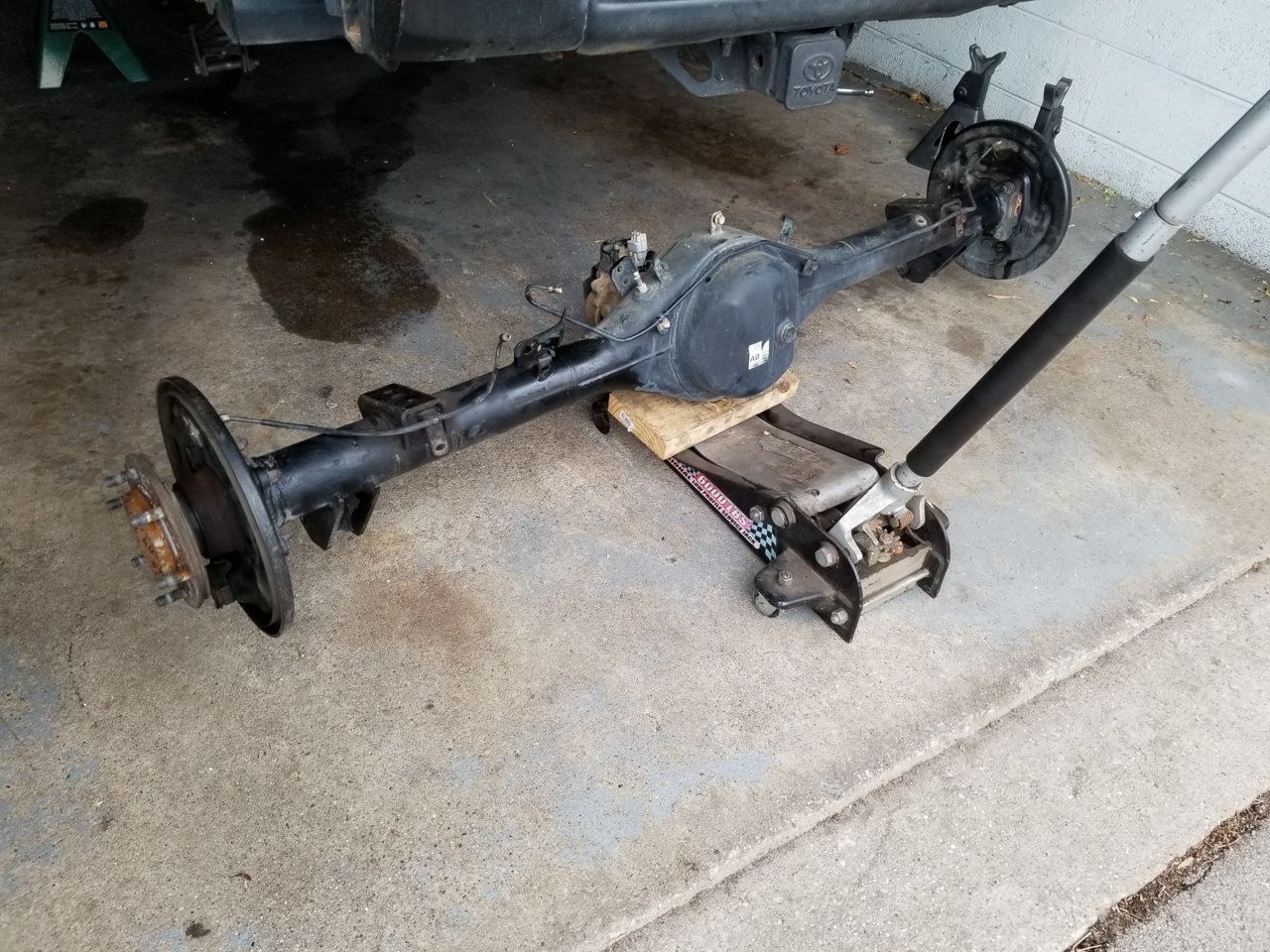

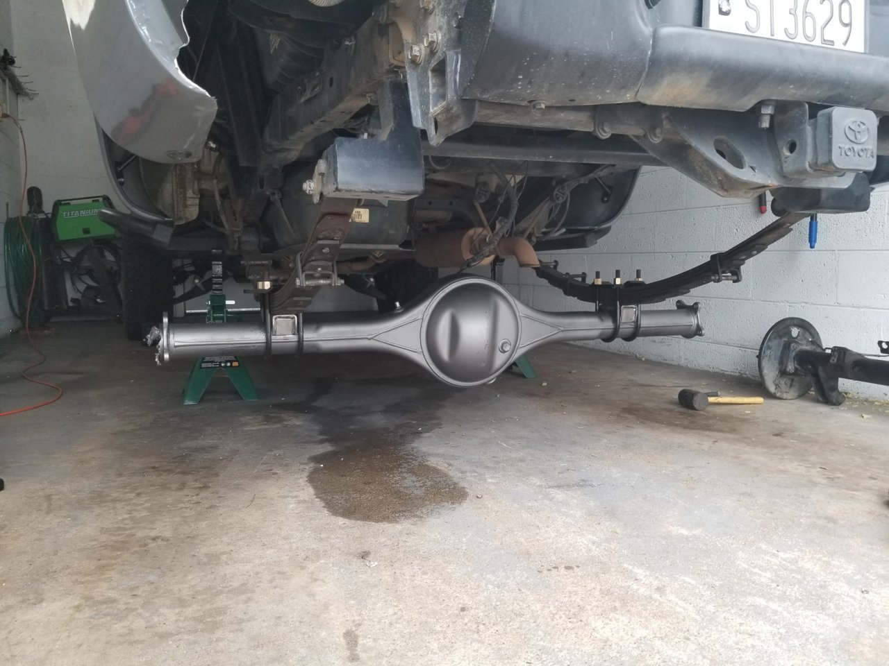

    The archive garage ubolt flip came in so was able to progress with the axle build. Was able to remove the current axle and mockup the new one. Finally have driveshaft length so I can put that on order. While installing the axle, it looked like the 3rd member wasn't going to clear the fuel tank skid, but still plenty of room after cycling. Its like she was destined to be there haha.

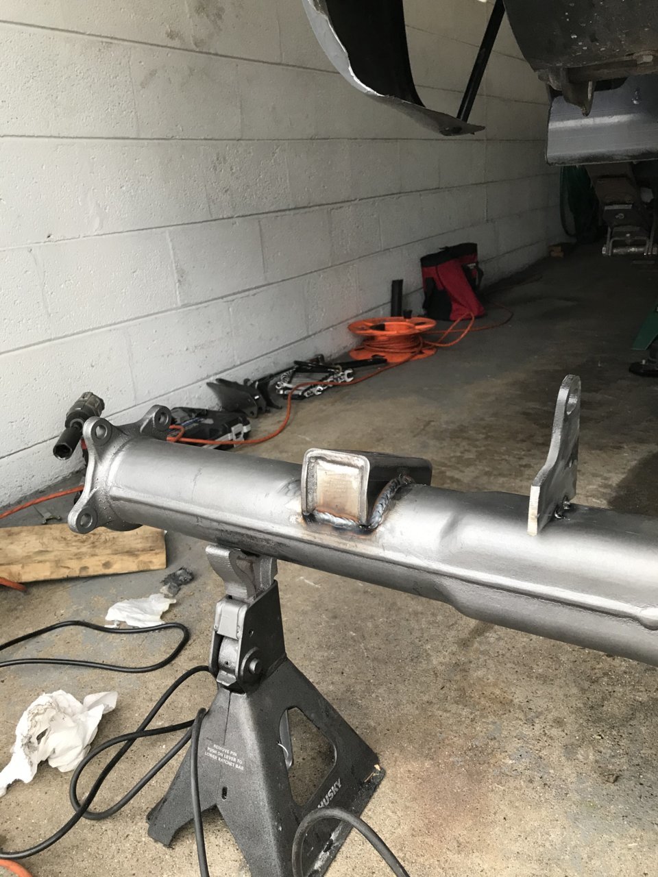

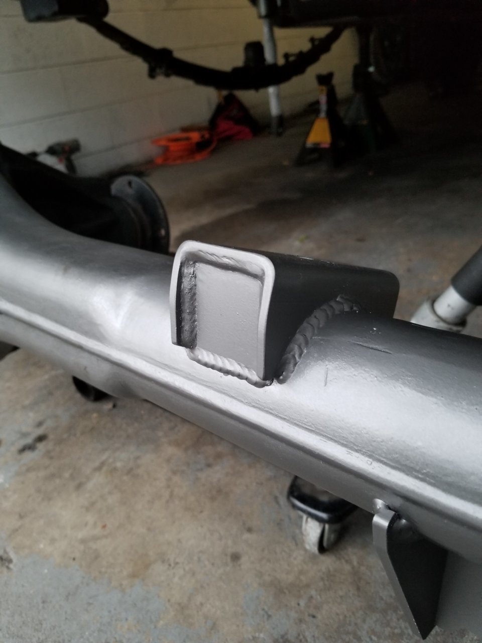

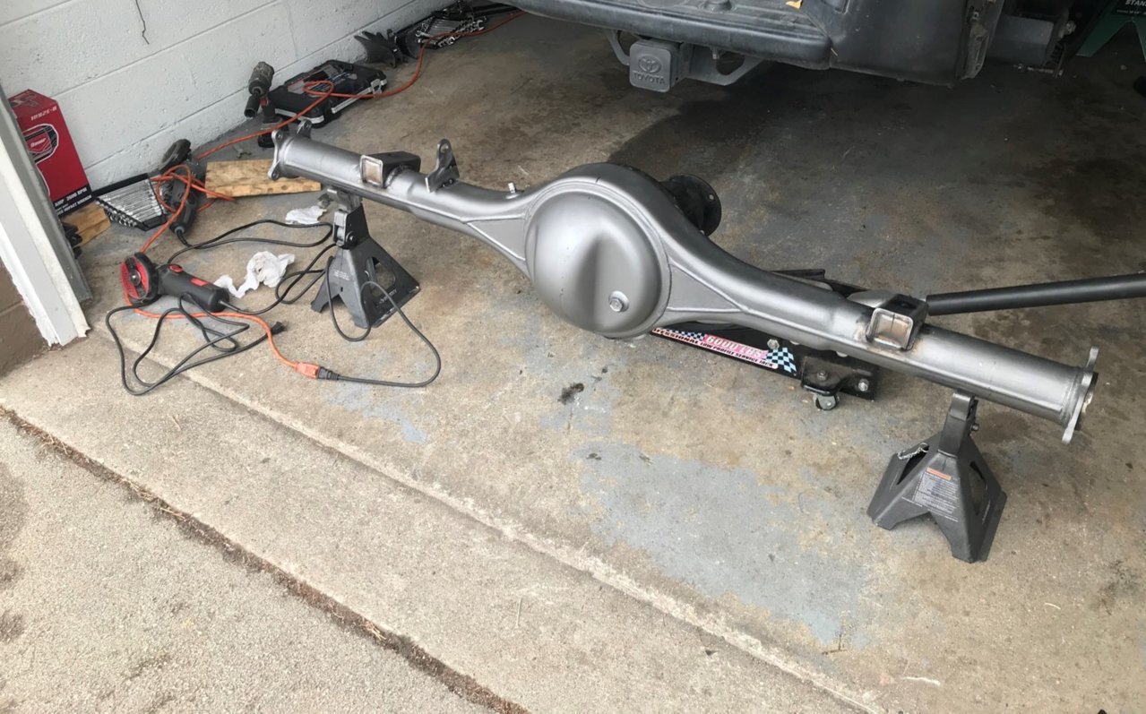

    Leaf spring perches are burned in for good. Ill be throwing the shocks back in next so I can bolt the axle back up and tack in the shock mounts.

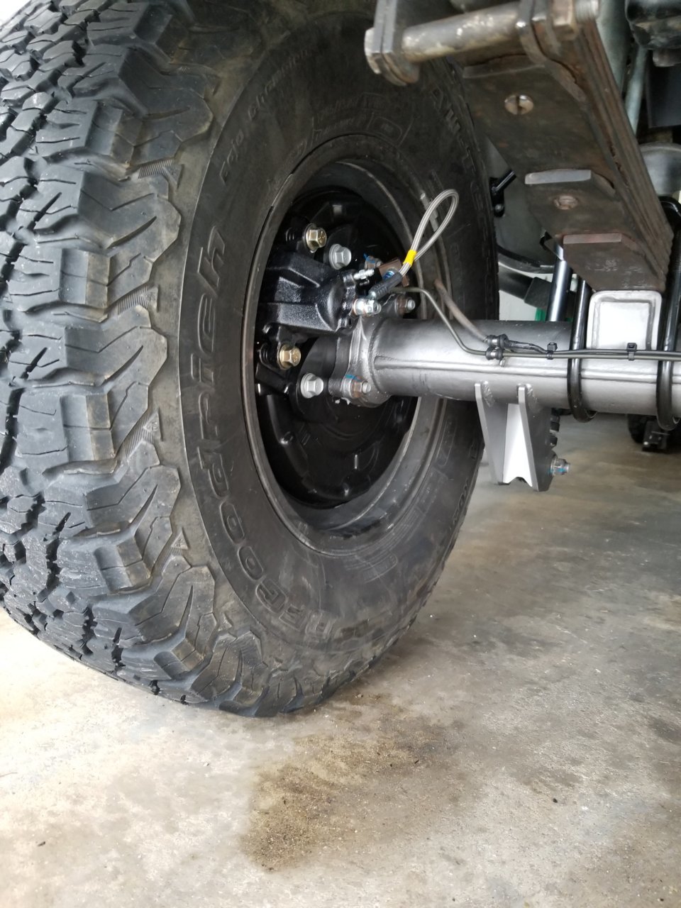

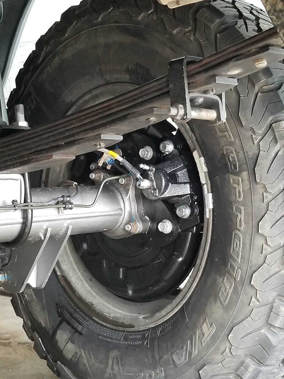

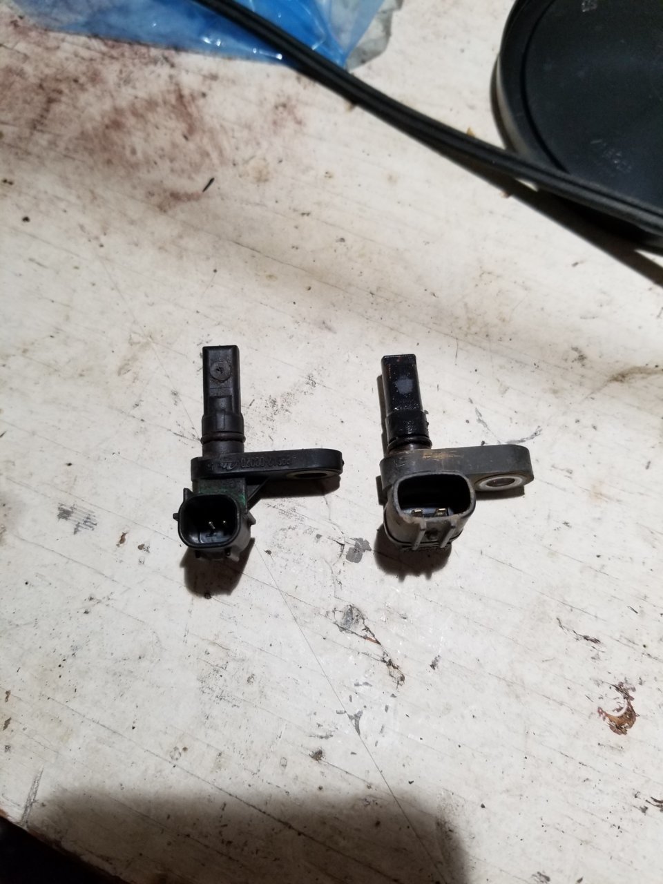

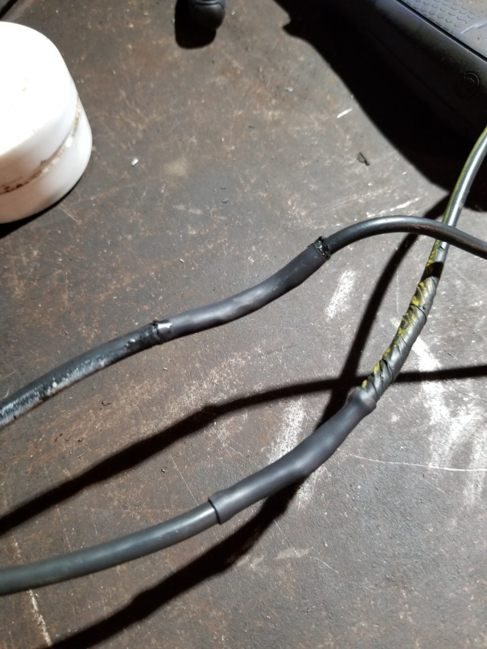

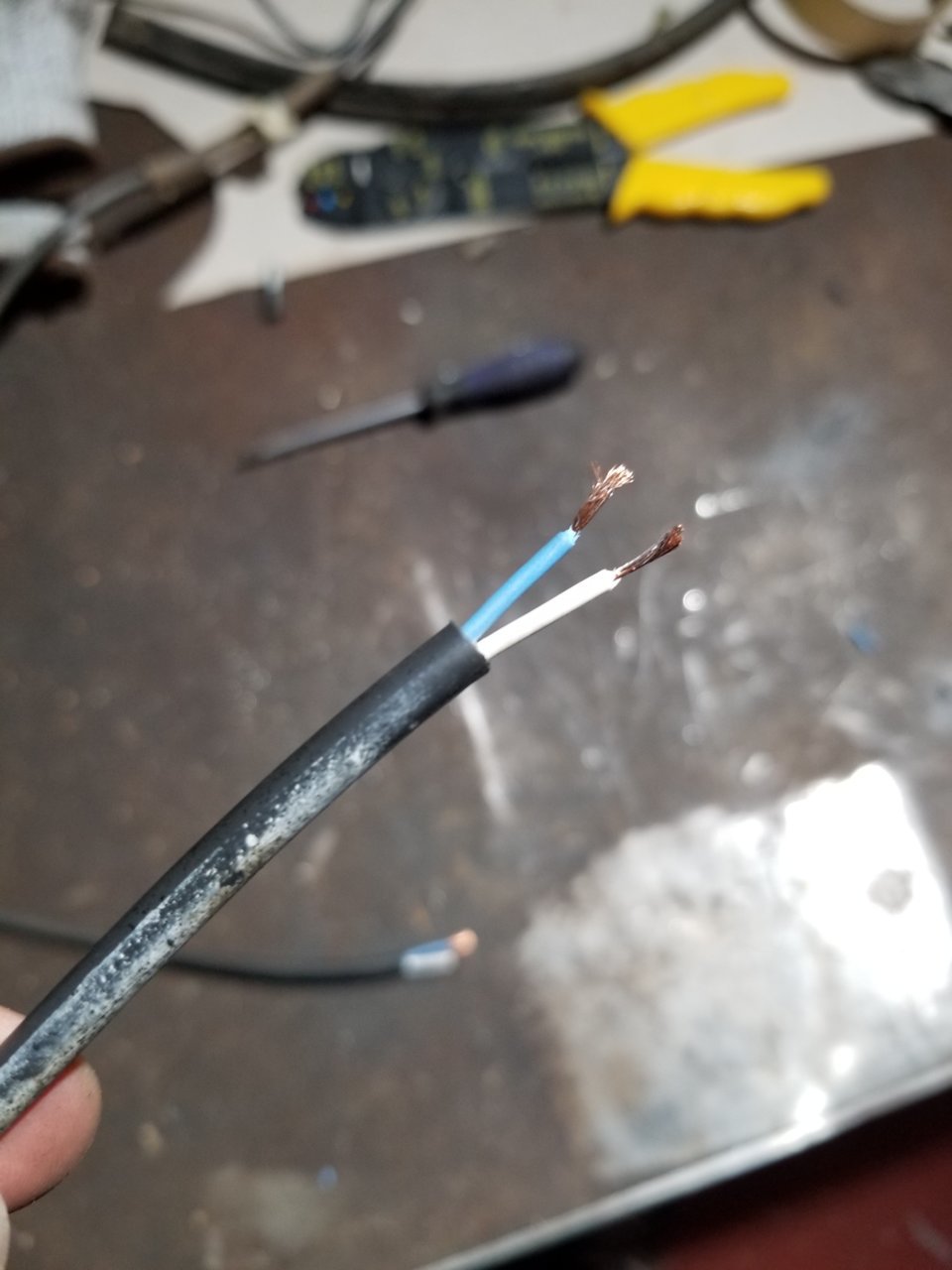

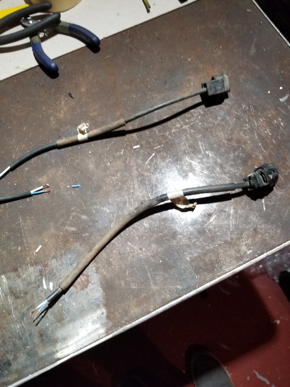

    Started working on the ABS wiring. As you would probably guess, the tacoma wiring harness is too short for the tundra axle so I went ahead and spliced and extended it using part of the cut tundra harness I had...continuity is in check. The main harness connector for the tacoma and tundra are identical so I could probably just buy a tundra abs harness if I wanted to but figured I'd save a few bucks and try this first. The next piece to the puzzle were the abs sensors. The tacoma sensor uses a different connector than the tundra but fits in the tundra wheel bearing and is the correct gap to the encoder ring. The polarity gapping on the ring is identical around the circumference for the tundra and tacoma so I'm pretty confident the response wave will be correct. I didn't bother counting so not positive but the diameter is the same. I guess we'll see when I have it all hooked up to the truck, but it should work.
    Tundra sensor on left and tacoma on right
    You can see the polarity intervals on the magnetic encoder ring.

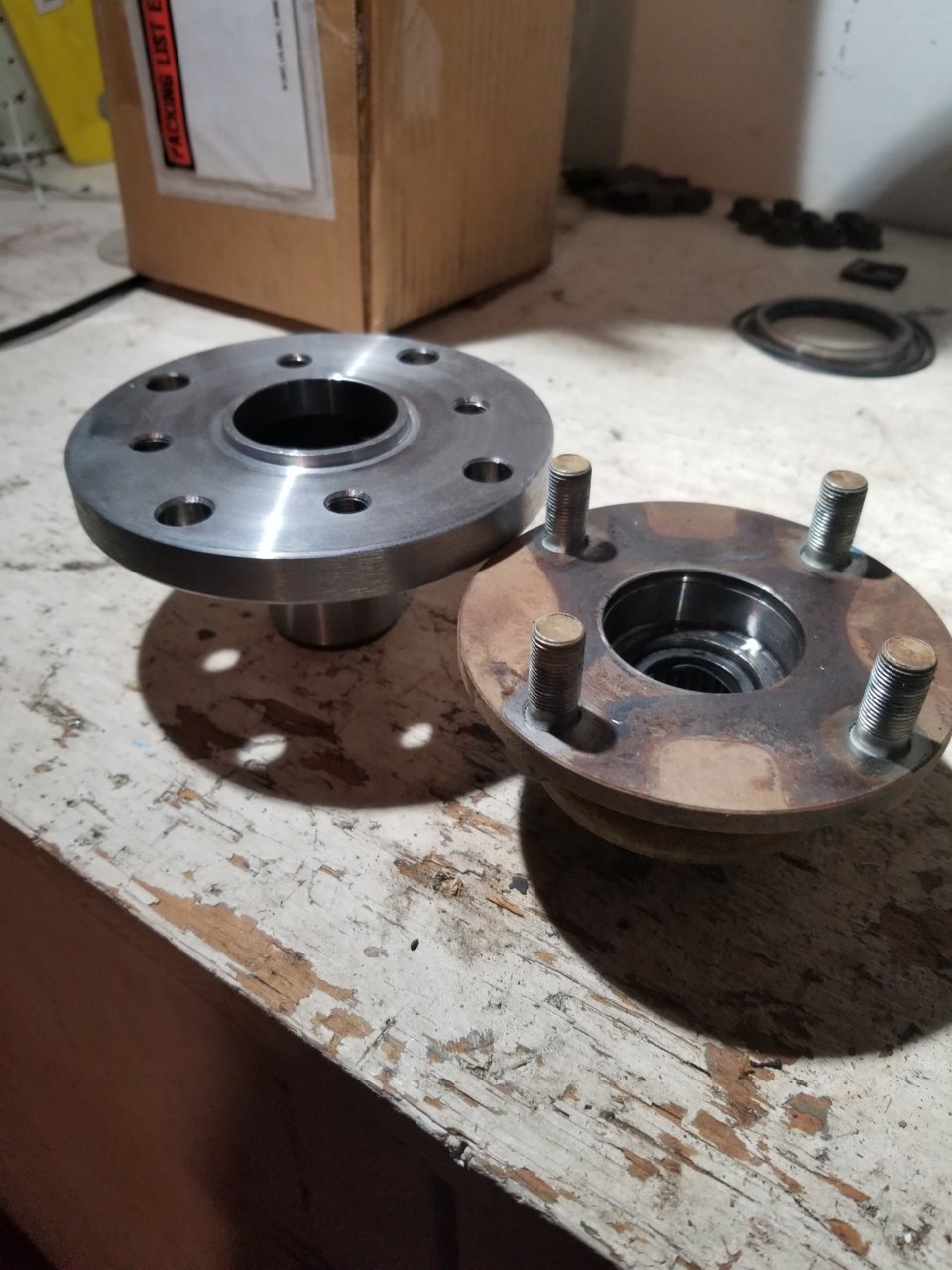

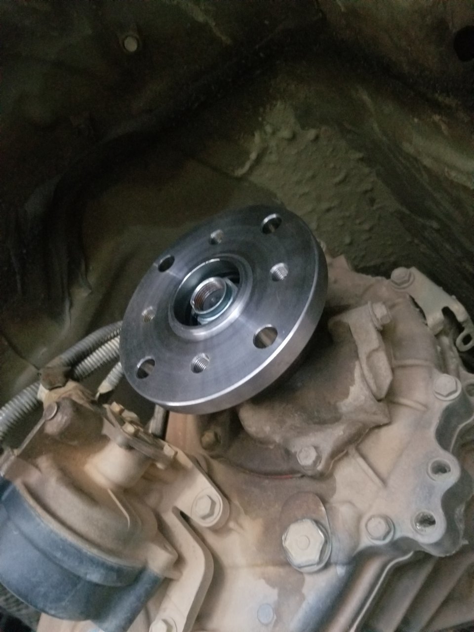

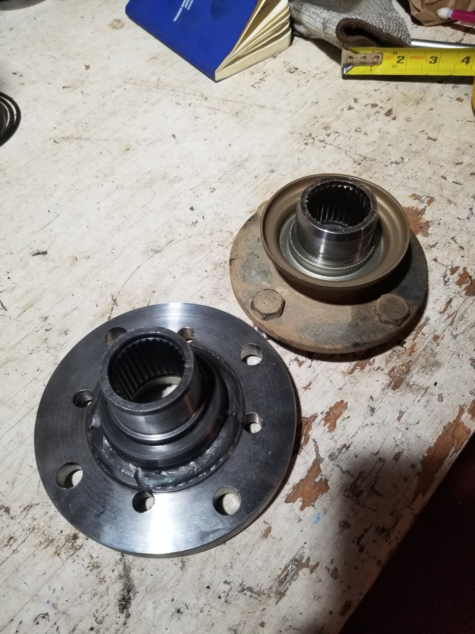

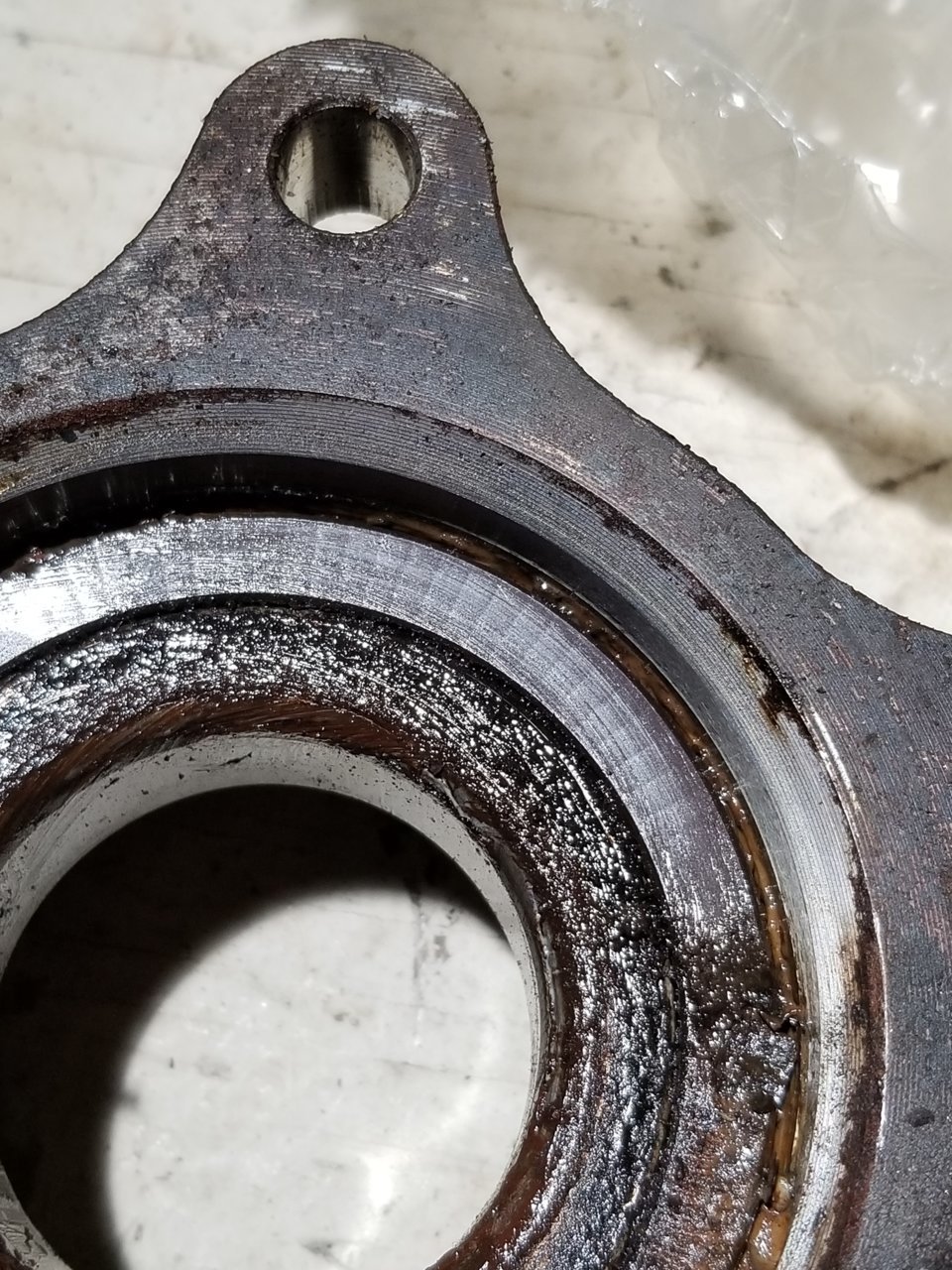

    Initial prototype for the 1350 t-case flange came in. Its currently made from an MC 30 spline flange and a 1350 spicer flange. Both were turned down, press fit, welded together, and turned down a second time to match oem specs. Production goal would be a single piece. Would also prefer to retain the dust shield because I like oem, but we'll see haha.
    Excuse the leaky t-case and the spray of grease from the driveshaft ;)

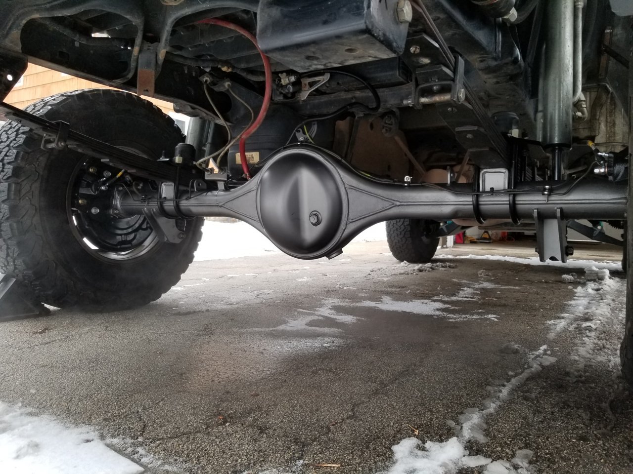

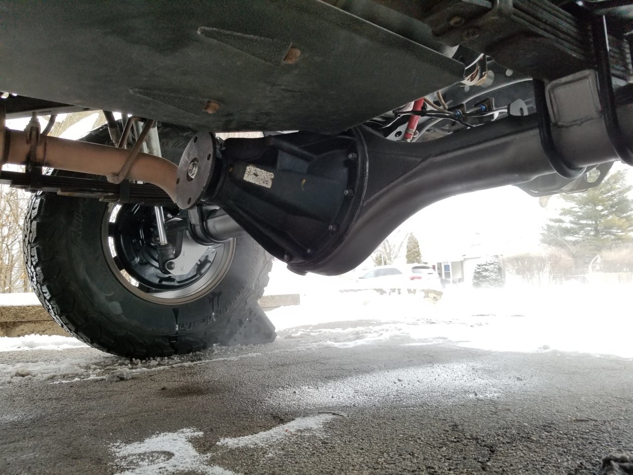

    Still plenty to do but she's back on the ground at least! Brake lines and abs wires routed so we at least have brakes. Next thing on the list is the ebrake cable. The driveshaft should be in this week. I'm not going to start setting the gears up in the front until I know everything works properly in the rear.
