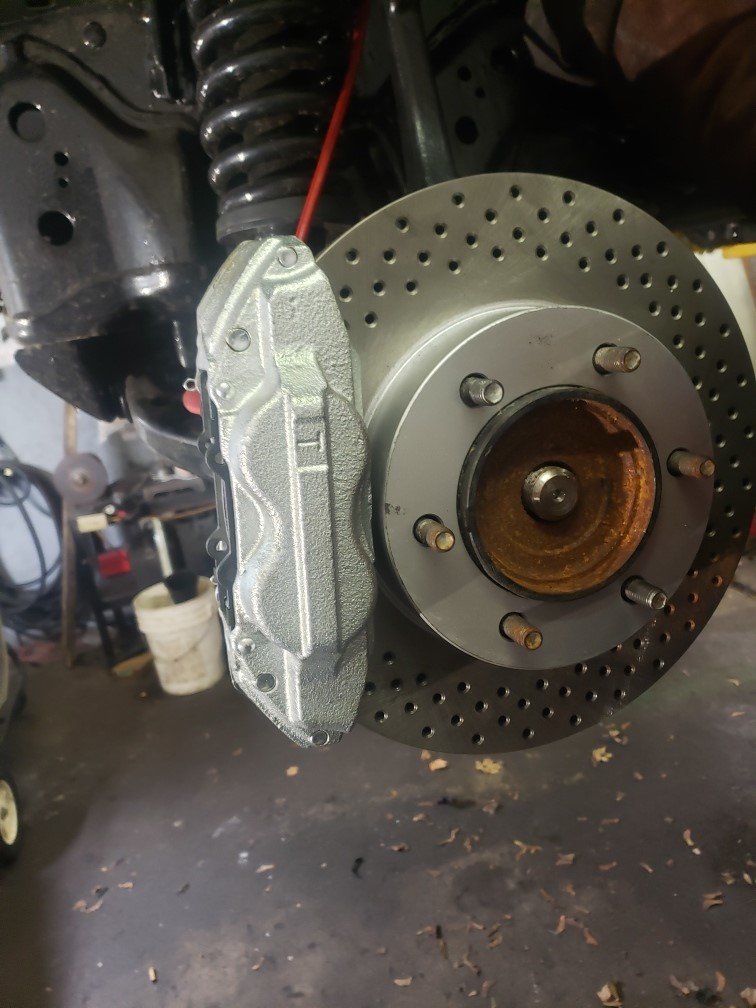

    I went the CANADIAN CROSSED DRILLED ROTORS route with my 13WL TUNDRA Upgrade. Also the RED stainless Steel hose from Amazon $25 a set,
    Thanks for your thread on the Tundra upgrade !

    Mine are part of a kit for a 1993-2002 Toyota Corolla, the one with the banjo are 20" long and for that reason I used those instead in the rear setup. And the ones with the fittings I used upfront with the OEM TUNDRA hard lines Part No. 47351-35270 Front Right and 47352-35310 Front Left. AJP Distributors has a eBay store and a Amazon store as well. The eBay store link is this one here : https://www.ebay.com/itm/313069668873

    DO NOT PUT BANJO HOSES ON THE 13WL CALIPERS, THEY WILL LEAK, THEY ARE NOT DESIGNED TO BE USED WITH HOSES DIRECTLY. ALWAYS USE THE HARD LINES SETUP.

    This is the truth. Banjos are not the right application for the Tundra brakes, even though some may have had success using them.
