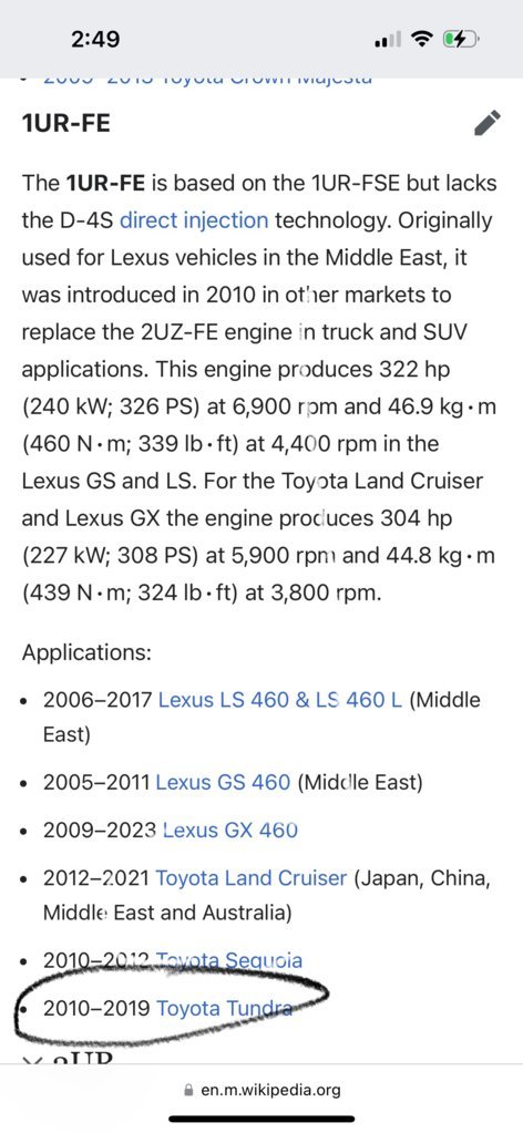

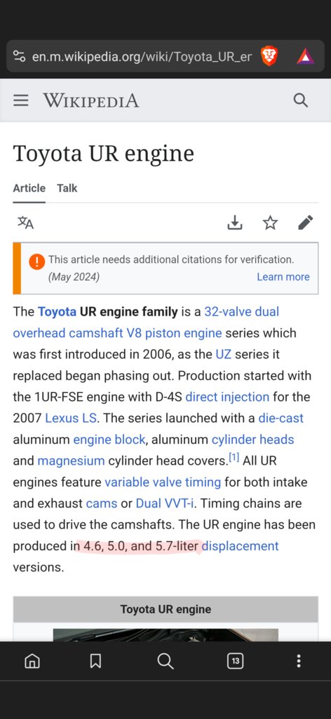

    Any accuracy to the photo I posted? I know Wikipedia is suspect info so I’m genuinely asking. I’m not here to debate you, troll you or tell you you’re wrong. I’m here learn and inquire as much info as possible. Were there multiple motor options over the years? I know that I bought my 2012 tacoma specifically because it was the “2.5” gen because they updated the motor and fixed a few issues they were having with the 2nd gen motor. What do you make of this infor in the photo?

    Your Tacoma has a 1GR-FE engine. It's Toyota's 4.0L V6. Same as my 2014. Yeah they update it and change or tweak it throughout the generation, but it's still the 4.0L V6.
    If I was to buy a Tundra, I would want it with the 3UR-FE 5.7L V8. IMHO it is the best, longest lasting, of the three versions of the V8 from Toyota.

    Toyota’s 5.7L is an aluminum block (& heads). If I were to get a 2G Tundra I wouldn’t get nothing else. The 4.6L (also aluminum block) is a good motor but IMHO too small for the Tundra unless you don’t really need a Tundra to begin with.
    Last iron block V8 was in 2009 in 4Runner and Lexus GX470. 4.7L 2UZFE, legendary engine.
