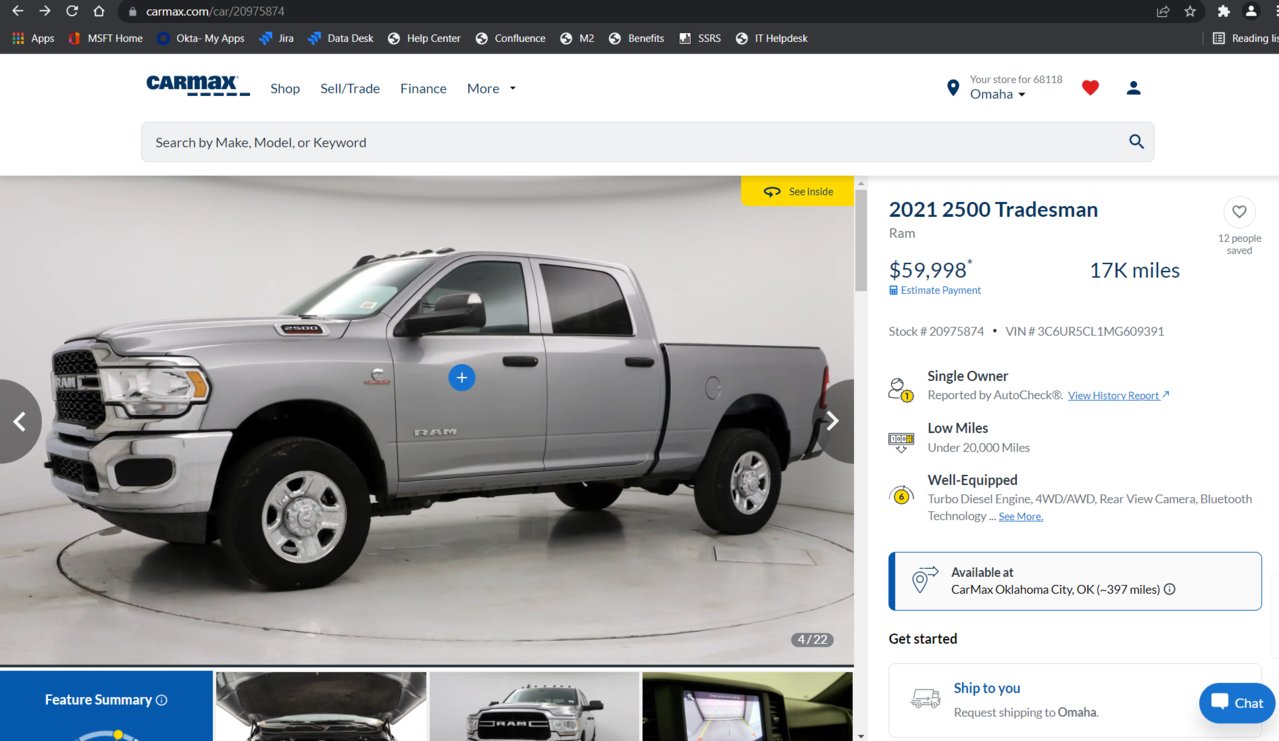

    Tow whatever you want with this thing. I'm hesitant to buy anything the first year of a re-design, especially the Tundra (not that I'm looking - happy with my Taco). If anything happens to my Taco a diesel is what I am going with. Surprisingly, CarMax has a decent price for this trim level. Get you a Carli Suspension, have Steve Goerend rebuild the tranny and you are set. It even has the manual shift transfer case which is getting harder and harder to come by. Sure it is a Dodge, but that Cummins will pull 20,000 lbs. Sexy, aside from the fin that American auto makers insist on sticking between the roof marker lights. Fucking yuck!

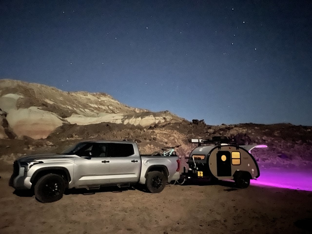

    I towed this ~2000lb TD and was getting about 13.7mpg according to the dash on a 350mi trip from the mtns in CO to Moab and doing about 75-80mph. Towed like a dream as I couldn't feel it but that mpg was no diff than my 5th gen 4R which was odd.
