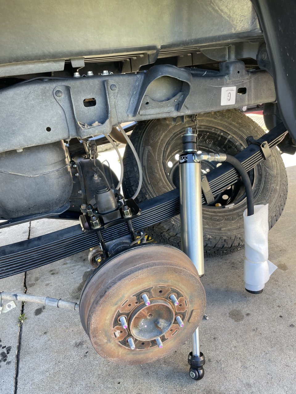

    Paquo d Taco
    Paquo d Taco Member
    May 25, 2021
    #366714
    21
    2020 DCSB Cement TRD OR 4x4 Advantace Technology
    It worked!!!!:bananadance::bananadance::bananadance:

    Paquo d Taco
    Paquo d Taco Member
    May 25, 2021
    #366714
    21
    That might actually work.
    Thanks.

    Paquo d Taco
    Paquo d Taco Member
    May 25, 2021
    #366714
    21
    So for the bushing. The sleeve will be cut/grind to fit.

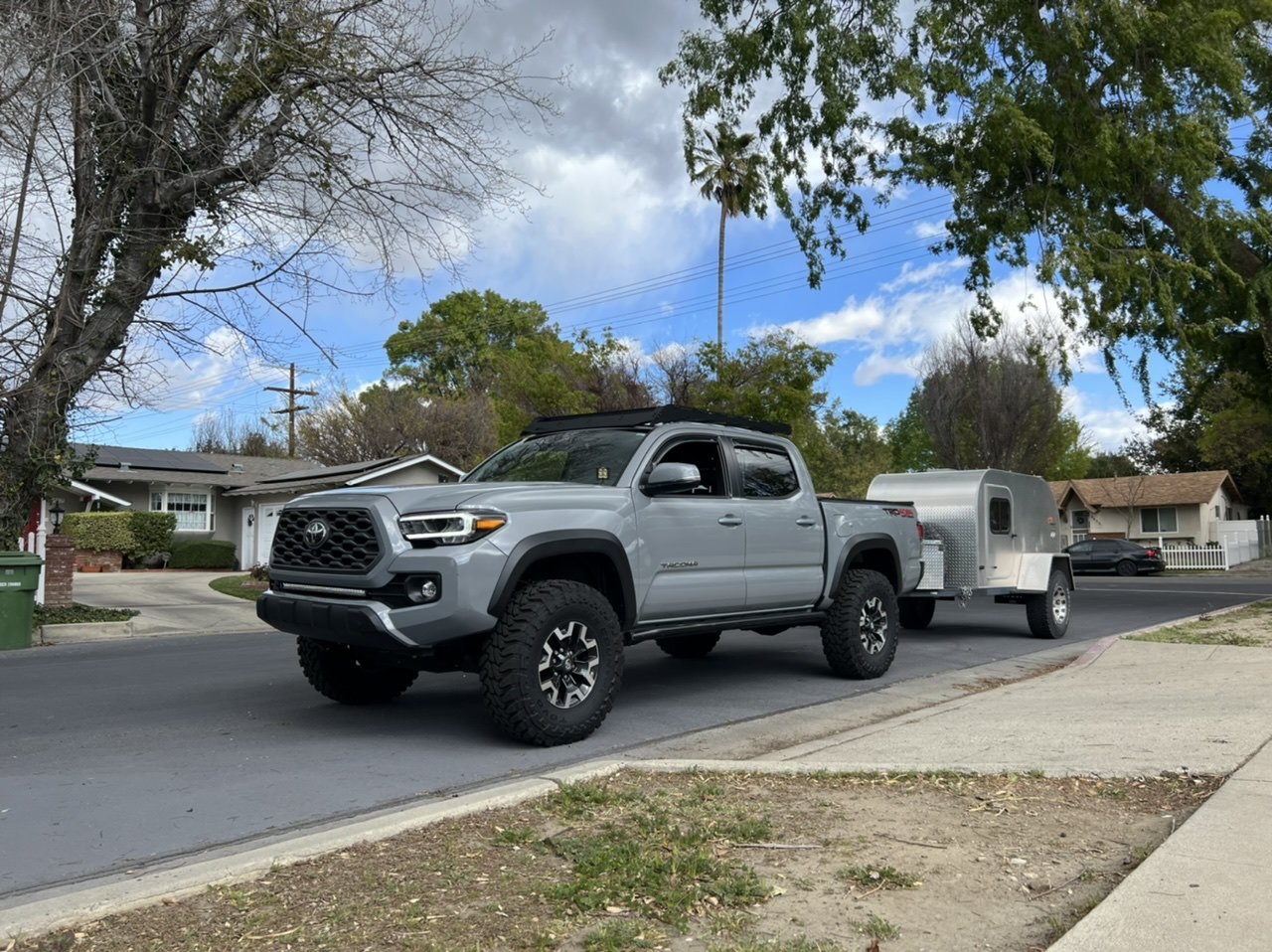

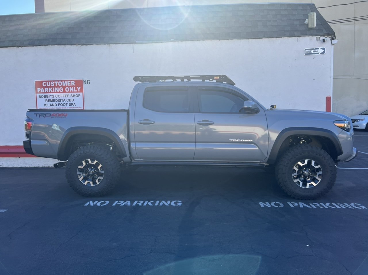

    Paquo d Taco
    Paquo d Taco Member
    May 25, 2021
    #366714
    21
    The grinding and reorientation was easy. Yes, I did get DSC on my shocks. There was a comment that the valving might be different since its for a Tundra but it didnt worry about it since the shocks are adjustable. I am running this setup with Deaver stage 1. At softer setting, its bouncy. I have no way to compare it with the Fox shocks for Tacoma. Rides well both on and off road. I guess as long as it is adjustable it will be fine since you will be able to dial in your shocks to your liking. I have full skid, sliders and steel rear bumper. Also, I have an off road trailer too.
    disgrace[QUOTED] likes this.
  14. Mar 11, 2022 at 5:53 AM
    #34
    coma toy
    coma toy Off Road Taco
    Aug 8, 2017
    #226322
    937
    Dude, he's absolutely right.
  15. Mar 11, 2022 at 6:49 AM
    #35
    c_walters
    c_walters Well-Known Member
    Nov 26, 2010
    #46742
    524
    Mooresville, Nc
    2019 TRD Sport 6MT MGM
    I believe he was talking about gaining an inch of travel not lift with the shocks
    79CHKCHK likes this.
  16. Mar 11, 2022 at 6:51 AM
    #36
    Paquo d Taco
    Paquo d Taco Member
    May 25, 2021
    #366714
    21
    That is why I went with the Tundra shocks. The Deaver leaf pack give 2 inch more and the inch of travel gained from the shock to compensate.
    coma toy[QUOTED] and disgrace like this.
