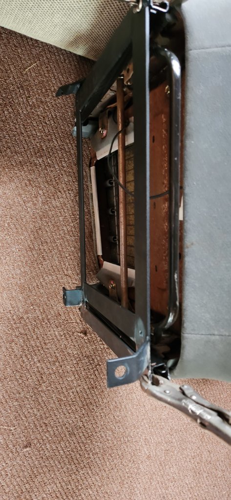

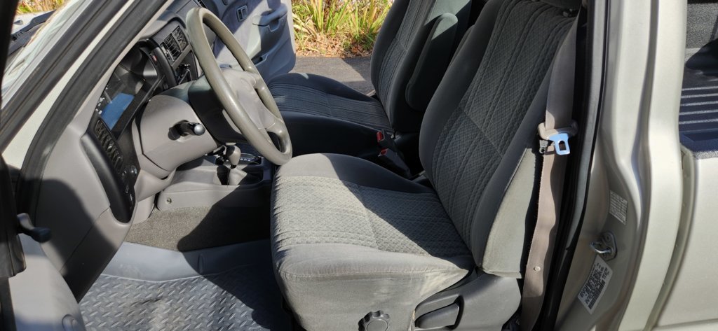

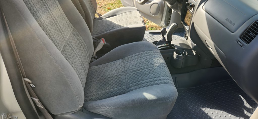

    20240518_130820.jpg 20240519_085013.jpg Recentl20241106_135320.jpg 20241106_135243.jpg y took out my standard bench seat and installed new bracket and 20240518_130820.jpg modded it to fit tundra seats. Had to purchase a welder and opted to use one that was a new style hand held one. The original owner of the seats which I purchased from looked puzzled when I told him they were going to be installed in my single cab Tacoma.I like some challenges when modded any of my personal vehicles to my taste.Let me tell you that removing the original mounts on the tundra seats was a pain in the ass.I had to add another length of steel to the brackets that were made for me by a company that make custom brackets for super high end seats $$$, which I cant afford. Let me say that I have a better view looking out and still have a little headroom. Oh yeah seat belts had to modded as well because tundra ones were different(sorry no pics of that)20240518_130820.jpg

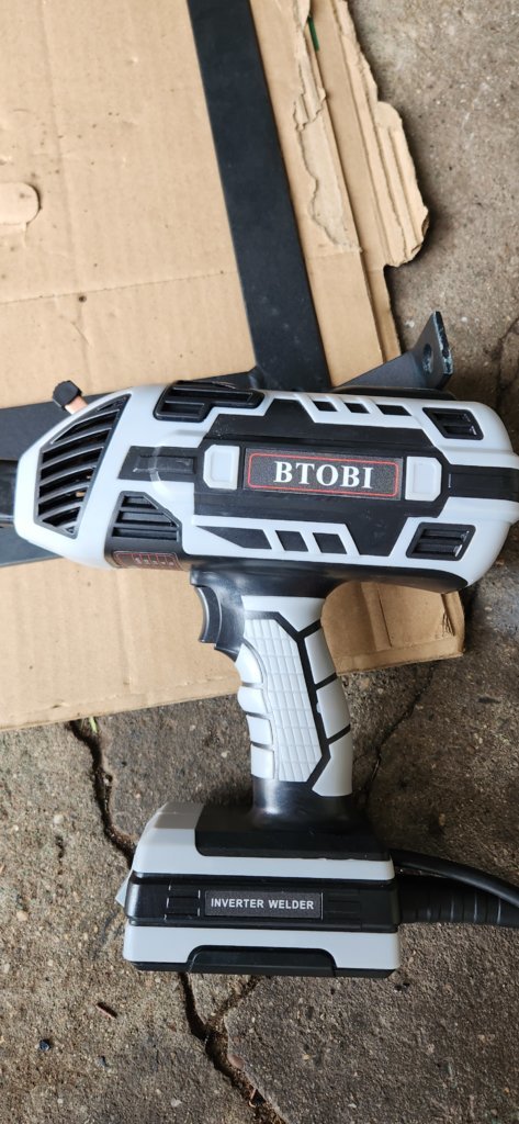

    Are those Corbeau brackets? How did that welder work? What did you weld?

    Wedge brackets, one piece of flat steel on bottom of pic (looks like double or 2 rows),that welder was a game changer for the price picked it up on offer up for 75.00 barley used...did buy a welding helmet from harbor freight :0

    Scheel-Mann seats was the bracket that was made for me and I modded it to fit Tundra seats because I knew they were the widest ones.

    Hard for me to tell from the photo. Do you feel like that inverter welder penetrated the steel well enough? I am just curious about how that tiny welder works!
