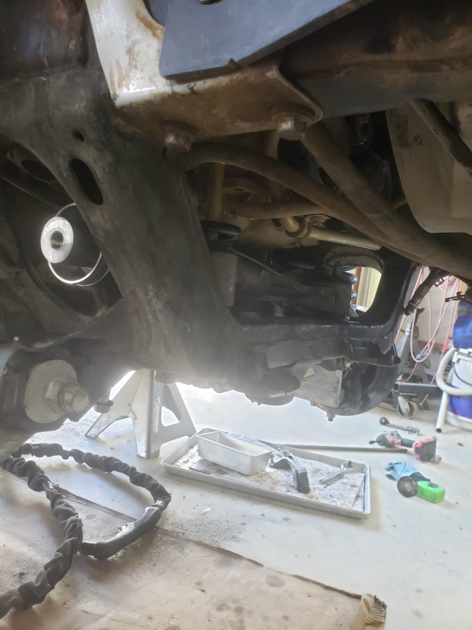

    Just finished installing @Mademan925 rack into his truck. Now that I've done it into another truck I got a better baseline for creating a template/guide for where to locate your holes and stuff and be able to offer a fit kit with the racks

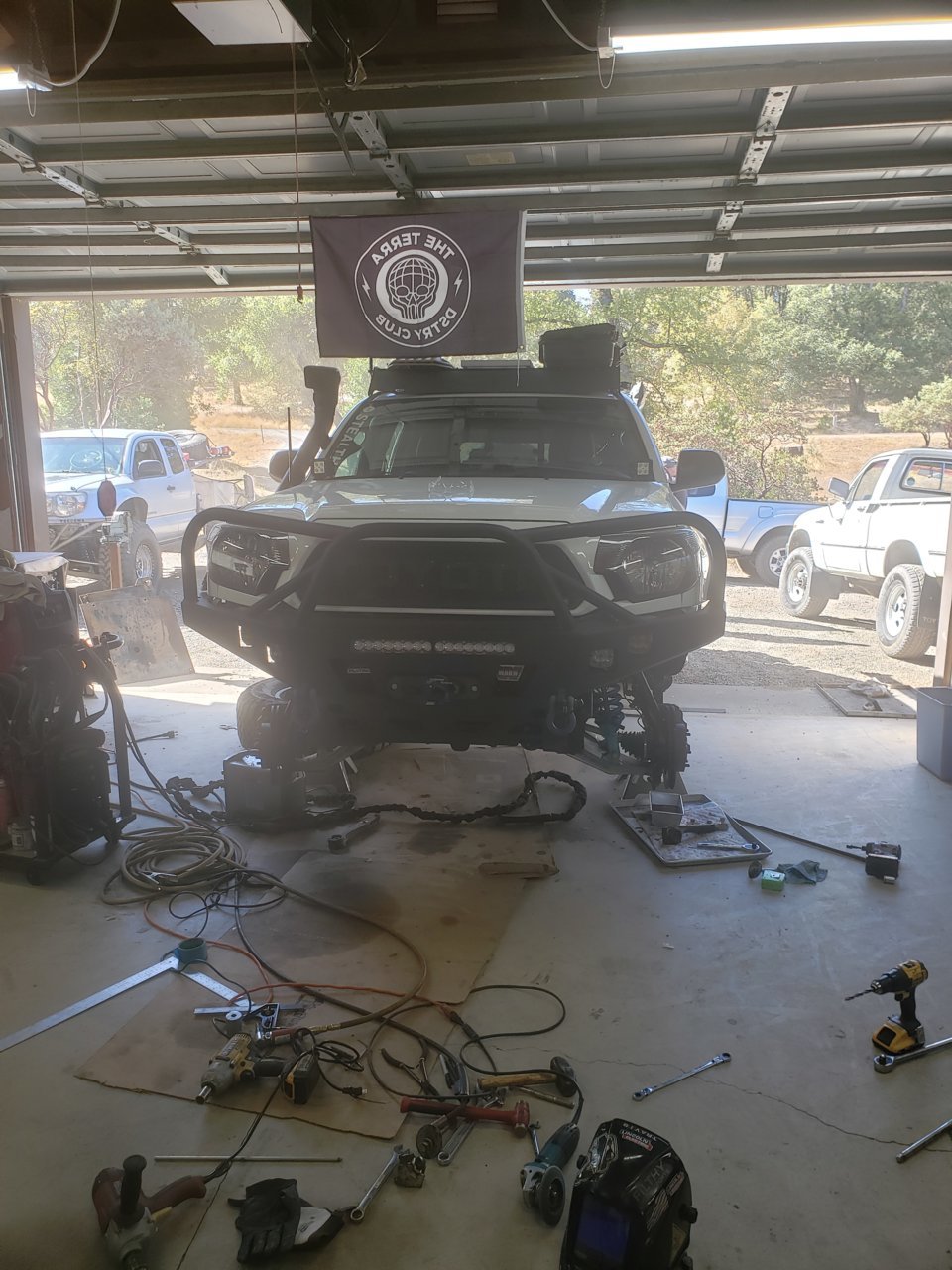

    This is my review of the install and rack so far.
    Size comparison
    Travis and I met up at 8am yesterday and by 9:30 I had the old rack out. Travis then cut the old solid frame mounts for the rack out of the frame. Then he plated the upper side of the holes.
    Then he mocked up the new solid mounts on the tundra rack and then on the frame.
    He then cut a hole for the mount and sliped it into the frame. After looks at clearances he tacked the mount in and drilled a hole for the bolt. Then we mount the drivers side of the rack to see if any adjustments need to be made. The he cut a hole on the passenger side and put the mount in and drilled the hole. The passenger side took a couple tries to get the frame mount in the right spot. Then we bolted the rack down and check tolances. Then we removed the rack. Painted the frame. Removed the steering shaft and cut alittle off in the middle.
    Then we bolted it all back in. We were off a few splines on the first try pairing the rack with the steering wheel. The second try got us closer and now the wheel is at 1:30 on the clock dial. The tires are strait and an alignment should correct the wheel. We finished around 6:00pm
    The truck turns like a car. Feels weird at first but I dove 140ish miles home last night and got use to it. I love it so far. Needs some trail testing and and alignment but its great.
    If someone asks if a modified tundra rack fits, Id say no... except in this magical unicorn place on the frame that travis found. Everything is so close. Its literally the biggest rack you could fit by milimeters.
    I went with stock tacoma tie rods for now. I figure it protects the rack and its a cheap weak link thats easy to replace.
    Can you see the bolt under the diff mount bolt.
