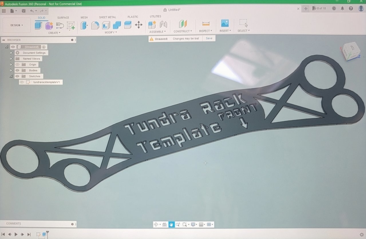

    Will be test fitting this template/guide jig on some installs im doing locally to check my measurements...this will take alot of the guesswork out of doing this conversion and make it much easier for the weekend fabricator to do the install themselves. Once finalized I'll be providing this template with the racks I sell from here on out.

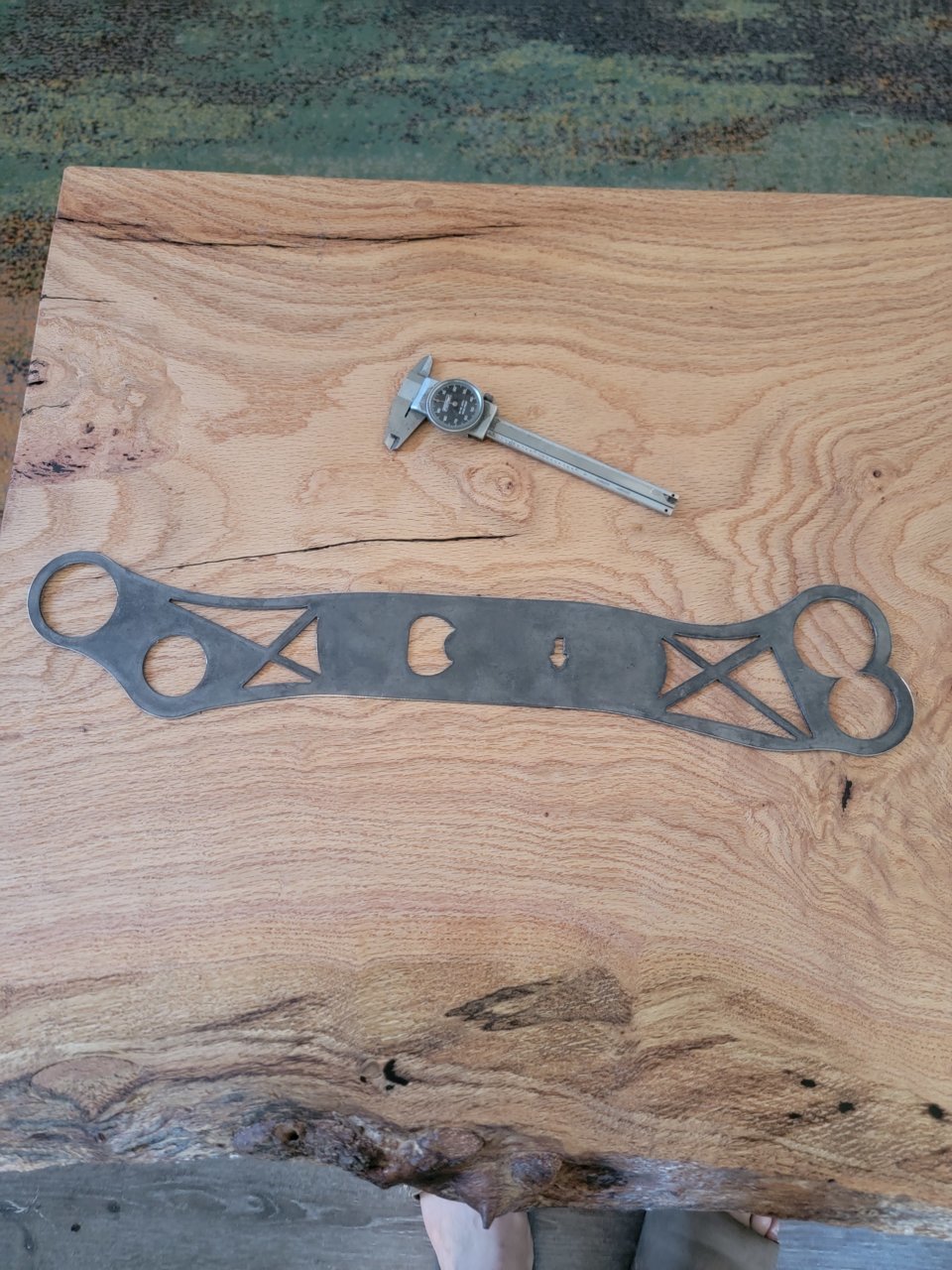

    Well here it is the locating template piece I had mentioned....this will now come with racks ordered through me to aid in locating where to cut your holes for the new frame barrels. This should take a majority of the guesswork out and cut down on the scary factor for you guys lol.
    I hope this will help...if all else fails I included a bottle opener in it

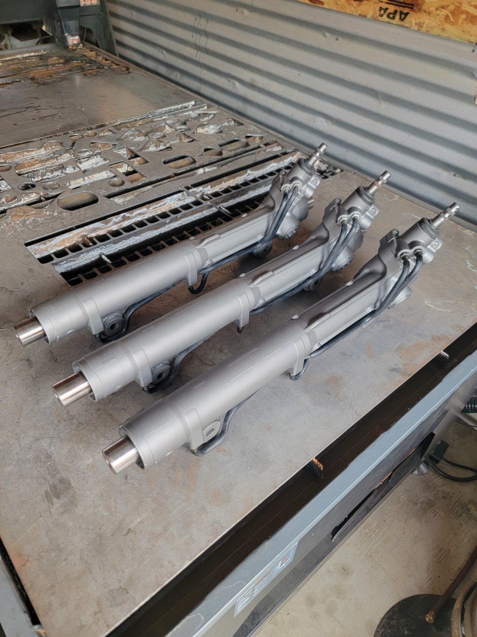

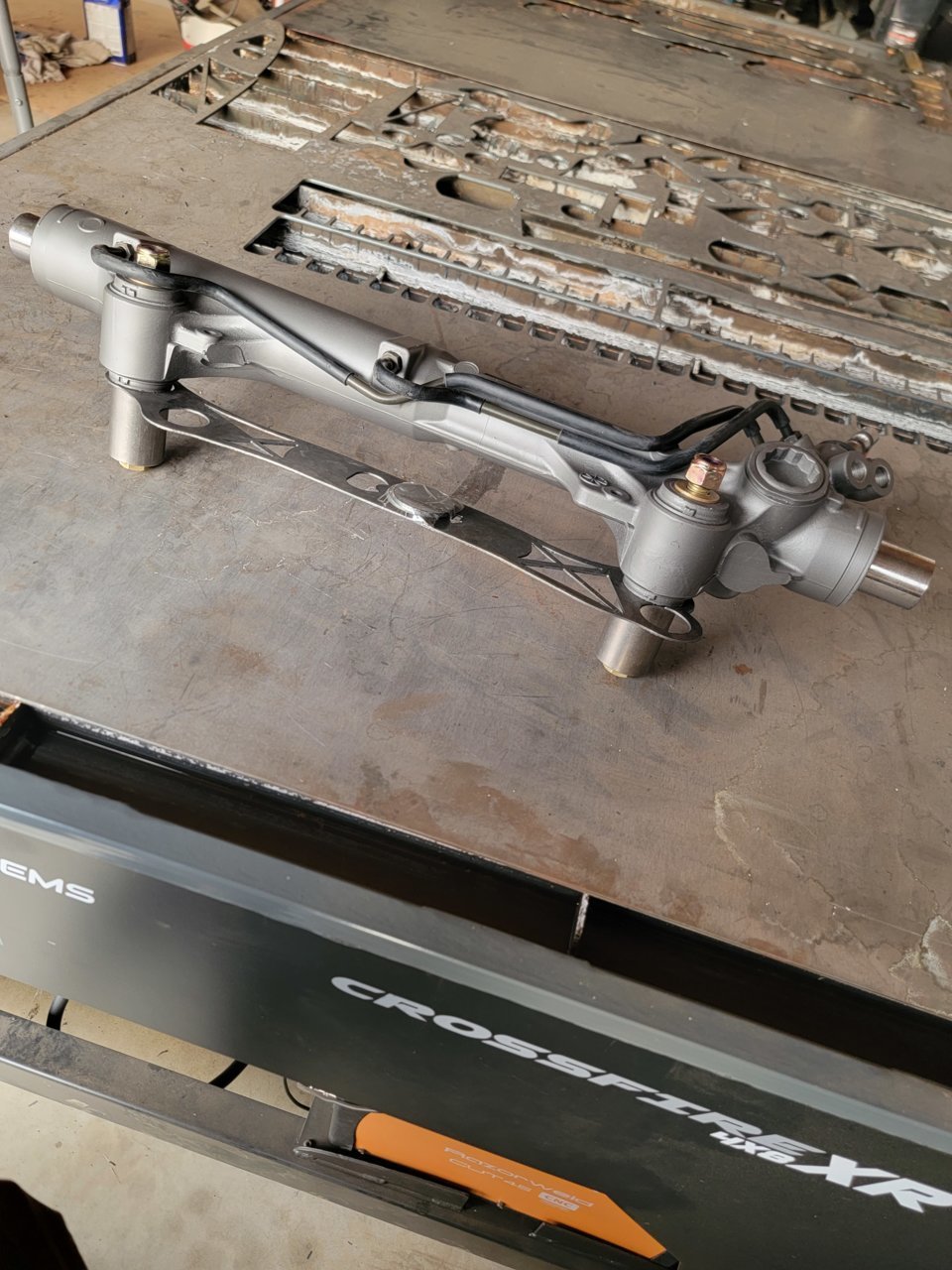

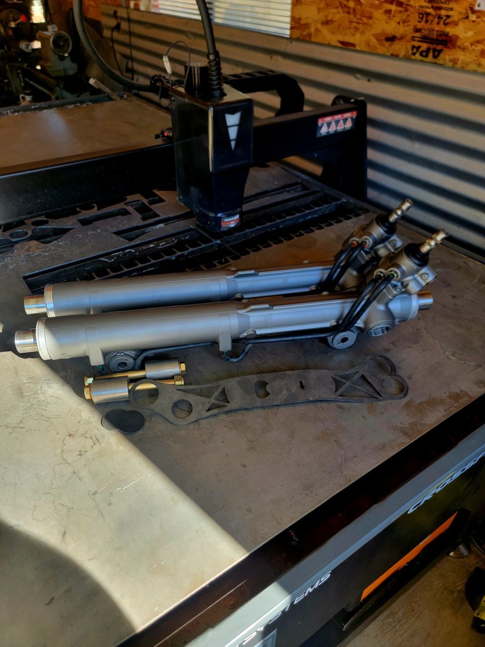

    More racks buttoned up heading to Florida and Alaska!.
    Also a general representation of the parts included with a rack.

    Sick! So I believe I read all the posts, correct me if I am wrong this rack will:
    1- Use the oem tacoma inner and outer rods, am I correct?
    2- The hydraulic lines are direct bolt on?
    3- the input coming from steering wheel must be welded for to match splines in the tundra rack.
    4- what’s the current pricing?
    keep up the good work dude!
    Idahotacotruck and Basikbiker like this.
  19. Sep 8, 2022 at 10:45 PM
    #59
    Basikbiker
    Basikbiker Well-Known Member
    Sep 21, 2013
    #112968
    3,986
    Trav
    09 AccCab 4x4 spaceship
    My doors are the only stock things left besides the headlights
    1- yes
    2- yes
    3 - input splines and stuff are the same but the steering shaft is generally too long and needs to be shortened about an inch.
    4- 1300$ plus shipping, comes with everything in that last picture and a installation guide.
    im working on getting another run of them together PM me if you want to get in the next run.
    typical lead time is 3-4 weeks.
