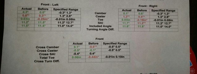

    I'm gonna do some hub to fend measurments tomorrow but I'd say about 3 to 3 1/4 and yes they are set at 0 alignment went well to I have pics of the sheet

    Caster Is a little off but it was the same with my 2in spacer lift here's a pic.90zjhx_ebf57438f2e39a8de1dbe458c1d7aefbbcd8d94a.jpg
