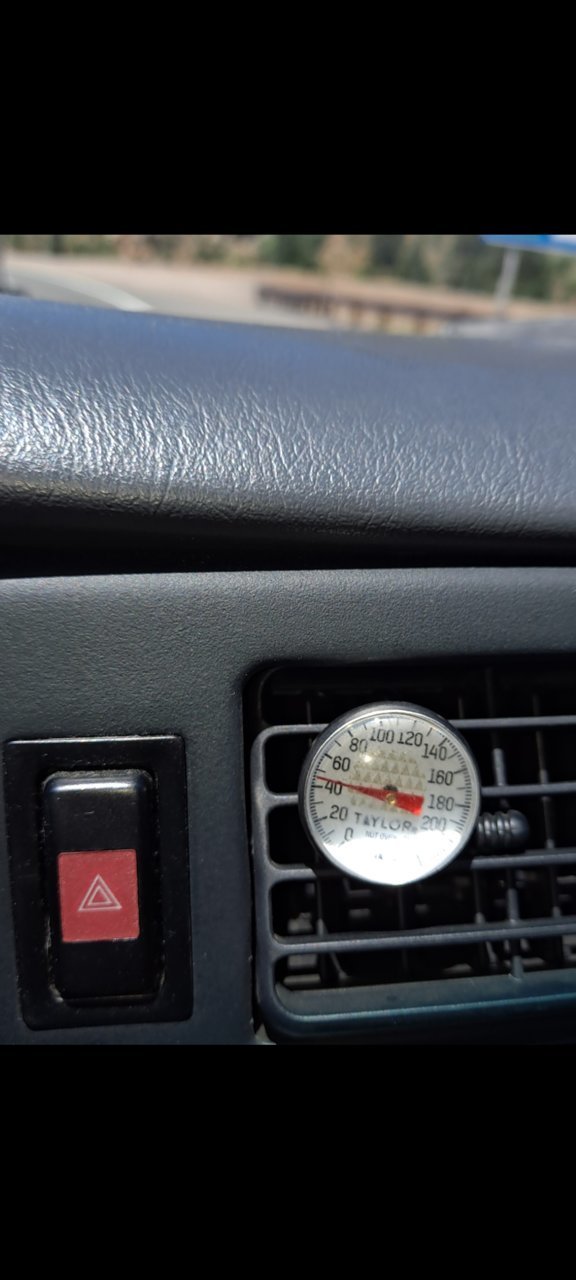

    This might be one of the dumbest posts ever, but I'm willing to ask anyway. I have a 1st Gen Tacoma, 2002, 3.4 engine, and the A/C system has been below par since the day I bought it new. My friend has a 2014 Tundra with a A/C system that could freeze a side of beef no problem.

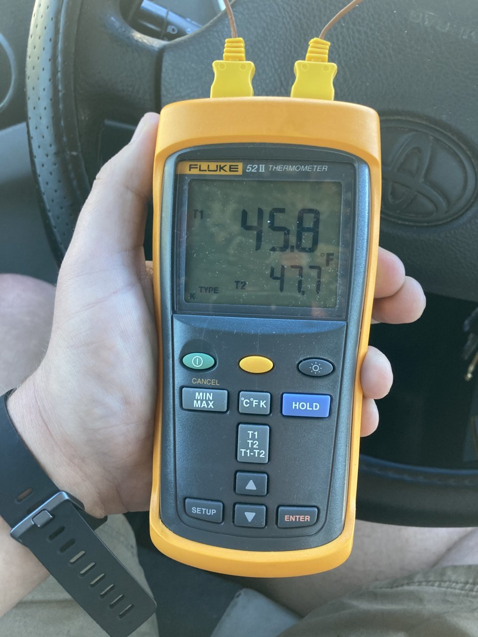

    I’m at 45 degrees, the AC condenser shuts off at that temperature for me, the big difference is the 1st gen Tacoma don’t have as big a condenser, a smaller grill area.
    you probably have a problem somewhere if you’re at 60,

    Thanks Guys for the info. I think I'll take it to another A/C shop for a recheck. If I could get it to 45 like (1997tacomav6) has I'd be happy.

    They should easily get to 45. I’m wondering if you have a blend door issue.

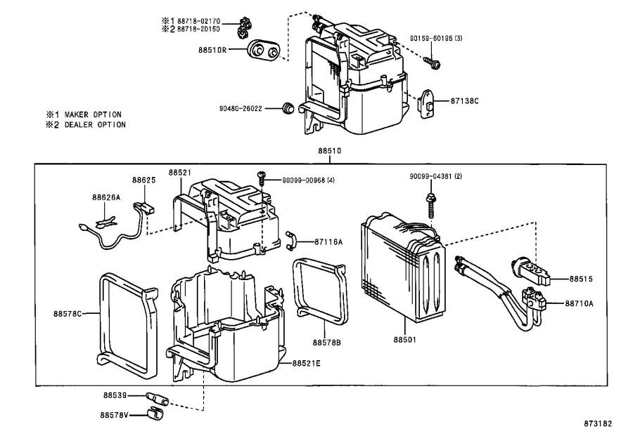

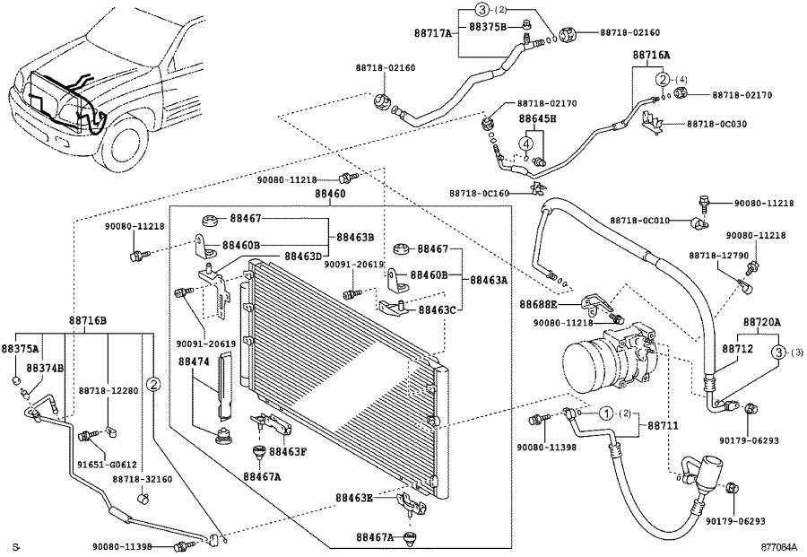

    To answer one of the OP's questions - My '96 base-model Tacoma did not come with AC. So I installed a whole new system, using new and used parts. Nearly all the AC parts are vehicle and engine specific. On my Tacoma, one AC hose will interchange with a '90s 4-Runner, and the little AC push-button switch will interchange with several '90s Toyotas. Most everything else has to be for a 1995 to 2000 4-cylinder Tacoma. At one point around 1997, the high & low AC hoses design was changed. So you need both hoses from the same year, not one hose pre-97 and one post-97. Otherwise, butchering a '90s Tacoma or a part from a different Toyota to make something fit is simply not worth the trouble! By the way, my Tacoma AC output is below 50F, and a bit slow to cool on extremely hot days if parked in direct sun. But after several minutes, it's fine.
