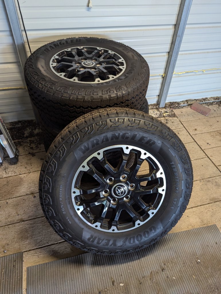

    Hello all, been awhile. So my delima is I have a set of 18 in tundra wheels with 265-70-18 tires. I would like to install them on the 23 Tacoma, but the tire hits the upper control arm. Is there a way around this? Thanks Lance

    Isn’t the hub bore on a tundra smaller?

    The latest version Toyota trucks all have very positive offsets... these rims will be in the 53 to 68 mm offset. Your Tacoma came with wheels that had approx 30mm offset. So the only way to mount these is by using a spacer. (Tacoma TRD Pro were +6mm offset)

    Just as important. Will these tires clear, while turning? You going offroad, or is it a "highway princess," look only "pretty?"
