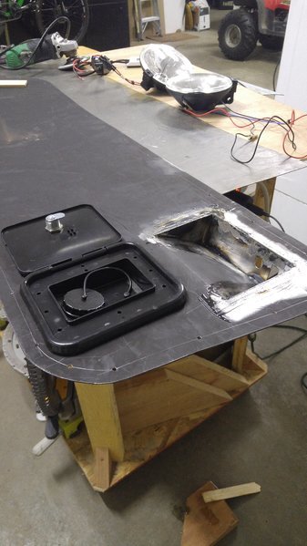

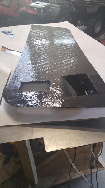

    A little work on the panel since the water filler arrived!

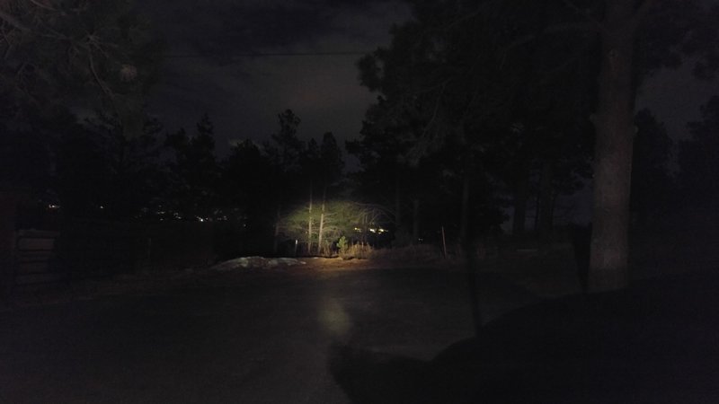

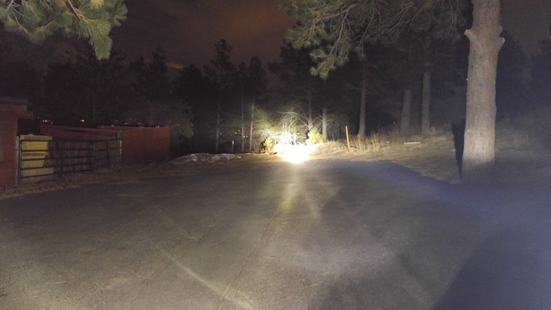

    And a quick halogen vs hid test.
    Lights weren't mounted to anything and just cell phone pictures so i think it over exposed the hid one.
    But the hid definitely has more distance!
    Trees are at about 150ft.

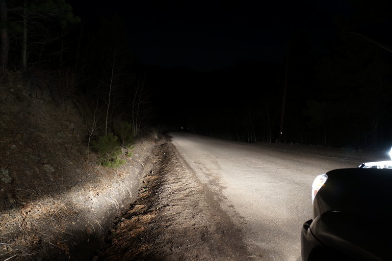

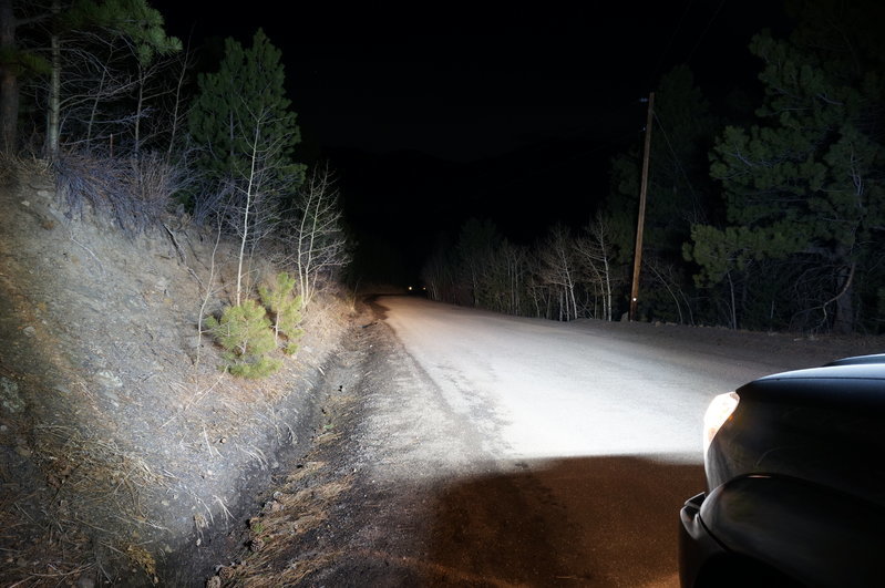

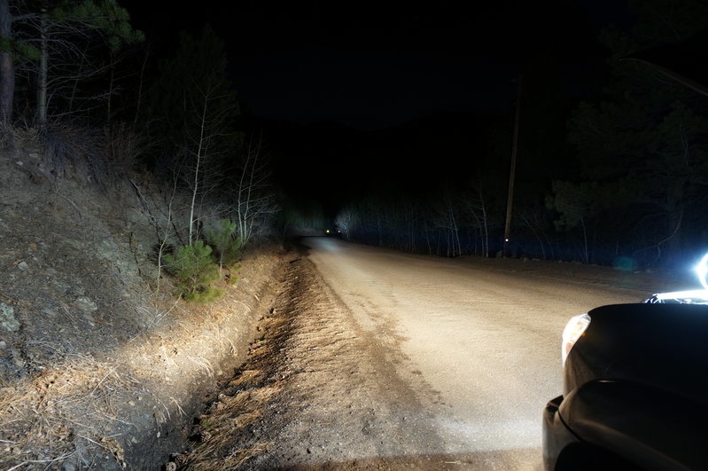

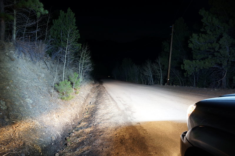

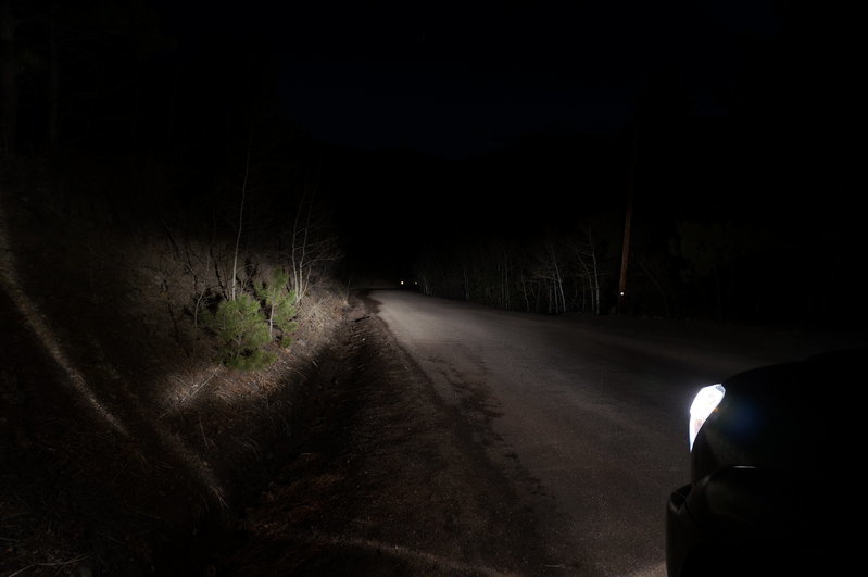

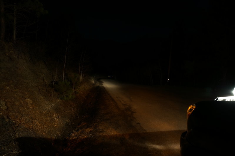

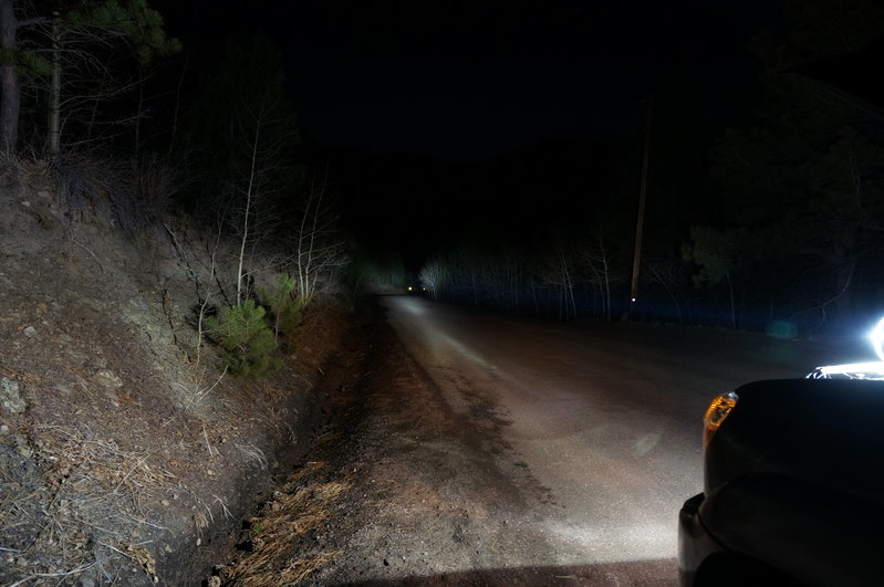

    Some better light comparison pictures.
    Stock low/high beams (just realized the fogs are probably on since they always are)
    Light bar - Cheap Amazon 42" spot/flood combo LED light bar
    Halogen Driving - Hella 500ff light with the bulb it comes with
    HID driving - Hella 500ff light with a 55w 5000k HID bulb in it
    Driving lights: http://amzn.to/2muvpvl
    Light bar: http://amzn.to/2mSryLa
    HID kit: http://amzn.to/2np1MLk
    The driving lights are a single 5" light each...wanted to get the pictures done so I could modify the second light for the HID.
    The road is straight for about 500ft then turns to the right slightly. The signs near the middle of the picture are near 1,000ft away which is where the road turns.
    Low Beams:
    High Beams:
    Light bar and lows:
    Light bar + high:
    Halogen Driving lights only:
    Low beams plus halogen:
    HID driving light only:
    Low beam + HID driving light:
    So, the HID definitely adds some distance. I wish it had a little more spread out at the distance, but then again, its only one light so if you double the coverage, it'd be pretty good for a 5" light.
    I was going to do a HID + high + light bar, but the hood was up for a place to set the HID so maybe next time.

    Painted... :p
    Would have the gloss black wrap.. But wait, usps decided not to deliver it, and i didn't think they'd close so early on Saturday. So, i wait.
    The screws will be all exposed, and i want it to look like a window, not obvious screws all around it.

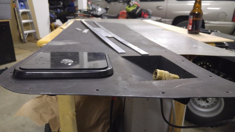

    https://www.albanycountyfasteners.com/
    Nicely laid out site, very easy to find what you need.
    Ordered plenty of screws along with two taps for the aluminum pieces lying on top of the panel in the picture. The aluminum strips will be on the inside of the topper, and threaded to allow the removal of the panel if needed for future changes/mods to it. I drilled a ton of mounting holes, but will be skipping every other one on the top and bottom (there will still be just under 30 that will hold the panel on).
    Two different cameras ordered as well to see what works well with the camera adapter.

    Wrapped it.... Put spray contact cement down to make sure it stayed on there. But, so much for a smooth finish!
    So I'll probably just paint it at some point, but it'll work for now.

    Yeah... i should've just put it directly on the panel instead of trying to glue it. Figured i could smooth it out but nopers.
