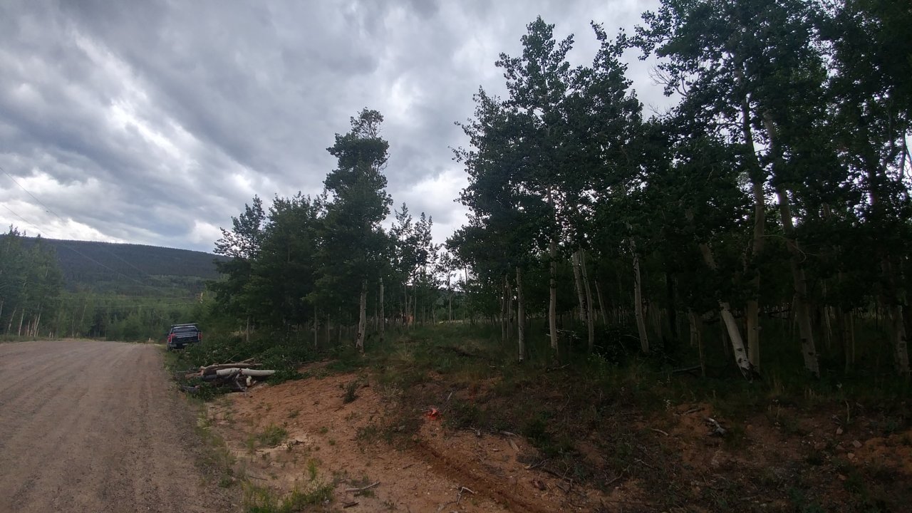

    Driveway chopped in for spec house.
    And set aside a bunch of nice looking aspens to use for decoration or as a divider wall in the master in mi casa.

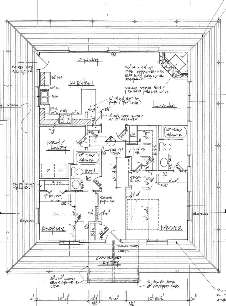

    Might be a plain box but i like the layout. I sent him a bunch of revisions, so hopefully it'll be ready soon.
    Yeah, 2bed, figured i might as well, It's only a few more pieces of wood.

    Don't think I have ever seen interior Doors numbered like that, I am guessing that's a size or model?
    I would work on the Mechanical/ Laundry room layout, seems some wasted space poor layout.

    Whats the boxed in area next to the master shower/bath?
    If its just void space, I'd say open it up into the closet and put a safe in that corner.

    That's just a boxed area if there was going to be a tub. But it'll be a shower so it's going away as well as getting bumped into the living area by a foot.

    Move window in front of pooper for optimal viewing pleasure.

    Standard door sizing for the most part. 28x68 is a 2'8" wide by 6'8" tall

    I agree with Steve. At least flip the door swing on the mech/laundry room.

    It wont work with the closet door.
    But he could swing it lh against the other wall.

    I want to have a little workshop/workbench area, so I'm going to be making that a multi use room...it'll be cozy by the time everything is in there.

    Yup, a bunch of doors got switched, no barn doors, no pocket door, no wall on master bath, no master closet door, no rear door

    This'll be the bathroom wall between bedroom

    That’s what I meant. Still in swing but hinges on other side :thumbsup:
