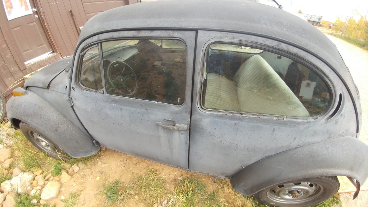

    Adios two layers of bubbled purple tint... Looks like a new car already.

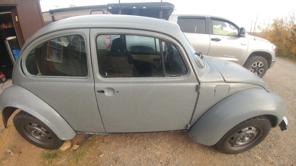

    So today I rallied out a coat of paint early...which was clearly too cold for the paint. With the rustoleum type stuff when you roll it on, there are little bubbles that go away, but they don't do it in the cold. So the passenger side has a little extra texture.
    Not a car show paint job hence the drips on the windows that I'll scrape off. But i used a hair dryer as i painted the last coat and it was much better.
    But you can surely get a nice paint job with the roll on if you take your time, wet sand it at the end and polish it.
    This was the Ace brand of rustoleum since that's what they had... Thinned it down with mineral spirits, I'd say 6:1 or so.
    Foam roller and brush.

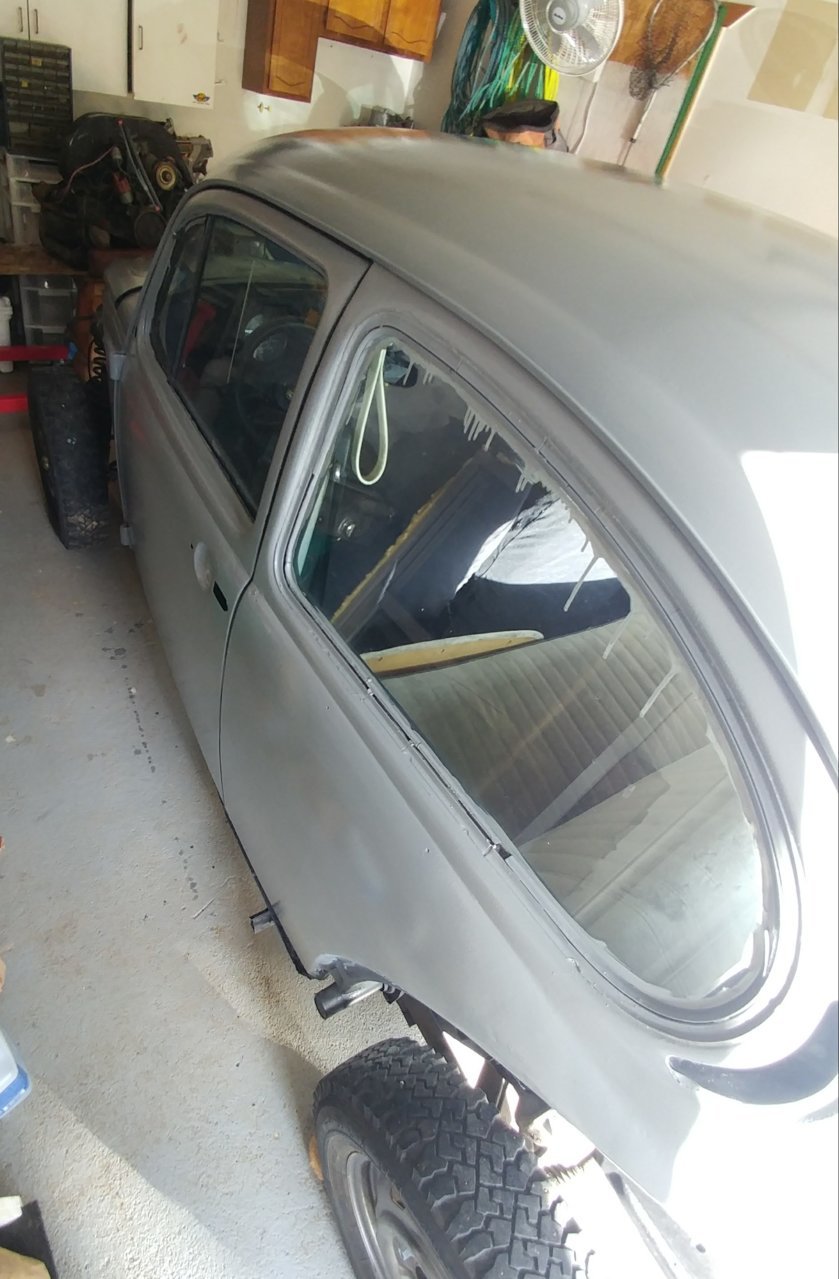

    Haven't updated on this thread in a minute..
    Pulled the bug engine, leak was coming from a jb welded spot that was done by the engine builder 45k or so ago.
    Options were to get a new case (expensive since this one is bored out and such) or re jb weld It. I opted for the latter. Hopefully it works for a while, if not I'll have to swap the stock one in.
    So it's almost reassembled, waiting on a 12pt torx to pull the cv's to pull the trans that is covered in oil as well.
    Got it painted, reassembled and the pin stripes arrived today.
    I was shooting for them to be darker than the paint but oh well, i think it works!
