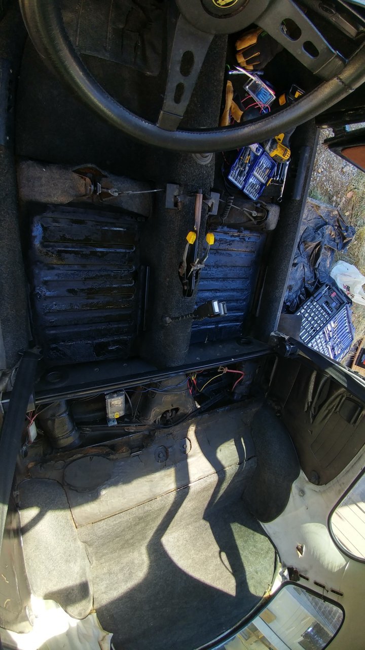

    She runs.
    I need to work on electrical, I think I did not wire something correctly as the drivers side headlight is dim and the rear lights... no workie correct. I have turn signals and no running lights. Not sure about brake lights.
    And shes going from 24's to 27s... Firestone Winterforce tires for $230 shipped. Not bad at all. Exhaust is on its way as well.

    Got all turn signals and hazard lights, good start.
    No running or brake lights and only a half ass attempt at the drivers headlight.
    Trying to trace wires back to their origin and test for continuity.
    The old fashioned exposed fuses are special, and what a rats nest.

    2014 TDR Off Road
    Enough to make it a lot of fun!
    Are the brake lights and running lights grounded properly. I had issues with mine at one point and it ended up being the ground.
  9. Oct 21, 2018 at 3:53 PM
    #2069
    Stig
    Stig [OP] Resident smartass
    Feb 22, 2015
    #149340
    13,182
    Brandon
    Ta no mo
    They each have a dedicated ground from the body of the lamp to the body, so that should be good.
    The battery is pretty dang old and no longer wants to hold a charge whe even with a charger, so can't do much troubleshooting until i get a new one.
    I was trying to see if i could jump the brake wires at the switch with no luck when i realized there wasn't enough power in it to even power an led.
    Hoping that the dying battery was the dim headlight issue.

    Remove the ground wires from the body and make sure there is no rust or corrosion.
    Shine em up and reattach.
    Was and still is a very common problem on older Chevy's.
    Stig[QUOTED][OP] likes this.

    Mainly trying to find what's blowing the fuse and hopefully that'll solve the rest. :fingerscrossed:

    Pulled the cables off the battery and had it charging... Reconnected and it has enough juice for some lights but won't turn it over.
    And the range finder thing i have only lights up 6v (measures continuity, and voltage in certain ranges, 6, 12, 24 etc). It's a 12v car. So i guess it's time for a battery. It's a group 42, was hoping it was 24 so i could just steal one off the camper for the time being.

    Ya get the battery. But when I had the tail light issue mine had the dedicated ground then and now and still had issues. It ended up not being a clean connection so I would still check those grounds.

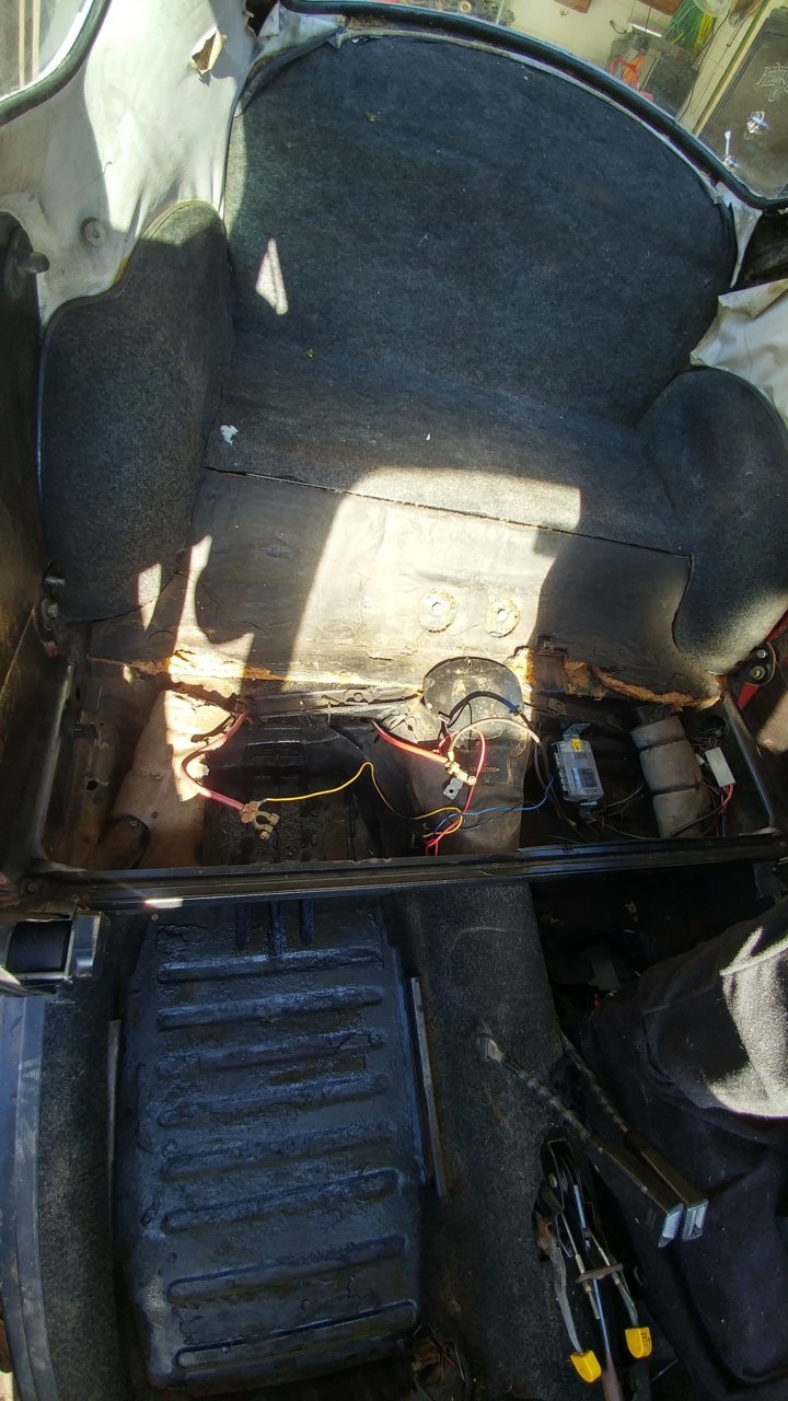

    Battery installed, cranks great, headlights work.
    No spark. What a dumb bitch. It was running beautifully before. There was a fuse under the rear seat that popped out and literally disappeared. Don't know what it was for, how big it was and where the hell it went. Tried fishing with a magnet, no sign.
    And right side ruining light and brake light fuse pops when i turn them on.
