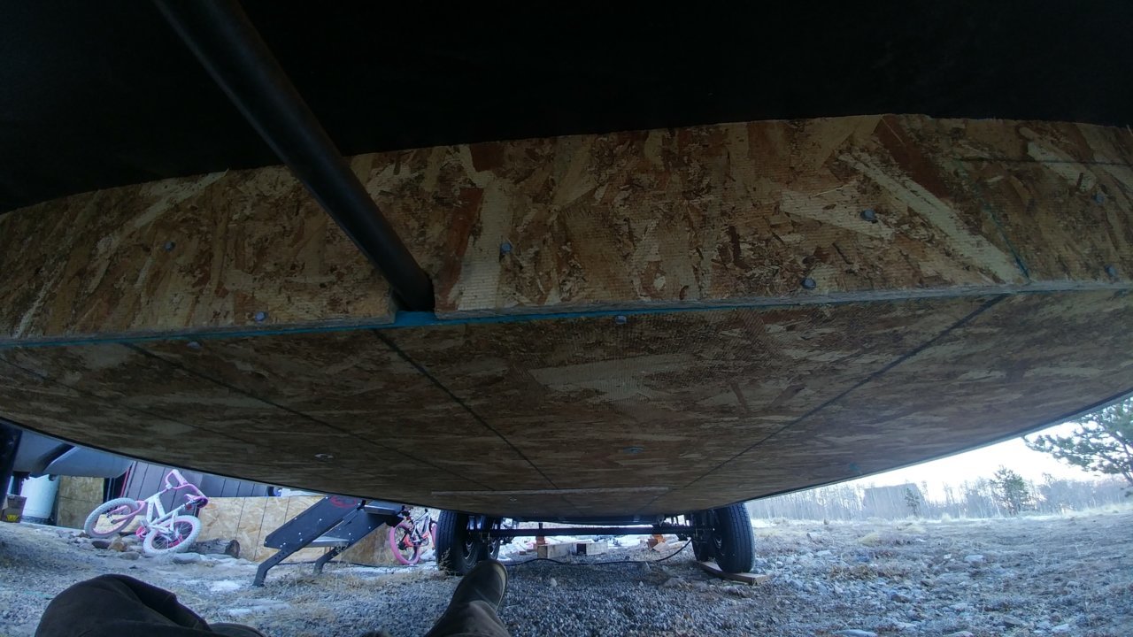

    The floor always seems to be the coldest. I'm sure there was a little insulation on top of the plastic sheeting stuff... But boxed out between the frame to add a little more temperature buffer. Needs some more screws and bedliner to be complete, but i bet it'll help out a bit with the cold temperature swings.
    No insulation in there, just an air chamber of you will. I think it's pretty well sealed (and will be with bedliner even better) but last thing I'd want is moisture in there with insulation.

    Make sure you seal that end around the pipe or beam or w/e that is. Don't want critters or moisture getting in there.

    Yeah I taped it up for now and will finish sealing holes when i get a chance.

    I think the biggest issue, I am no scientist but I work with a butt load of them, is stopping the cold air movement underneath the RV. Most put skirts on their RV's for winter and you boxed it in. But in theory to me, this should work just as well. Just want to prevent "fresh" cold air from moving under the RV. Hot seeks cold to even out and when you are constantly replacing that slightly "warmer" cold air with new cold or colder air it is a never ending cycle cooling down the RV.

    Yup, skirt would be ideal but not really supposed to be living in it where it's at, so the less attention the better.

    Air box seems to have helped a bit... Didn't feel quite as cold with the -15 or so wind chill of last night.
