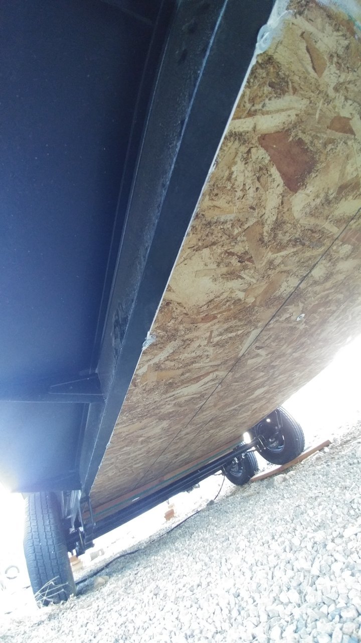

    Whew...
    Rolling around under a the camper all day in the cold lying on gravel and rocks.
    But it's completed. Starting at the axle is where the three tanks hung lower than the frame so i had to box it out and add drops to cover them.
    Going to get it all caulked up, filled the few larger cracks and spots with foam. Whenever the weather decides to get crazy and warm enough for bed liner or a good paint/sealer to dry, I'll throw that on there to make it weather proof.
    Eventual plan will be to cut a couple holes in the floor to access the top of the tank compartments. Where i can open them up to warm the same temp as the interior of the camper..or make the access holes large enough for me to mount a heart lamp on top to keep it from freezing.

    It seemed a lot warmer last night, never heard the propane heater kick on.
    Guessing it's because there wasn't much insulation above the tanks before which is a third of the length. Temps felt like single digits with the crazy wind. There's still plenty to do if i really want it insulated well, but this was a good start.

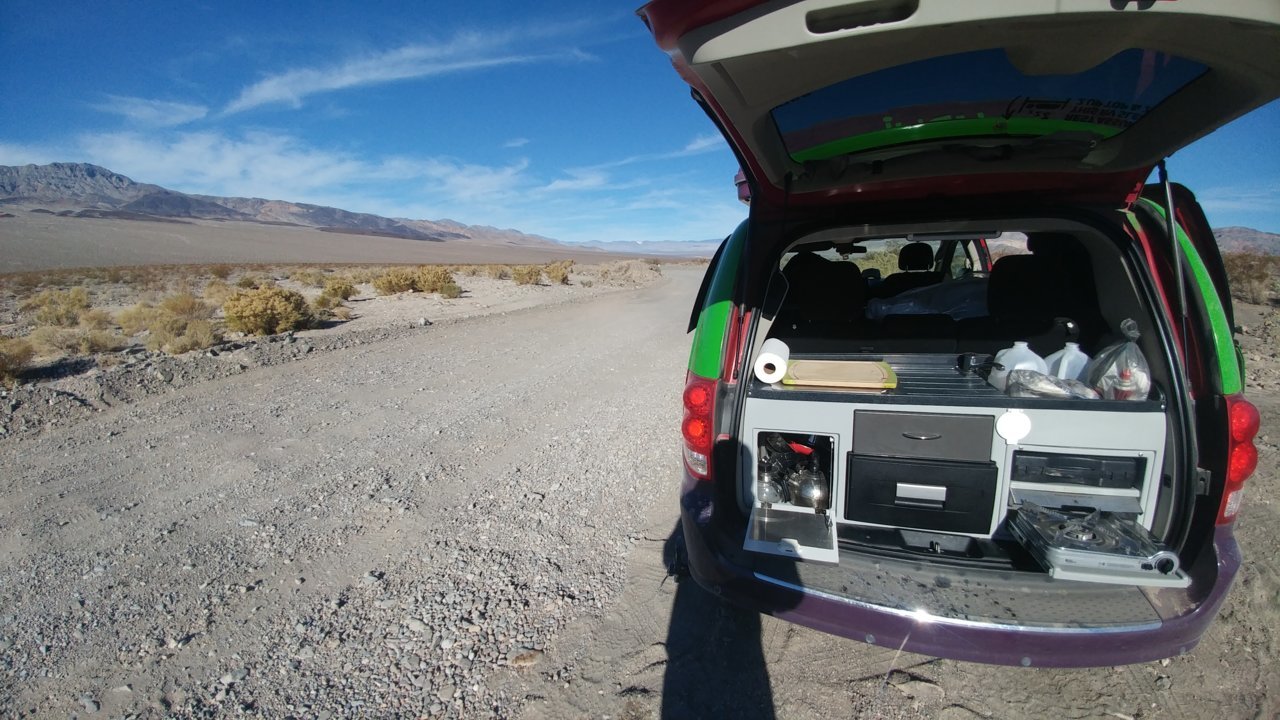

    Death valley was neat
    Rented a van from Jucy... Minivan with a bed/table inside, sink, fridge, stove out back and rtt.
    It worked although was slower on some of the dirt roads. It didn't help that they rented it out with a slow leak in one of the tires which meant finding gas stations to keep it inflated

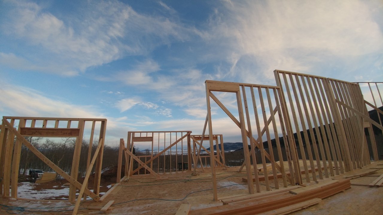

    At least the spec house is progressing! It's a back burner project so it's been sitting for 2 weeks...time to try and dry it in.
    The "feels like" temperature will likely not find the positive side of 0 degrees tomorrow... Along with light snow. Today i don't think it went above zero by much.
    Great day to set trusses they said. o_O i think I'm calling in dead tomorrow.
