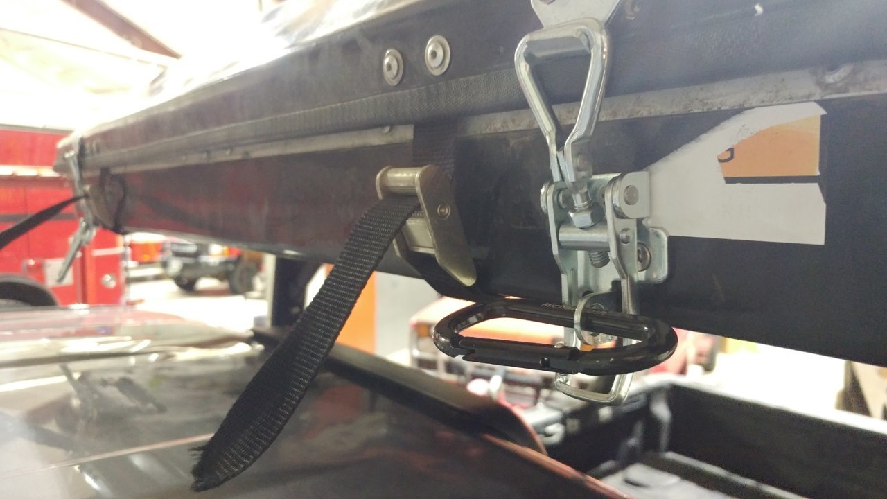

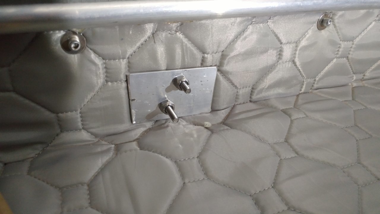

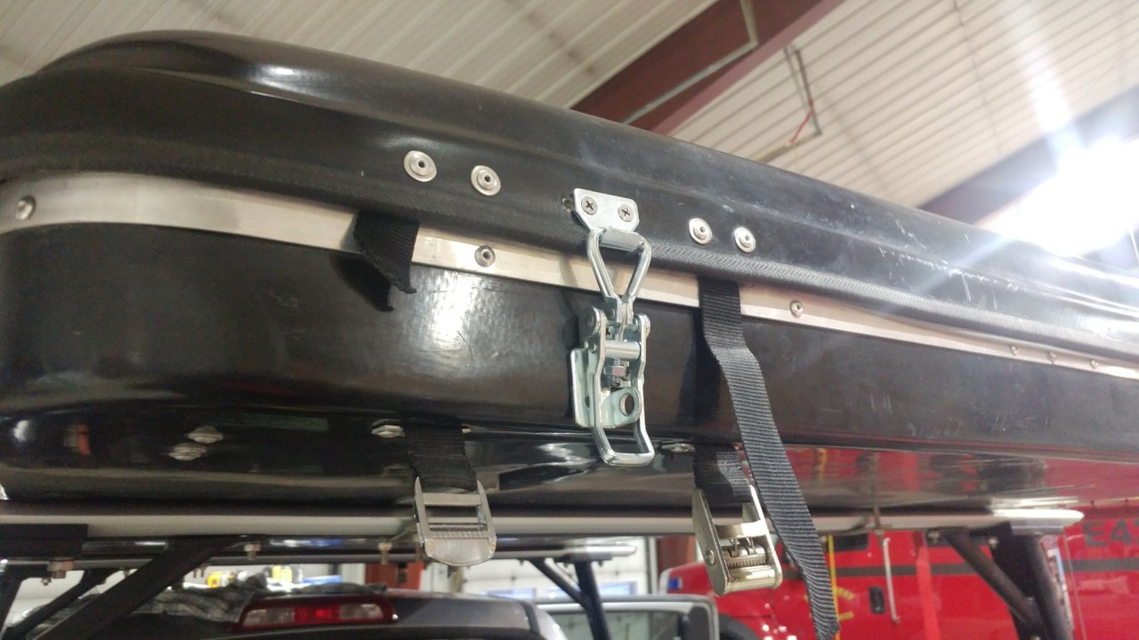

    So I finally got around to putting latches on the RTT
    The one strap doesnt bother me too much, but the second one is annoying as hell when its cold out. In the end, I'd like to only use the latches, but just want to test them out for a while before I completely depend on them.
    I purchased two sets of these
    https://amzn.to/2Cj1COp
    I had to shorten the throw as much as possible and cut off half of the threads that were hanging out the bottom of the arm so it wouldnt fit. Ideally, a set that had an inch less throw would be ideal but then again, with the overhang of the top of the shell vs the bottom, you might not have enough angle to clear that. Of course, with that angle, the latches dont want to naturally stay closed, but that was one reason I made sure the ones I purchased had the spot for a safety pin. There was a carabiner on there temporarily but I bought lynch pins that I can put through there and the ring will wrap around the handle at the same time so it doesn't move.
    Cut the backer plates out of aluminum to spread out the load a little more.
    I tried these first, but the ones Amazon sent me were the correct model number but they didn't have that safety hole for a pin or lock even though the picture shows one.
    https://amzn.to/2sqgUMO
    Deathbysnusnu and w.adventures like this.

    Looking good, can’t bring myself to get a rtt
  10. Jan 12, 2019 at 7:51 PM
    #2170
    Stig
    Stig [OP] Resident smartass
    Feb 22, 2015
    #149340
    13,182
    Brandon
    Ta no mo
    IMO.. Hard shell or nothing. I haven't owned a soft shell, but have been camping with plenty of people who do. I'd rather ground or hammock tent before dealing with a soft shell. And hard shells are coming down in price.
    But my main things i look for are speed of deploying and putting away, lightweight and doesn't kill mpg. I know some people need more space and only large soft shells are big enough.
    Slashaar and Deathbysnusnu like this.
