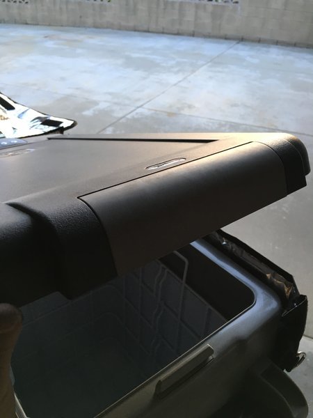

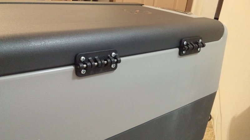

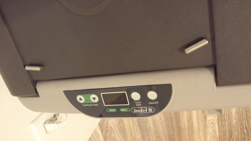

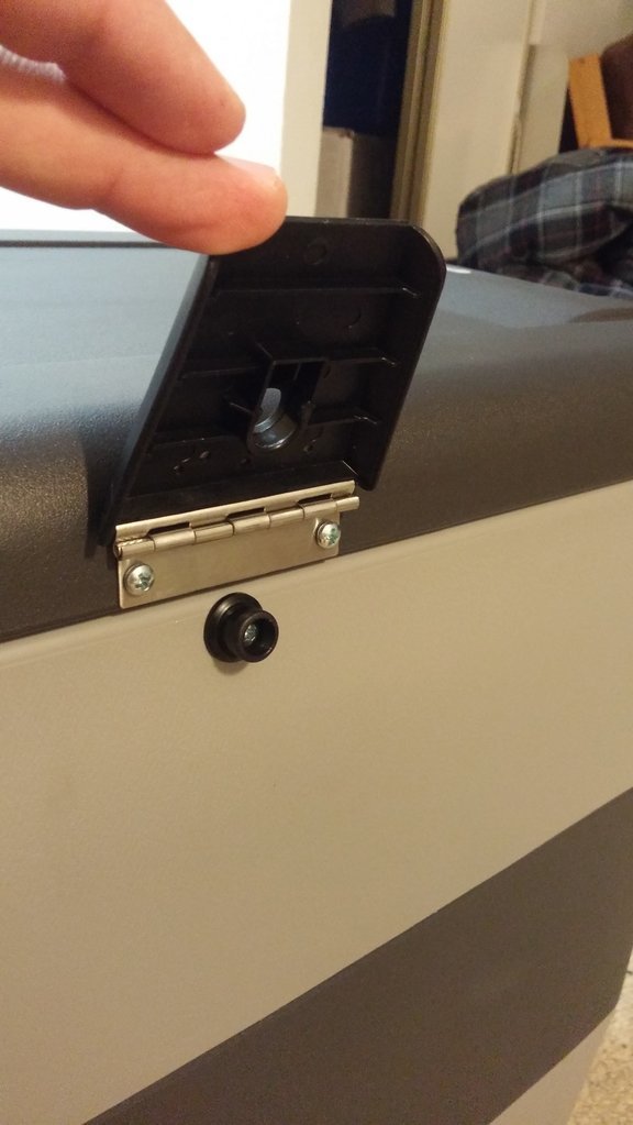

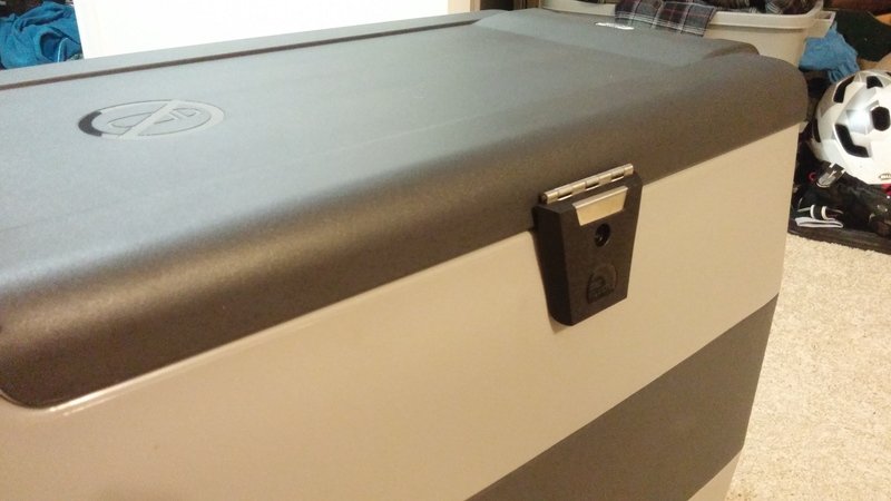

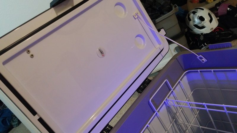

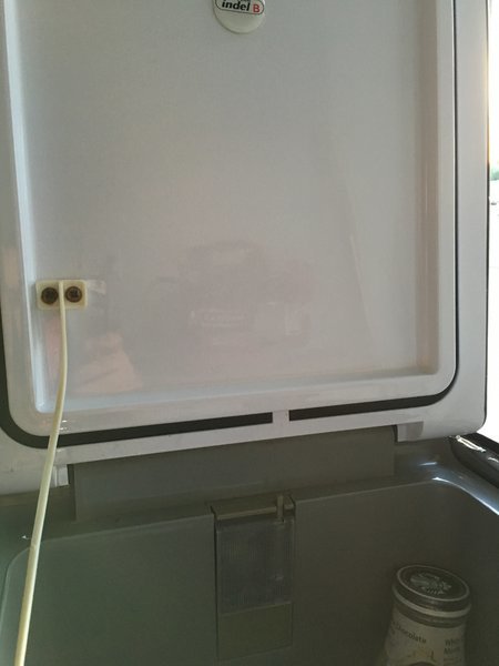

    I never put these pics in the build thread and it was slightly hard to find them in the original Indel B group buy thread.
    Parts Used:
    Igloo Hinges
    Igloo Latch
    Smittybilt Transit Bag

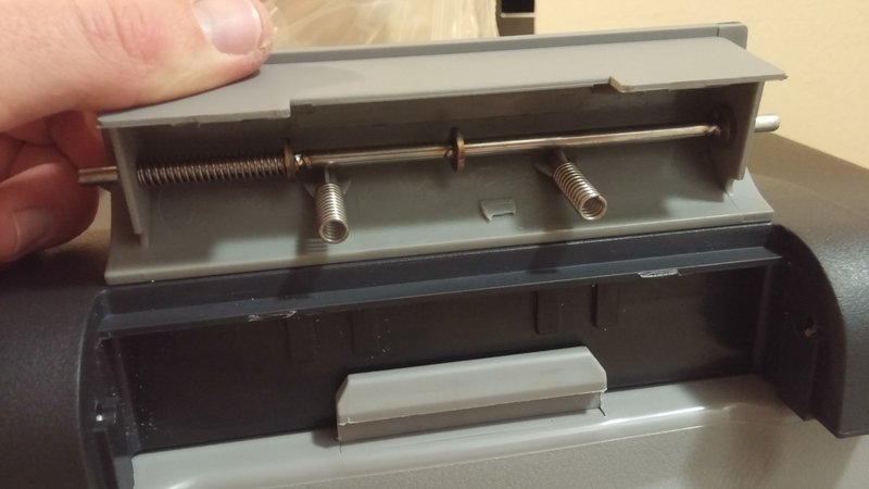

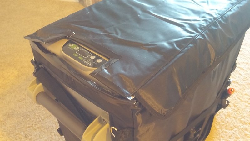

    The Smittybilt Bag fits the 51L perfectly other than the fact that it covers up the display. The vent mesh is in the correct spots. I had to modify mine slightly to work with my different setup. I just cut it as needed, and taped the edges with black gorilla tape. Works great and has held up for at least a year.
    The fridge is mounted on a platform where the rear drivers side seat used to be. The way the lid opened up wasn't going to work for me since it would not open fully, and you would have to hold it with one hand, or your head while digging in the fridge.
    I took off the latch, the hinge is just two spring loaded pins that you push in from one side at a time through the small holes.
    I installed some cooler hinges and a latch, and voila, it opens correctly! And seals as good as new. It has been setup this way since before I turned it on after the 24 hour wait after shipping.
    I used the screws provided with the latch/hinges and pre-drilled before installing the screws. (Dont recall what size off the top of my head)

    Where did you find those latches and hinges? Those are pretty sweet.

    Just added them to the top of that post.

    Just added the hinges and latch to my Amazon cart. I'm keeping my fridge behind the driver seat, so this mod needs to happen at some point. Nice work!

    Thanks. Works well and I have not had any issue. Just make sure you get the hinge screws tight, but not over tighten them! I have not had to adjust them at all since I put them in. Cant remember if I put RTV on the threads or not. I meant to but not sure if I did.

    Did the screws you used come with the hinges and latch?

    Yes sir.
    I did pre-drill them just to make them go in a little easier.

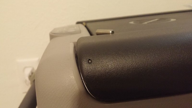

    Mine has no tiny holes in the front to access the front latch release and the back hinge (near the read out) looks impossible to remove. Great mod by the way!
    Thanks. Any help is appreciated.

    Interesting. There's no dimples at all in the side of the lid?
