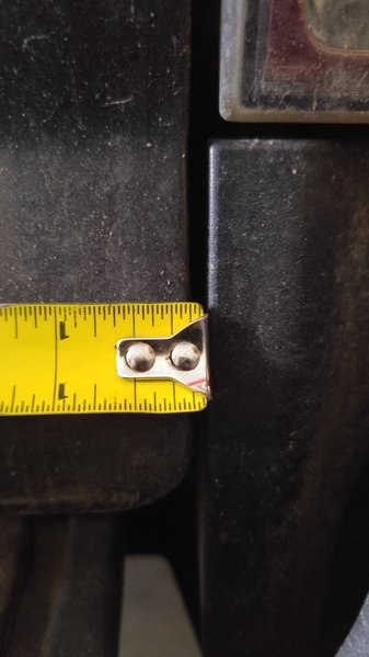

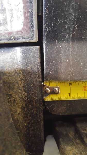

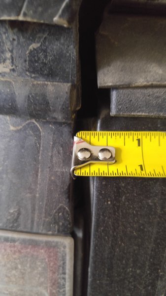

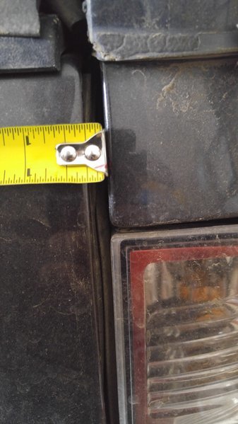

    So... Some pictures of what happens when you use your truck like a truck and put a topper on it.
    I installed the topper the day after i got the truck. It's never really had weight on it until recently other than the topper.
    Bottom of tailgate passenger side
    Top of tailgate passenger side
    Bottom of tailgate driver side
    Top of tailgate driver side :eek:

    Nope. I was totally caught off guard that there weren't any. I have the parts all ready to go too. *stuck
  3. Apr 15, 2017 at 8:16 PM
    #263
    MTNHABITOVERLAND
    MTNHABITOVERLAND Well-Known Member
    Feb 4, 2016
    #231542
    1,590
    2016 Tacoma Camper Build Instagram: @mountainhabit
    Vagabond Outdoors Camper
    Bay Area Metal Fab bed stabilizers!!!

    I'll be picking some bed stiffeners up from Toytec when I get a chance.

    Strange. Three must be some way. I think the latch up front you can get to it from under. But the hinge was the one that at least mine had those pin holes.

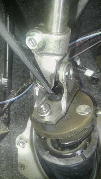

    Truck is feeling a bit tighter in the steering department with the changes that were made. ECGS diff bushing will hopefully tighten up the front a lot more since there is a lot of CV play. Feeling some vibes out back now that the front is calming down but happy with the progress so far.

    ECGS Bushing for the drivers side is on its way and will hopefully tighten it up and take away some vibration. I never had any noise or was able to make it stop in 4wd... but maybe its just too worn?
    Steering shaft play
    The zip tie mod.. cramming it in the extra dead space to make it tight (its been this loose since brand new off the lot).
    Much better, steering wheel feels much better as well.

    I forget who exactly mentioned it (CO BS Thread) but just driving truck off-road with any weight on bed sides will contribute to this "movement". Might want to also box in your rear frame, Jake just did that and posted pics.
    Probably why we should all be buying pre-1970's Oil Embargo built 4x4's where they actually built them tough enough for all this shit... :deadhorse:

    Bed stiffeners were picked up from Toytec the other day. I've got my air chuck mounted through the bed panel where the driver side goes, and the passenger has a switch bracket using the same bolt at the top. So I'll have to take a little extra time to mount them since I'll need to mod that stuff as well.
