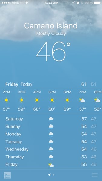

    Not sure when you are planning on leaving but the general rule in the PNW is that "summer" doesn't really start until after July 1st for the really nice, mostly rain free days.
    I know it's still April, but as you can see the forecast for upcoming week is rain almost every day. This will often continue into May and at least part of June.

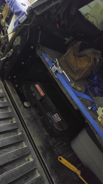

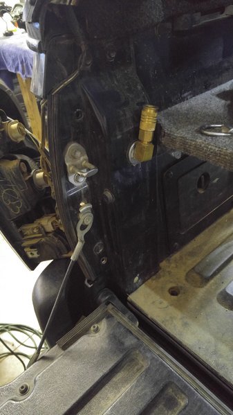

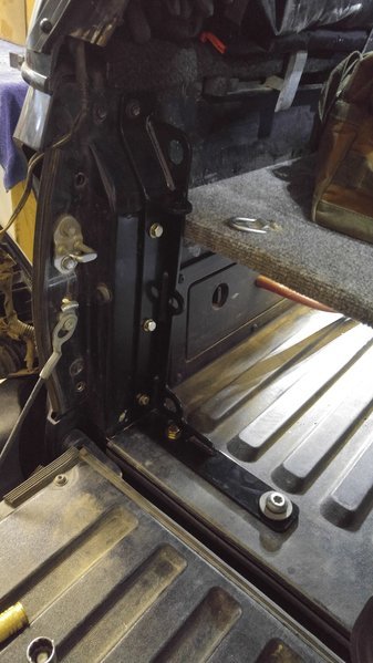

    Got around to installing the Total Chaos bed stiffeners I got from Toytec. I started to install them the other night only to realize that the air line quick connect was in the way of the drivers side, and the passenger side bracket I made for my light/water switch was using the top bolts.
    http://toyteclifts.3dcartstores.com...acoma-Rear-Channel-Bed-Stiffeners_p_1665.html
    Why'd I put this silly thing right where the stiffener goes!
    There's room to put it to the rear..
    The good news is they are on. Bad news is they didn't help the already bent bed. I ratcheted the bed together while i tightened them and still have the gap. But at least there are the tabs on there that i can ratchet them together, maybe if i keep it on there for a while it'll flex back.
    So, learn from my mistake. Put them on before there is a gap!
    But... they look like they'll be a GREAT spot to either weld or bolt another idea to...
