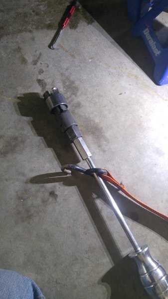

    While trying to chase down the front end vibration that was deemed "just the way it should be" by the Toyota service manager when the truck had under 100 miles on it, I decided to give the ECGS front diff bushing a try. I didnt notice any noise or the vibration going away in 4wd, but since its a known problem and not too expensive, I figured I would give it a try.
    The truck came apart somewhat easy, got the CV popped out of the diff relatively quickly and then saw this:
    The CV axle has never been out of the truck as far as I know. Only time that its had any service was when they had to do the rear main at 25k... but I doubt that. But the roller bushing SHOULD be flush with the face that is closest to the camera... it was a good 3/8" past where it should be sitting.
    So what... well, the tool to remove the roller bearing has to sit in the space that is left on the other side of the bearing when its installed properly, there was no space for that on mine. Thankfully @iRideMTB brought along a blind hole bearing puller. The issue then was the fact that there was not enough space to get a pull on the slide hammer. After about 2 hours of working on it, rigging a ratchet strap to the far side of the weight and being able to get a good pull, it started coming out!
    Before that was attempted, I tried to ratchet strap the puller to the ATV and tighten that hoping it would pull it, but that didnt work.
    In all, it took 8'ish hours to get two trucks done. His truck gave us plenty of grief on the CV that did not want to come out.
    If we would not have had issues forcing us to remove the CV from the knuckle, the job is totally doable without removing it and you can just swing the knuckle out of the way.
    He said that his truck rides MUCH better, and I am hoping mine feels the same when I drive it tomorrow. Heres to hoping! :cheers:
    When I drained the fluid to change it, the bottom plug had quite a bit of fine magnetic dust. I am guessing from the original bearing being pushed in too far and rubbing on the innards of the diff that are moving.

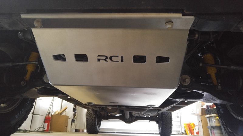

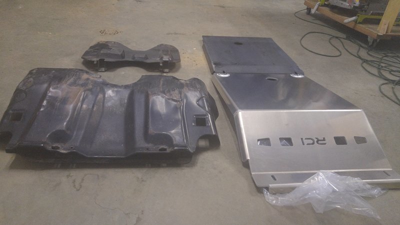

    Upgrading the armor for the road!
    Not sure if I'll paint it black or just throw clear over it.

  12. Apr 27, 2017 at 8:36 PM
    #312
    mountainmonkey
    mountainmonkey Well-Known Member
    Mar 30, 2014
    #126570
    3,993
    Colorado
    '13 Double Cab TRDOR DCSB
    Never enough
    Aluminum or steel?

    Stig
    Stig [OP] Resident smartass
    Feb 22, 2015
    #149340
    13,182
    Brandon
    Ta no mo
    Went with aluminum for the front and steel on the mid. The extra cost didn't seem worth it on the mid since I thought the mid was a lot smaller than it actually is. They both weigh about the same (aluminum front vs steel mid). I was thinking about doing the front three in steel but I decided it'd be better to spend that money to get the exhaust relocated.
    I dont plan on rock crawling and just figured it would be a good idea to add a bit of armor. The stock ones have worked thus far, and most of that was slow high rated trails that I dont plan on doing again. But, being out in BFE, a larger safety factor is worth it.

    Productive (aka expensive) day today.
    Swapped the 265/75/16 Duratracs for 235/85/16 ko2's.
    Haven't tested them other than driving home but they do feel smoother!
    And time to install the skids!

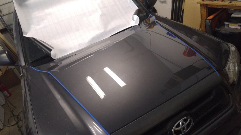

    Not sure if the solar panel is going to go on the hood after all... But i bought the wrap so let's give it a whirl.

    I was going to say clear. Looks good!
    Heat is your friend.

    Washed, clayed that area, cleaned with alcohol, cut lines are taped.. time to dive in head first!
    I have an old hair dryer that usually works well. Let's hope it stays alive for the job.

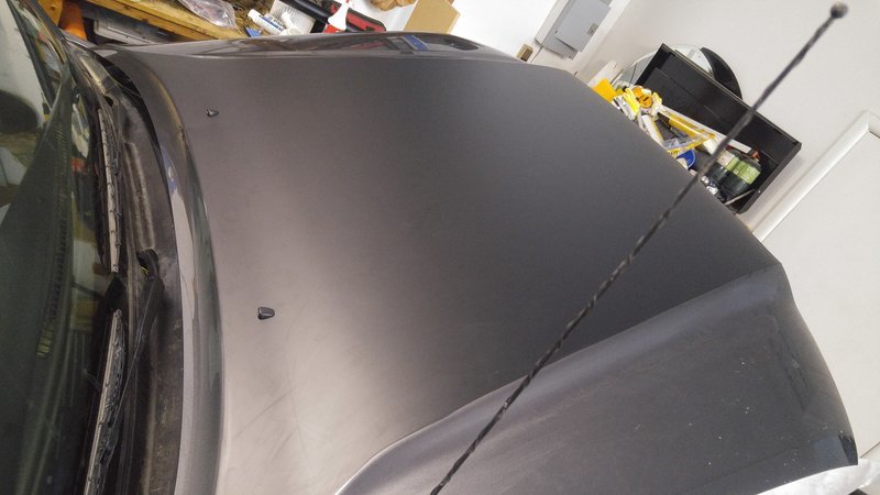

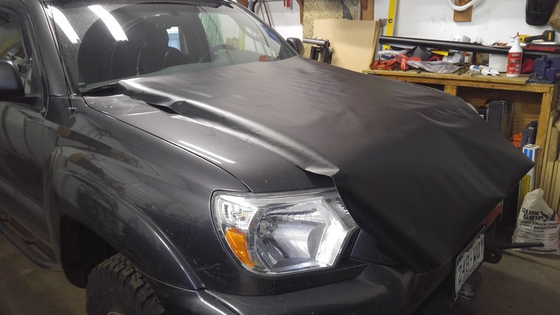

    Overall it was just a minor pain in the ass...
    Cut off the section that turns down by the windshield since it would not stop the little veins creeping back up no matter what i did.
    Now wondering what to glue the front part by the hood down with. Wrapped it to the underside but it's not wanting to stick at all.

    Does it stick to the front edge? If yes just cut it there and don't it under.
