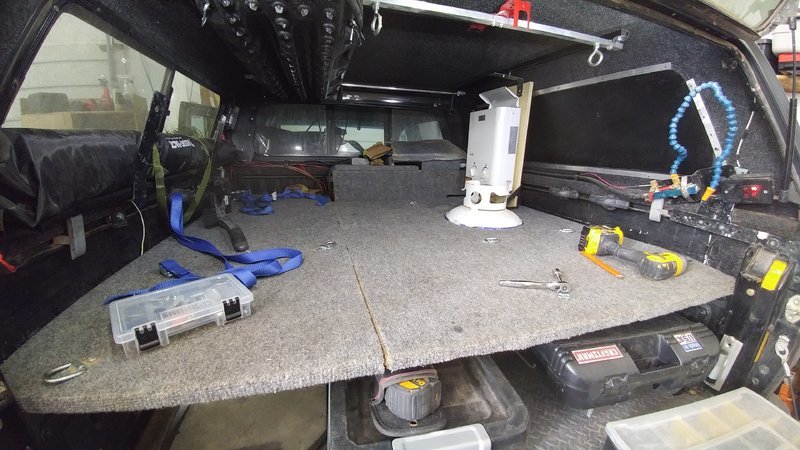

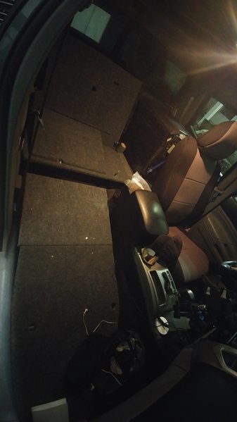

    Ran out of carpet, and bolts but those will be snagged later from HD.
    Front two panels are secured via the stock seat mounts/bolts.
    Storage for most of the tools should fit under where the front seat used to be.
    Lunch time then I'll start to tackle the gas tank/water heater and associated fun stuff.

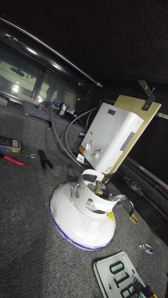

    Water heater secured.

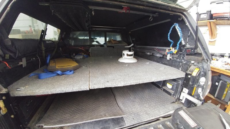

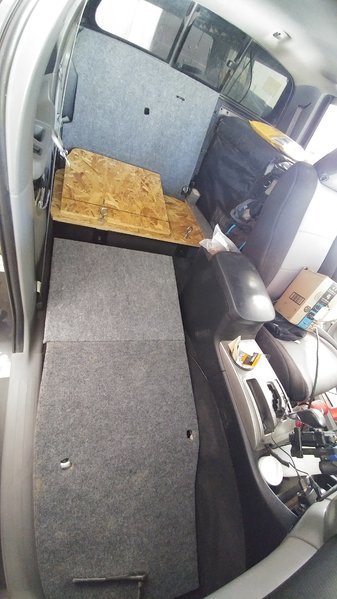

    Interior... Mostly finished.
    Need some latches, maybe build a little storage shelf or something.
    Gas/water... Getting closer.

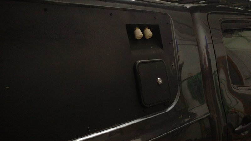

    These are the input/output for the water heater. Connect hose and drop in a bucket or river, the other side spits out hot water for the shower. They didn't have the smallest size of chair feet cover things in black...dont like the white ones.
    I think i have all of the fittings i need to plumb it up tomorrow as well as mount and wire the pump.
    Also need to relocate my potable water spigot to the top of the roof to get it out of the way.

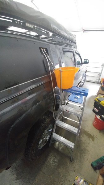

    It works.
    The pump doesn't seem to have enough to pull the water from the ground level.
    So new pump or just carabineer the bucket to the roof rack when in use. Either will work.
    Could be the water line i have, if i find a larger id hose it may work.

    Which pump did you go with?

    Smaller id should raise the pressure and be easier to pump
