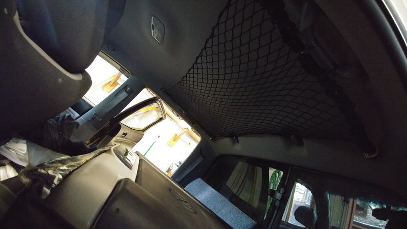

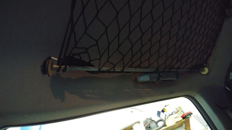

    Next up was additional storage for lightweight items. I think I'll be running out of space in the truck so I need to be creative to store items. This'll work great for hats, the bug netting and other lightweight items.
    Items used:
    Bell Cargo Net
    Tent poles
    Zip ties
    I first wrapped the two rear grab handles with a rubber material I have so that the zip ties dont eat away at the plastic. When I get a chance, I'll add some screw clamps. I had tent poles that were the perfect width of the cargo net. I used the knobs that came with the net and screwed them into the ends of the poles. I wove the poles through the last part of the net and secured them to the knobs. Then zip tied the poles to the grab handles. On the drivers side, I rolled it up until it was tight enough and secured it. I drilled holes in the rear things on the roof panel so I could zip tie the back of the net. I put a few hats up there and it seems to work well, if I want to add tension I can just cut the zip ties and roll it up more or I can loop the ends around the knob to tighten up the main bungees.
    The tent poles at the angle are perfect since they rest on the headliner so it doesn't swing around at all.
    I bought a second one that I am planning on using in the topper. The Maxtrax mounts are almost made to move them to the roof rack.

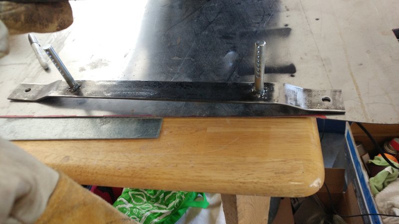

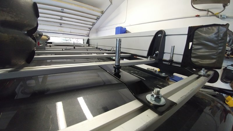

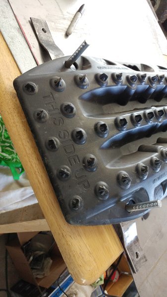

    Diy mounts to put them on the roof rack. :bananadance:
    Pins when in use, add cable lock when not.

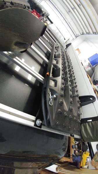

    Rear mounts
    Fin!
    The gap between the two at the rear is due to my 90% board that has one end snapped off. :D

    These are actual max trax?

    Yes sir.
    The corner broke off when they were used in snow...there was a rock underneath the snow that it apparently sat on at a weird angle or something. The rest of the end broke off at some point since it was already cracked. Which is why I have 2.9... they sent me a replacement.

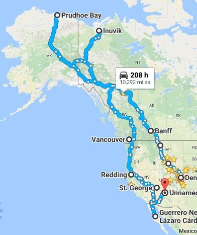

    LOL at my hometown showing up as one of the random cities on that route :)
    Looks like a blast!

    Haha! No, I'm from St. George. Lots of amazing stuff within striking distance there.
    Brandon, when you hit Zion, grab a burger and a beer at Oscar's in Springdale. Haven't been there in awhile, but it was my default post-hike meal after Zion.
