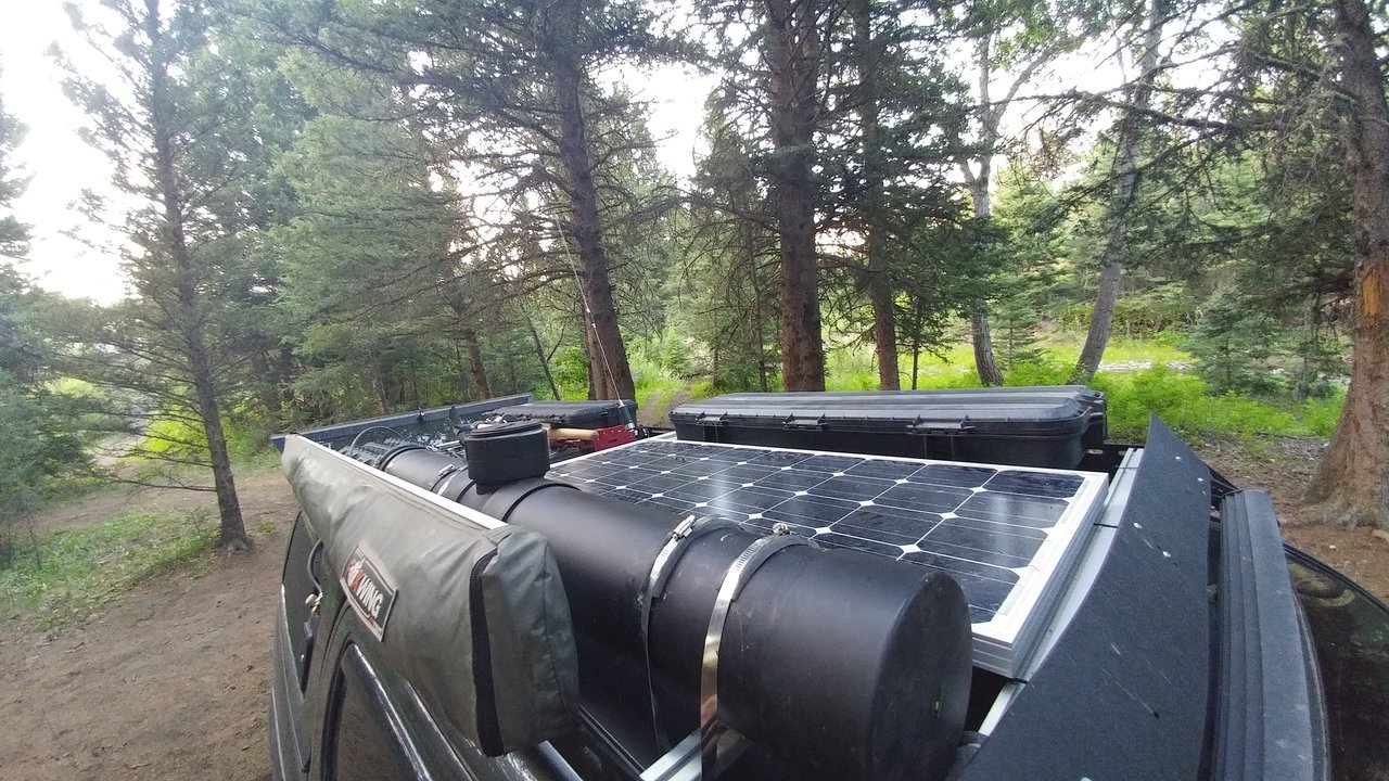

    And i got around to building more capacity for on board water.. a dedicated tank for the shower.
    I learned that Montana doesn't use the black ABS, so i had to use pvc and paint it. They only stocked 4 and 6"... I wanted 5. So i ended up with 6".
    Total capacity is over 7 gallons, it'll heat it up enough for me, i don't like saunas anyways. The water heater i had works great, just didn't work great for my use (trying to conserve water and turn it on and off).
    I'll use this only for showers but also can pull from the other tank if needed. I plan to leave the hose on there all the time, water goes i inside through a filter then the pump, then out to the shower head.
    If i was building from scratch i probably would've just pressurized the pvc instead of the pump, but since it's already here might as well use it.
    It'll also hopefully help a little with the taco lean.

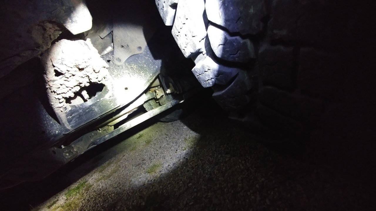

    With a precise amount of backroad dust, black gorilla tape blends in beautifully with MGM paint.
    I'll blame this on @Squeaky Penguin since i was following him when it happened. :rofl:
    The tab is broken from the fender so it wasn't sitting flush. I didn't want it catching another branch or the wind and ripping off further.
