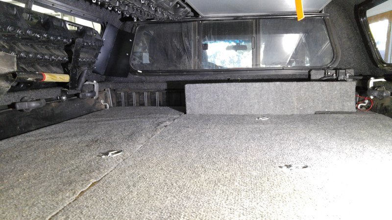

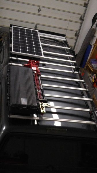

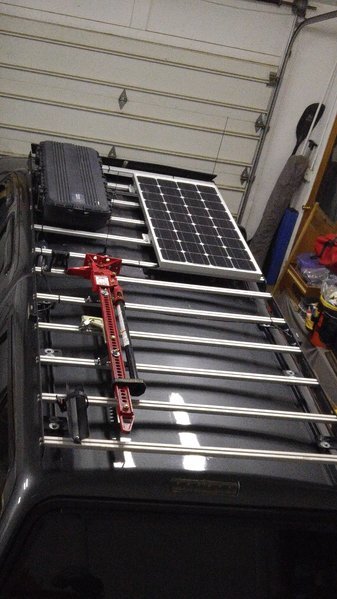

    I guess I should post updates in here once in a while.
    I've wanted to clear off one side of the rack for carrying misc stuff. Got it a bit more organized last night.
    And after
    It all started with me thinking I'd need to make new hi lift mounts to put the jack on the side of the rack, but it fit nicely with the box.
    Next roof rack changes i want to see are two pegs with quick release for storing the maxtrax while on the trail for easy access instead of having to put them back inside the truck. It shouldn't be too hard to build a mount, just need to decide where.
    I ordered new blank rotors and pads, I'll be swapping those out this weekend.
    And the ole heifer might even get a real complete paint makeover... Maybe. I need to remember to grab a clay bar, i think i have everything else.

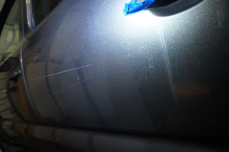

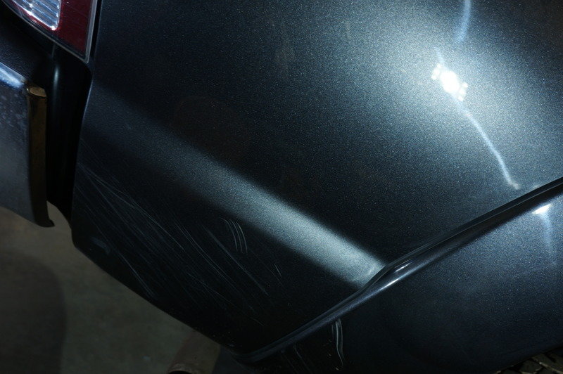

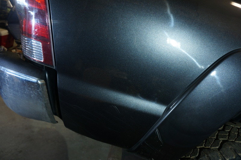

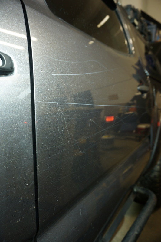

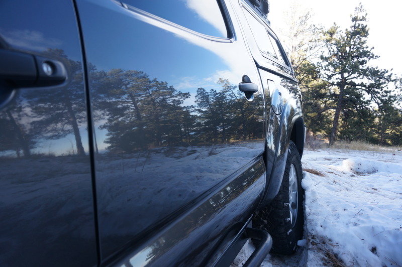

    On Christmas Eve, I decided to reward the truck with a car wash. Unfortunately I saw it the next morning... and cleaning off the dirt/dust revealed the sad state of the paint from tree pin stripes. Being that it was going to be nice this weekend... I figured it was time to do something about the paint.
    I used mostly Meguiars stuff, since thats what I had on hand and hit it with the RA buffer. Used Mothers Clay bar, compound, polish, and wax to get it looking better. The compound didn't take the scratches completely out of the paint, but made it look a lot better. 7 hours of work, and it was looking almost like new!
    Unfortunately, both sides, front to back looked like this. Too many tight trails... In the sun, it looked 10x worse.
    Before and after compounding
    I think this was from exploring an area in Arches... tight squeeze between sandstone. Almost made it.
    After compounding... it currently looks pretty darn good, only the deeper scratches are showing.
    Looking better!
    Also removed the TRD OR stickers from the back.

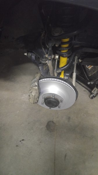

    I also replaced the front rotors and pads using:
    Bosch blank rotors
    Hawk pads
    The original rotors were a pain to get off, had to torque down pretty good on the two screw holes to get them to break off. I cleaned the hub surface and added some anti seize to hopefully not have that issue again. Bedded them in with a few nice stops while on the way to go snow wheeling yesterday.

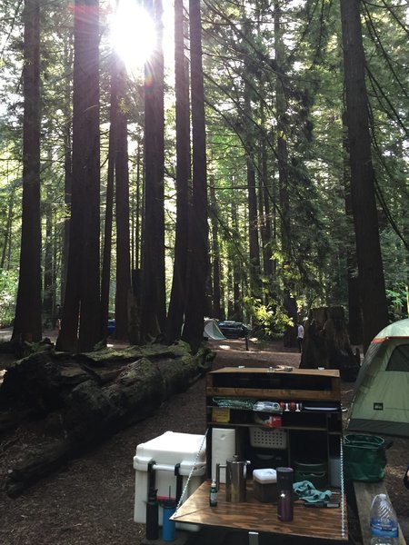

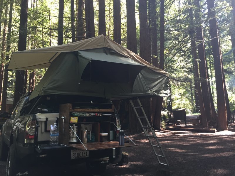

    I definitely recommend building a chuckbox. I put it off for a while and I'm happy it's now built. Just google it and eventually come up with your own design. The boy scouts build these things every year, so you can find a lot of their images on google. It makes life a lot easier. We have everything cooking/kitchen related in this. I just laid everything out on the floor and designed the inner compartments accordingly. I don't have great pics, but two are below. I put a list of everything we can cram into this below also. Now, we load this up, a black rubbermade with grill and random camping bits, and the cooler. Just load and go. You can design it to have removable legs if you want it to be self standing. I didn't care as much for that purpose, but I could always add it later.
    • Top lid opens up with Stove and up to 4 propane bottles; lighters; and little extra things re: creating fire.
    • Next Shelf down holds table cloth, spices, plates, and in the back a small broom/dust pan (you can really take advantage of the depth to store not often used things in the back.
    • Next shelf is garbage bags, zip locks, handywrap, 2 green collapsible wash buckets;
    • left compartment has two lanterns and paper towels;
    • middle compartment is actually two. Both hold baskets that slide in and out and hold dishwashing stuff and utensils; dishtowels; etc. All the little things that need a place to live (beer coozy). When those baskets are slid in, the french press and coffee cups go in front of them.
    • 3rd compartment to the right - holds pots and pans; cutting board; collapsible salad/mixing bowl. When slid back, coffer grounds go in front in the little white sealed Tupperware.
    • Last compartment on the right; holds Tupperware for leftovers which all collapse into one another. Also, can't be seen, but the wife loves her wine, so there is actually a slot right above that where she gets her little plastic wine cups.
    Last tip - use as much 1/4 as possible. These jokers get heavy quick, especially once loaded up. I can handle this entirely by myself, but she's not light.

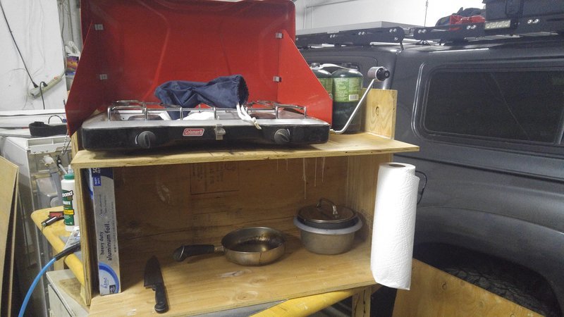

    @Mcdees84 thanks for the inspiration to start the build.
    After getting ready to start the build, i figured i would get the main pieces made out of 7/16" to give it some rigidity. My plan is some shelves underneath, and to have two swinging doors on the front that are also shelves. I may have to mock up one side with 1/4" and see how much it'll hold. I plan to put light items on the doors so it shouldn't be too much of an issue.
    Thankfully size wise I was stuck with that height so i can put it on top of the divider in the back. And i was very happy that a paper towel roll will stand up underneath.
    The build will continue!
